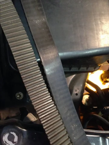

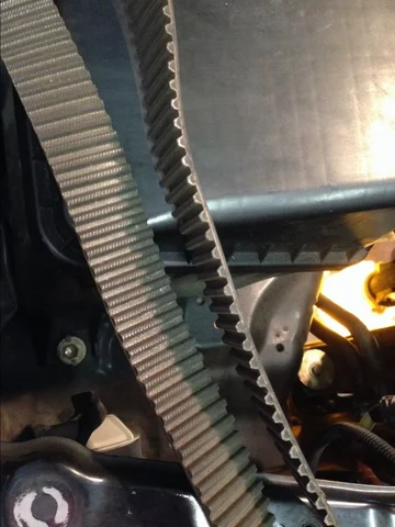

I did finally finish the job, successfully too I am happy to report. New timing belt and water pump are in and working nicely. No leaks for a week (touch wood). I did also replace the front bypass coolant tube, and the inlet assembly. The inlet assembly came with a FIPG already installed in the groove, which was a bonus itself.The front bypass had no corrosion inside, just at the interface of the radiator outlet hose. To do this I had to remove the throttle body, which was kind of cool to see. Good opportunity to clean it thoroughly. I also cleaned my MAF with the MAF sensor cleaner. I also got a great view inside under the air manifold of my starter - which looks spotless. Took an opportunity to vacuum out the valley in the air. Replaced the gasket between the throttle body and manifold. Removing the manifold requires the removal of a fuel rail, and you're supposed to replace the washers that it crimps down into - which I did not do. I also replaced all three cam seals and the radiator hoses.

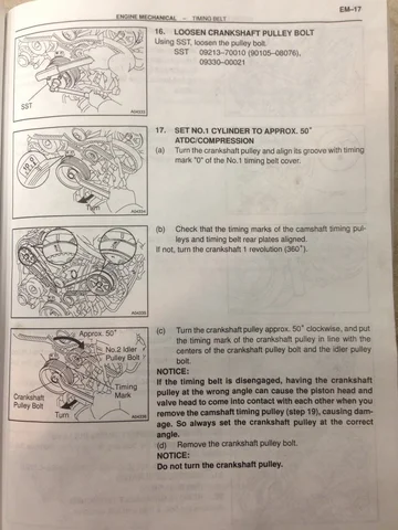

I ran into some difficulty installing the new timing belt at 50 degrees from TDC as the FSM directs. And my rotation test showed that I was off, so I removed it and re-installed the belt at TDC. I think my mistake may have been that I didn't rotate the crank and cams so that the marks on the cams were on the top side next to their TDC marks before advancing to 50 degrees and removing the belt. I couldn't get the cams to sit still at 50 Degs and the belt slipped a tooth a couple of times so once I got the hang of it at TDC, I actually bought another belt, so I had a fresh belt for the final install. I figured after going to all that trouble I might as well spend the extra $50 to get another new belt and be confident my install was solid. [Anyone want a Timing Belt Replacement sticker? :) ]
In between I spent a lot of time thinking and worrying about any damage I may have incurred while rotating the crank and cams, and thinking through the "math" of how many crank rotations per cam etc. I am relieved to report that there is no indication of damage or that the engine is an interference engine, because I am sure if it was I would have had a valve/piston collision.
It was such a relief when I turned the key and the engine started and ran smooth - even up to to high rpms.

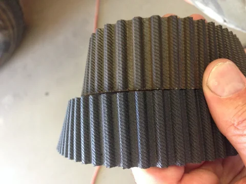

Old and new (bottom) belts.
Old is brown, 104k miles and 13 years old. A lot of brown dust in the timing belt covers.

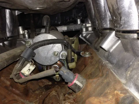

Starter in the belly behind the throttle body.

Also, I posted earlier in the thread (post #7) about the other marks in the engine for alignment of the cams etc. when installing a timing belt. There are now 3 ways to do this.
1. 01 FSM says to advance to 50 degress from TDC and align pulley mark with the line between the crank pulley bolt and the #2 idler.
2. 04 FSM says to do it at TDC
3. the video says to do it at the marks I showed in the post above (the white nub a little beyond TDC, and the "T" on the Cam cover back) - I think its 30 degrees. See post 7.
For my 01 at least, I tried to do it at 50 degrees TDC as FSM directs, and that was not a stable place for the CAMS....and I actually got the belt on wrong. So I redid it at TDC and it was much easier. Thankfully I saw no evidence that this is an interference engine (at least in my 01).
