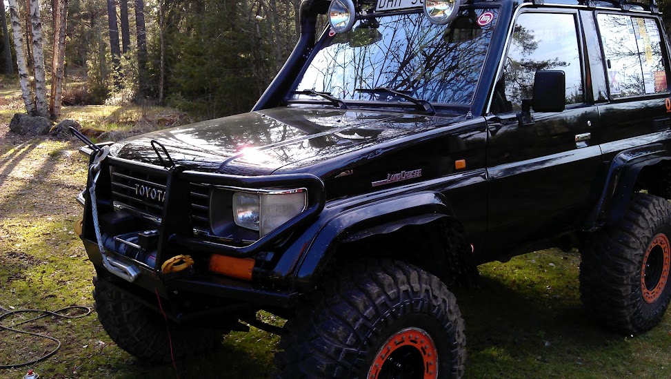

KZJ70 on C303 portal axels
Nice!!!
Looks like you drilled new holes in the axle/portal flanges to change pinion angle, is that correct?
Does it have any suspension lift over standard?
How did you calculate the change in pinion angle, and how much did you rotate the portal boxes with the new holes (how many degrees)?
Did you use the standard radius arms?
Do you have the conversion process written up anywhere, to go along with the photos?
Thanks.
Nice!!!
Thanks.

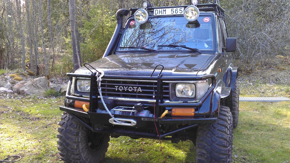

Hi, thanks.
You can find more pictures here,i think i changed to english in this link. Pixbox: kallesamurais fotosida
Built up tread in swedish 4x4sweden.se :: Läser ämne - Den lille svarte
Yes,portal/pinion angle is changed i don´t know how many degrees. I bought a kit with a drill jig.
Lazer cut brackets to the original radius arms whas in the kit to...
All parts is bought from TML finland.
Offroadtarvike - Tietoa yrityksestämme
I used google translate to find them and find out what they do.
Timo answer questions in english if you need something.
I just have 2" OME lift springs and shocks,the car is quite stable on highway to,i have driven over 110km/t with 37" and beadlock rims.

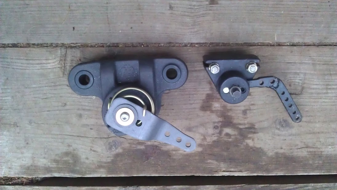

t-case parking brake .? ( can't tell from pic )
Look in to their website and it is parking brake on t-case it looks well done ( must be for about 460 bucks ! ) will put that in my wish list !
Hi could you please tell more about your parking brake.
I bought willwood park brake from Finnish offroad shop and that was piece of sh**. There wasn't enought force on that caliber. I am planing to fit vw golf rear caliber on t-case if I don't find some easier solution.
I have also been thinking line lockers but they are not street legal over here.
Could you give some example about bracking force? My willwood doesn't lock wheel almost any situation. Maybe on snow? :D
I used to have Wilwood/TML from Offroadtarvike before...
[URL="https://lh3.googleusercontent.com/-wfcySQYzFHQ/T3a0srPiwUI/AAAAAAAAA-8/R0taTHgeWyg/s1096/IMAG0147.jpg"][/URL]
You can see the difference in size and construktion.The old one did not work at all,it rattled,get warm and was not effective att all...
The new caliper from X-eng is made for front loaders i think,wilwood looks like it made for go carts?
I can not tell how effective it is but it works excellet so far.
you can se more pictures here https://plus.google.com/u/0/?tab=iX...211405076113890640/albums/5713847707960848049
X-eng also have a pdf instruktion on its website,i hade to grind on bracket for the cable so it get free of frame and i hade to remove heat shield for exhaust and bend its bracket
