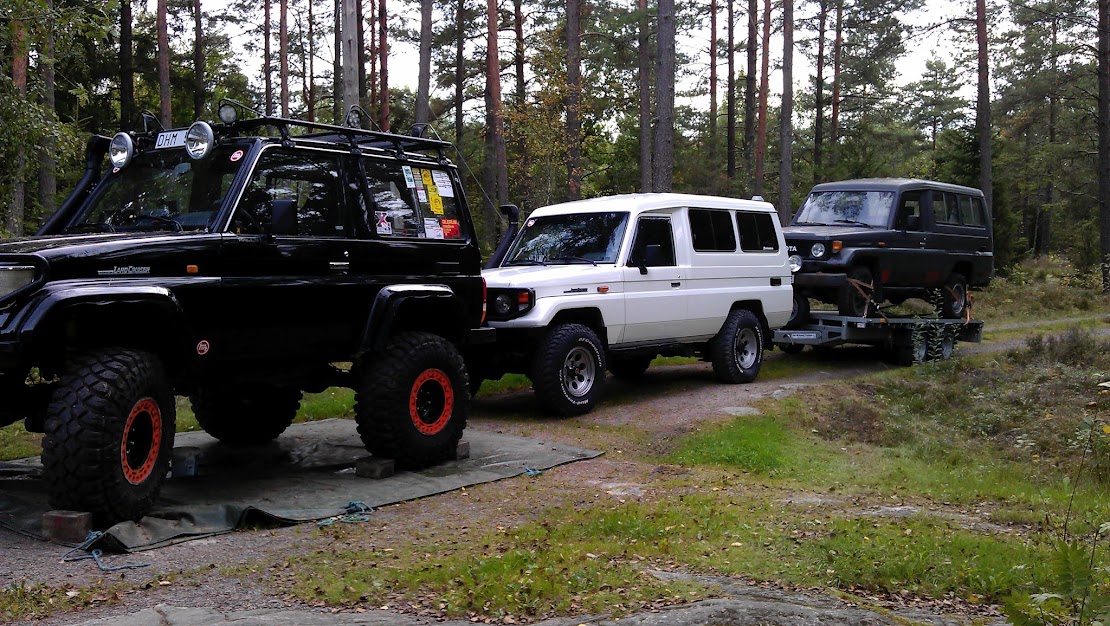

I've been thinking about weighing the car, but I have not done it yet ...
It feels a lot heavier, but now i am used with the portalaxels and i love them.
nice bumper and nice rig . How much extra does it weigh now?
2260kg with me, 50liter in the tank and a lot off road stuff.
It weighs 1970/2510kg original.
I have also started in my first Challenge competition,this sport is not that big here but it was realy fun:steer:
