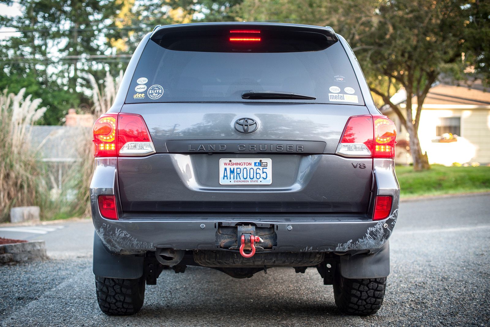

my daughter blacked out the emblems on the 200 today!
Yeah the blacked out is okay (I actually love it), but the rock rash on the corners makes it really pop! (Also love)
Proving like always, you don’t really need to do much to a 200 to go anywhere you want.
Where do I get a TEQ sweater?! Want so much.
