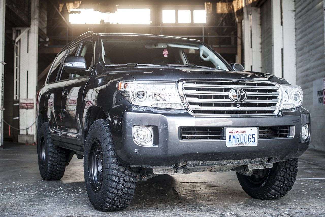

ripped the running boards off and slapped on some 18x9 fuel Anza wheels and 285/70 R18 BFG Mud Terrains... View attachment 1142389
Really nice set up, nice choices! I really like those wheels. Have you had any thoughts to adding a locker or two? I was going to throw a bunch of money and mods at my hundy, but I thought after seeing yours and Romer's URJ200, I'm trading my hundy next year for a 200 and modding it; then I'll hide my 60 and 80 in the trees from my wife:D. Again, those wheels and tires really light up your truck!
thanks for the props man, I am really happy with the build so far! Yep, I'll be adding at least a rear locker, sliders, and a bumper or two after my fall off:)
That is my plan as well; should get you where you need to go 95% of the time. The lockers on my gwagen have actually put me in places at my age (59), where I shouldn't have been, especially when I'm alone.
sounds like you might need a winch on your list also:)
