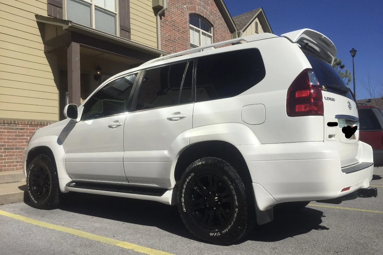

I purchased my 2009 Super White Land Cruiser with Tan Interior in October of 2016. I was driving a Lexus GX470 2007 blizzard pearl with tan interior that I snagged in April of 2016. This vehicle was rated 4 Wheeler of the year two years in a row when it was released. I added some Tacoma TSS lift take off black wheels and BFG tires, tint, LED's and weather tech mats. Never got to lifting the GX due to stumbling into the cruiser and being wary of the airbags; however, it was a very powerful vehicle with great speed and acceleration on a small frame. A great vehicle that I miss from time to time, until I find myself looking back at the LC in my driveway.

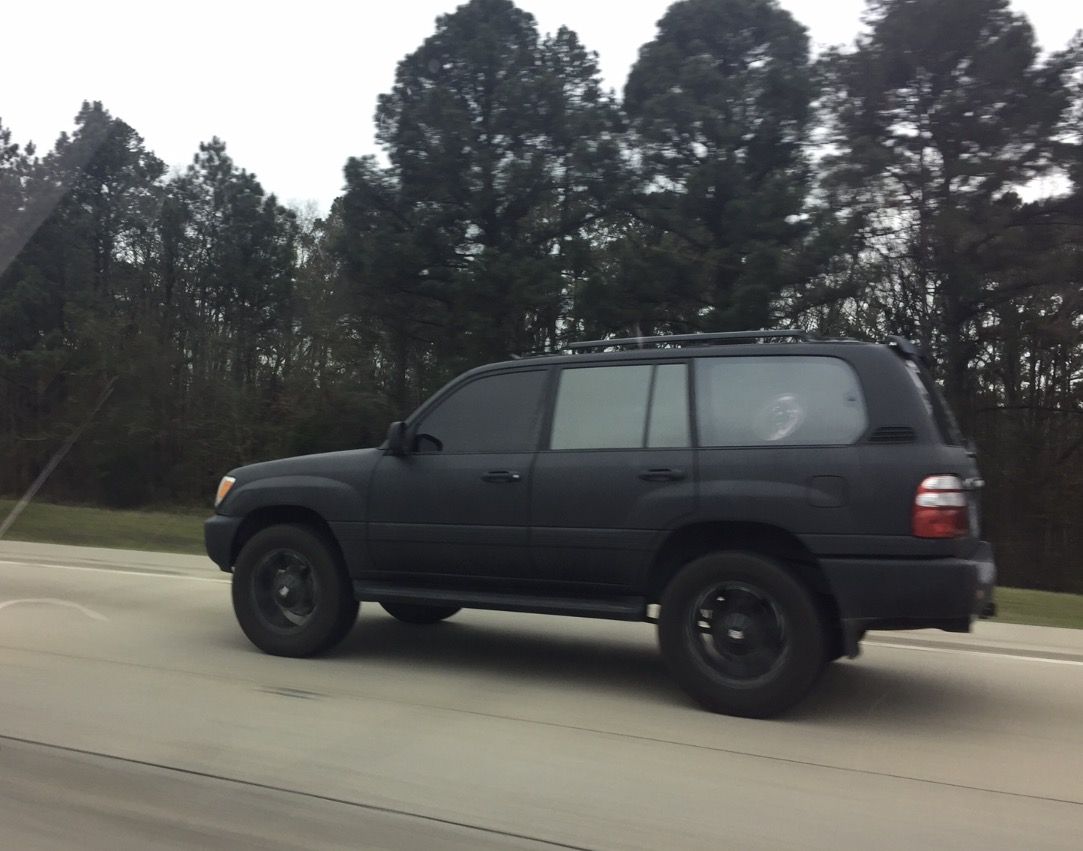

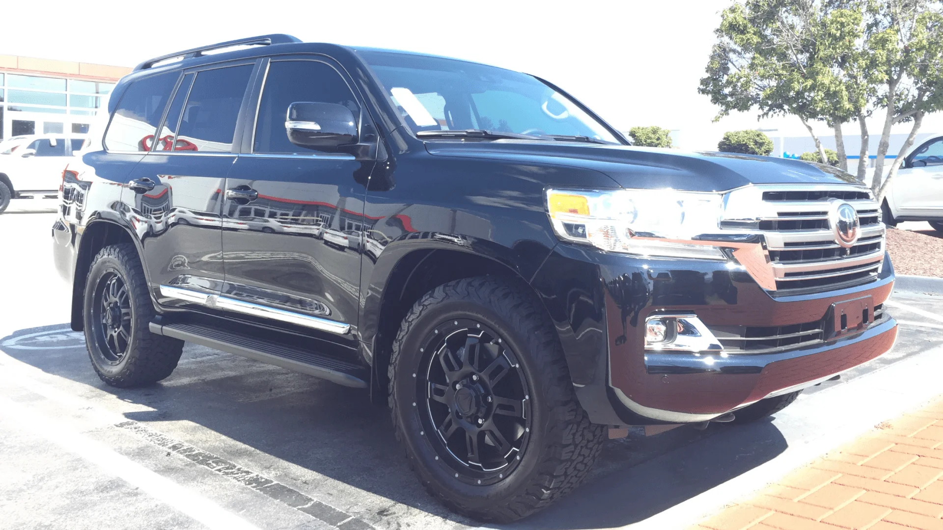

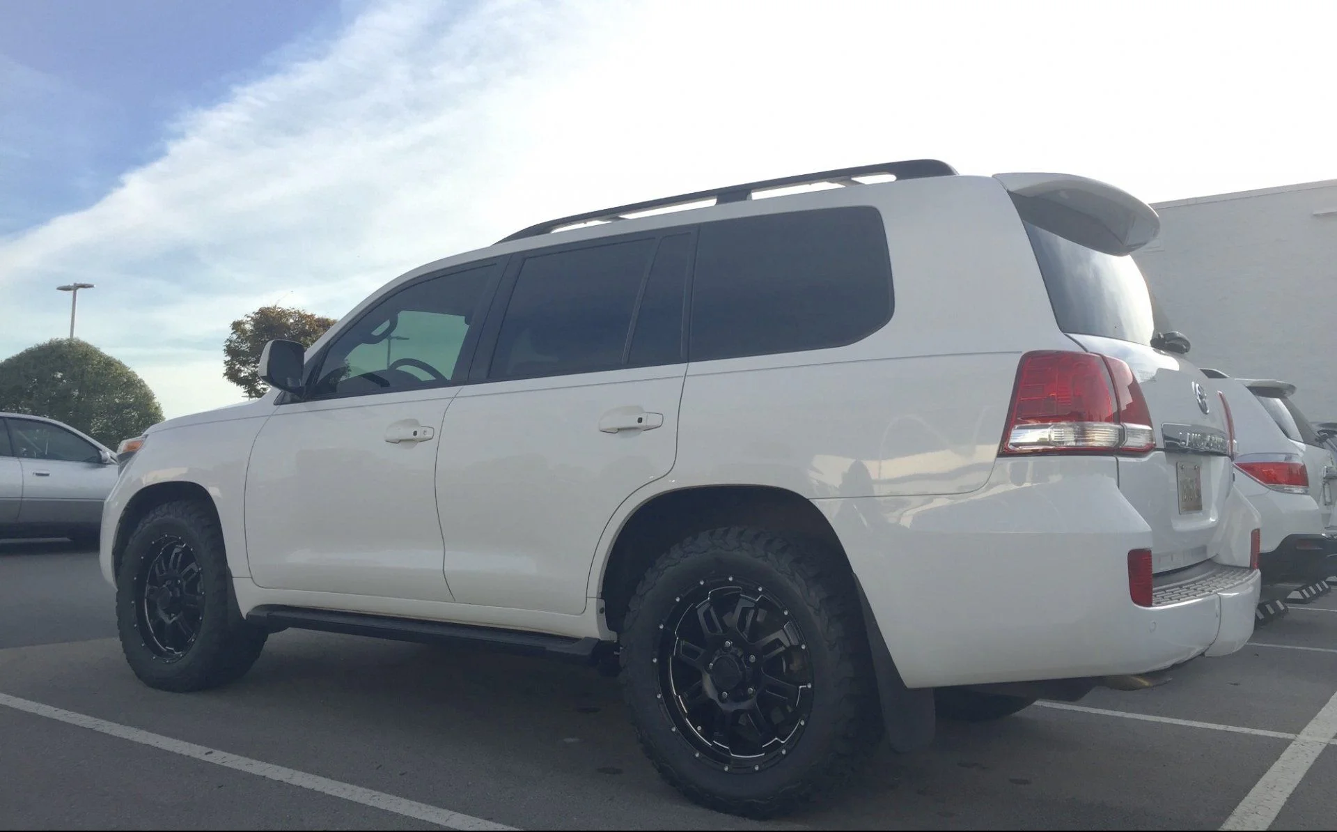

The Land Cruiser came in discretely for service. A gentleman with round rim glasses (Einstein style and curly white hair) steps out. He was asked to purchase a new one, and ended up purchasing a Black Land Cruiser I had added take off lift kit Tundra TSS wheels and BFG tires to. Picture below of both.
His upgrade allowed for me to upgrade (kind of like the Hermit Crab shell shuffle). He purchased the 2009 brand new from my dealership when I was in my senior year of high school and serviced every 5,000 miles in our service drive. It has 110,000 miles, never had anyone or any children ride in the back. The GX had that lived in "funk" that kids seem to manifest in vehicles (and maintain even after steaming and shampooing) lol so I was glad to move to a cleaner ride.

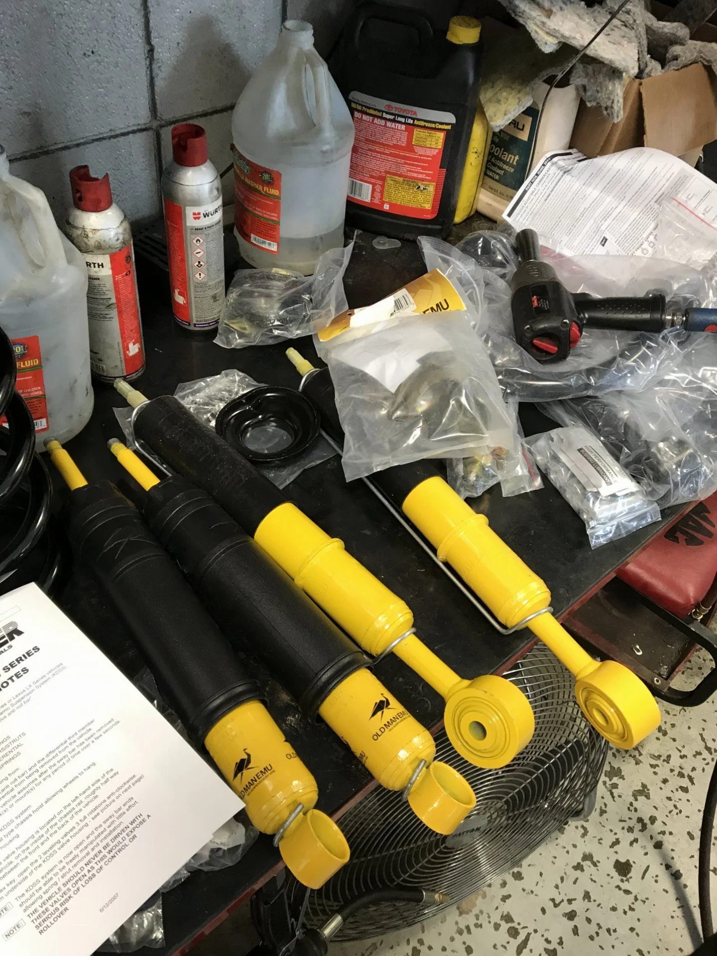

1) 2" Lift Kit - OME w/UCA Stock Load
- Ordered from Slee
- Not planning any bumper armor soon, although Tony P's is very attractive.
- No spacer, Slee didn't recommend it

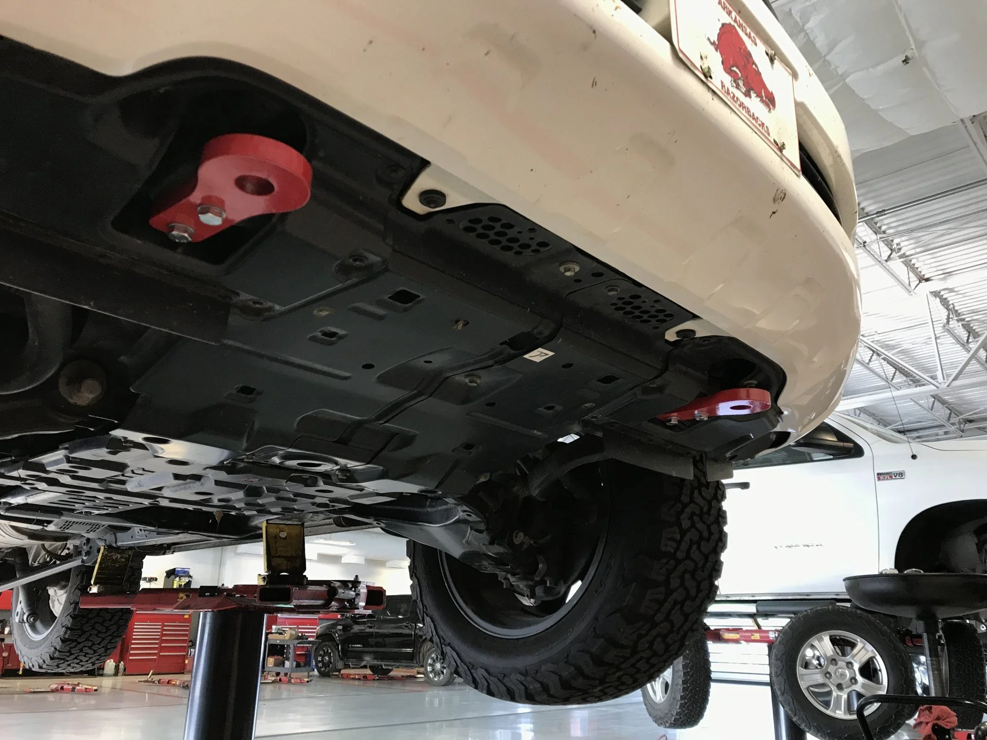

7) Upgrade Recovery Points (Trail Tailor Red Tow Mounts, Skid Plates

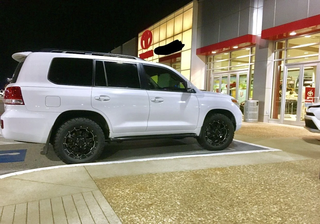

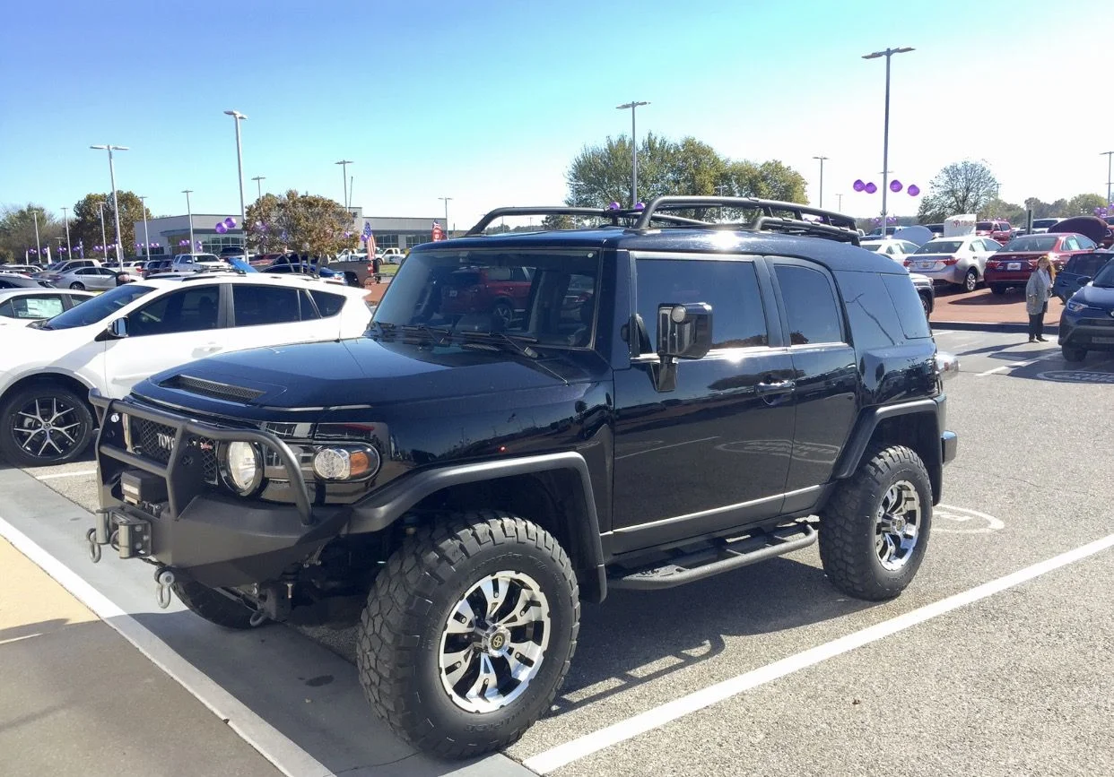

The Black 16 LC is what prompted Mr. Einstein to trade the 09 I purchased. Off to getting new shoes right away! Snagged the wheels and tires from a TSS Tundra we lifted.

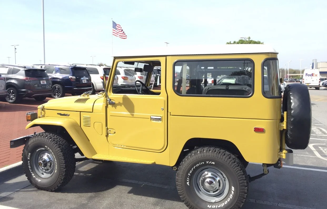

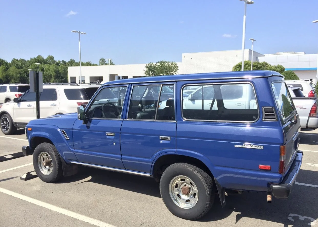

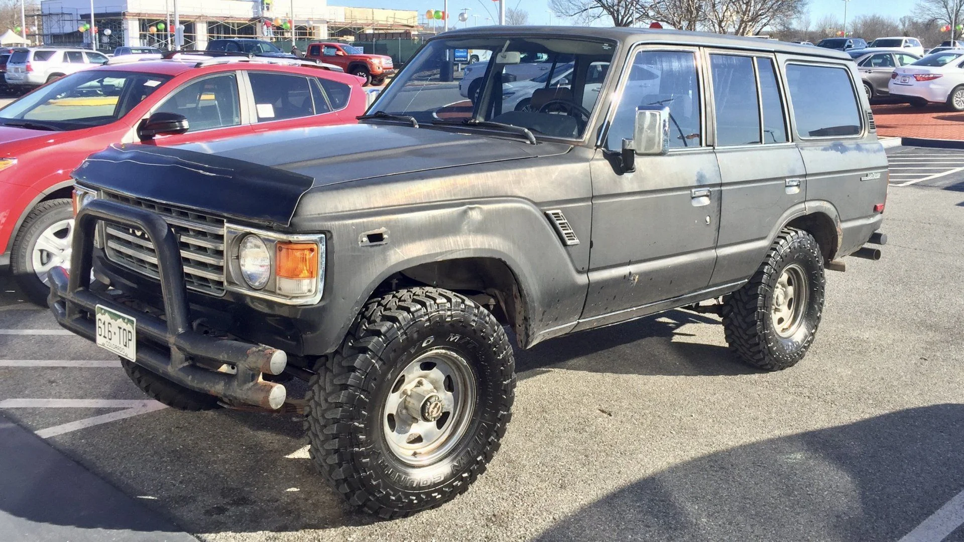

Below you'll see some ballin' older FJ's. The purplish blue one is in immaculate condition.
That's all my random pictures for now. Along with my actual personal vehicle build, I'll post the random customer vehicle.

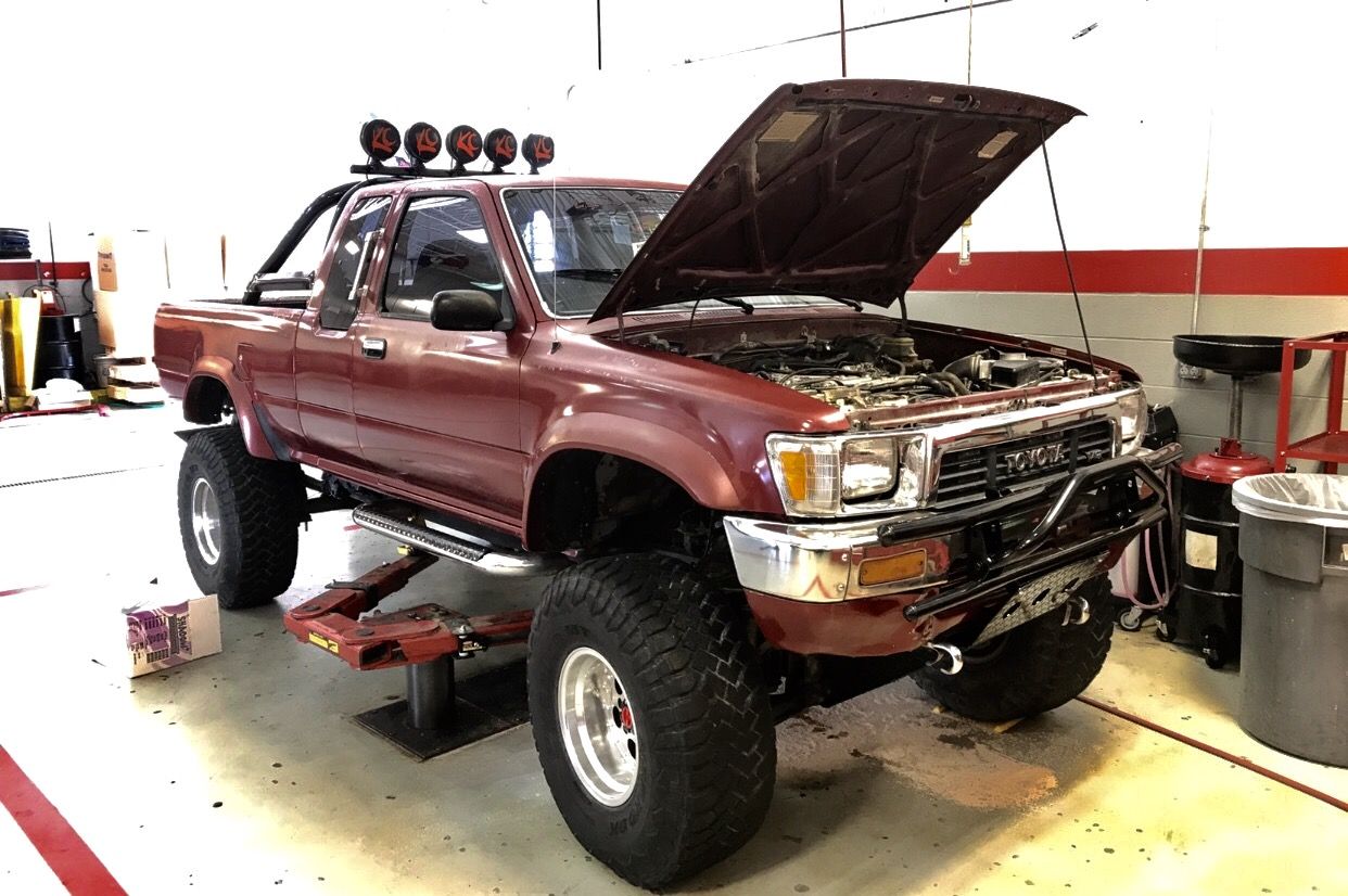

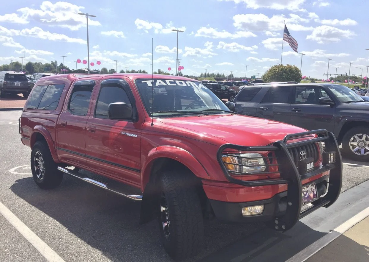

Michael J Fox would be proud of the Red Taco

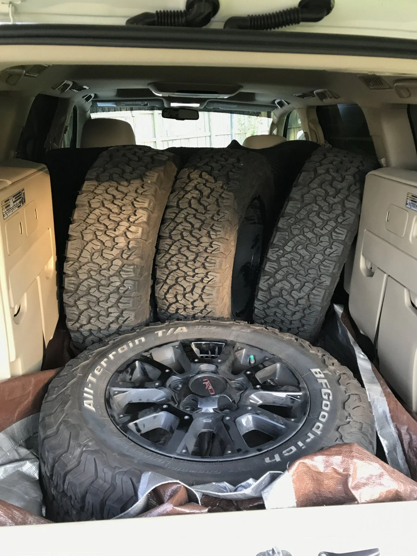

I was close to purchasing the TRD Pro wheels from my dealership at employee cost (which is north of $380 per wheel and over $500 retail for a customer). There were none to be found on Craigslist or eBay for the last month almost. I decided to look randomly Thursday night before heading down to Central Arkansas and surprise, someone just posted a set with BFG tires only used 8,000 miles in Little Rock (which I will not be using since they're a little too small with a lift - PM if interested I'll provide the dimensions).

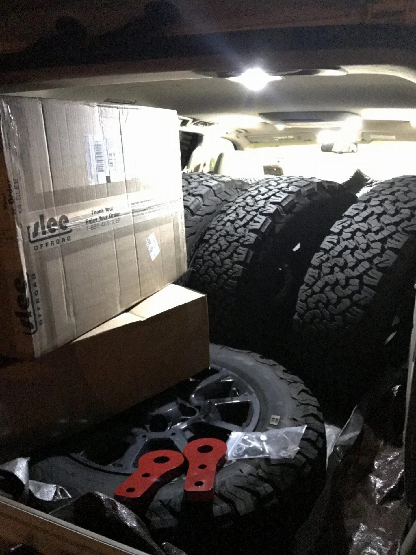

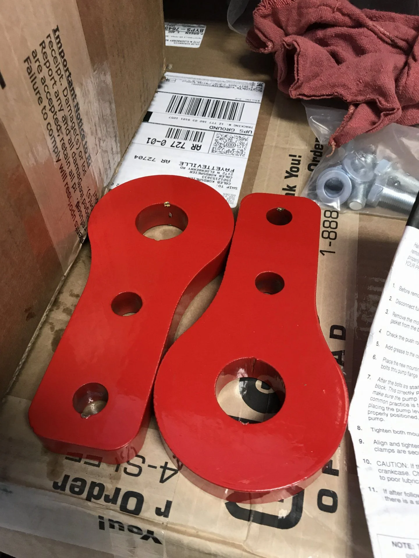

He met me at the Toyota event and I was ready to roll. Got back home 3 hours later and Slee delivered the goodies, along with Trail Tailor's recovery points.
Beyond excited to get to work tomorrow and get everything installed. Tires will be waiting there.

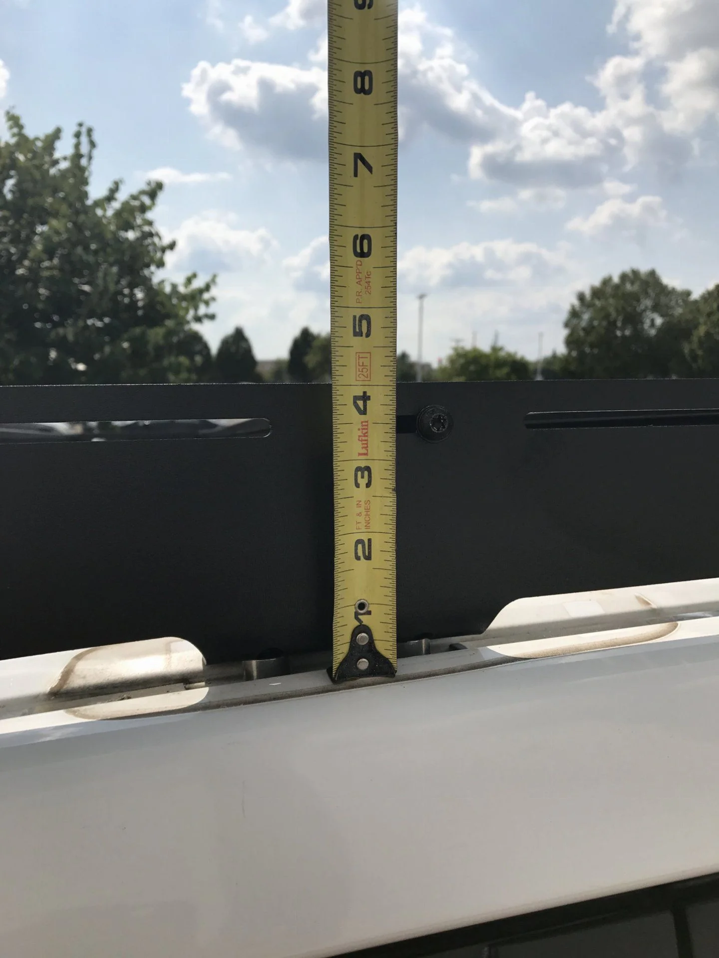

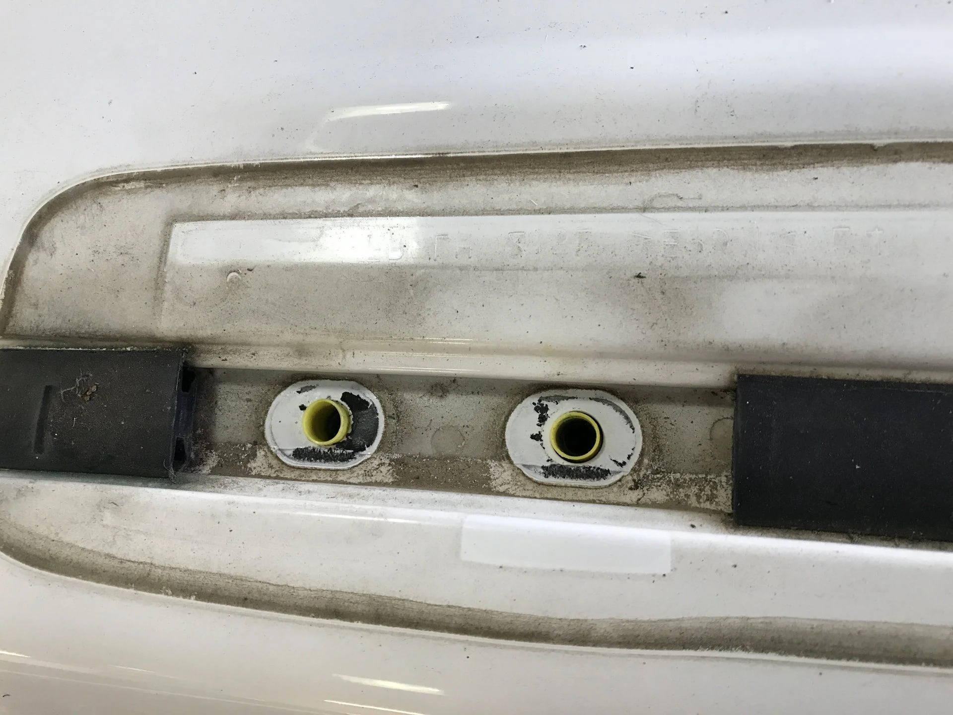

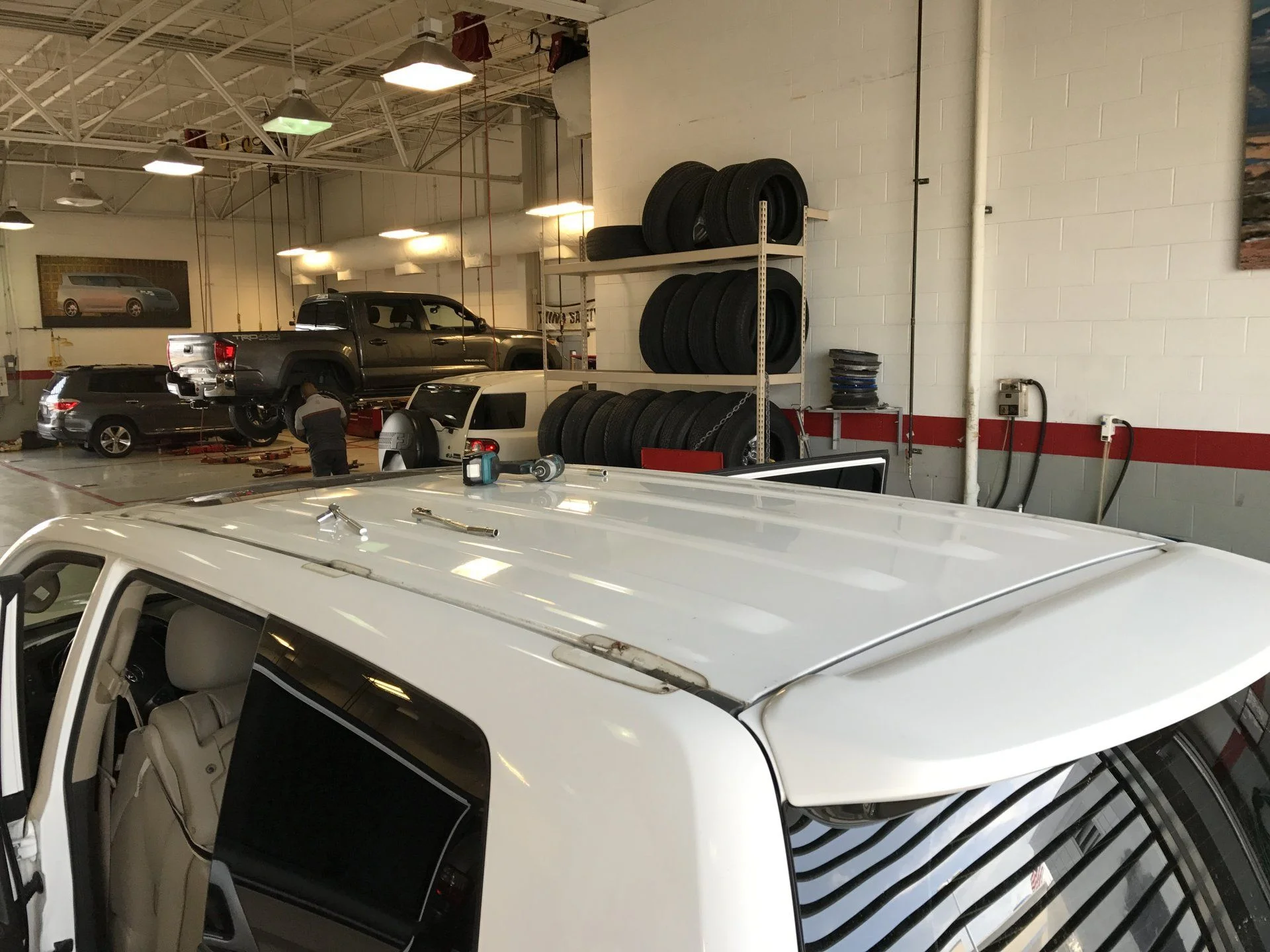

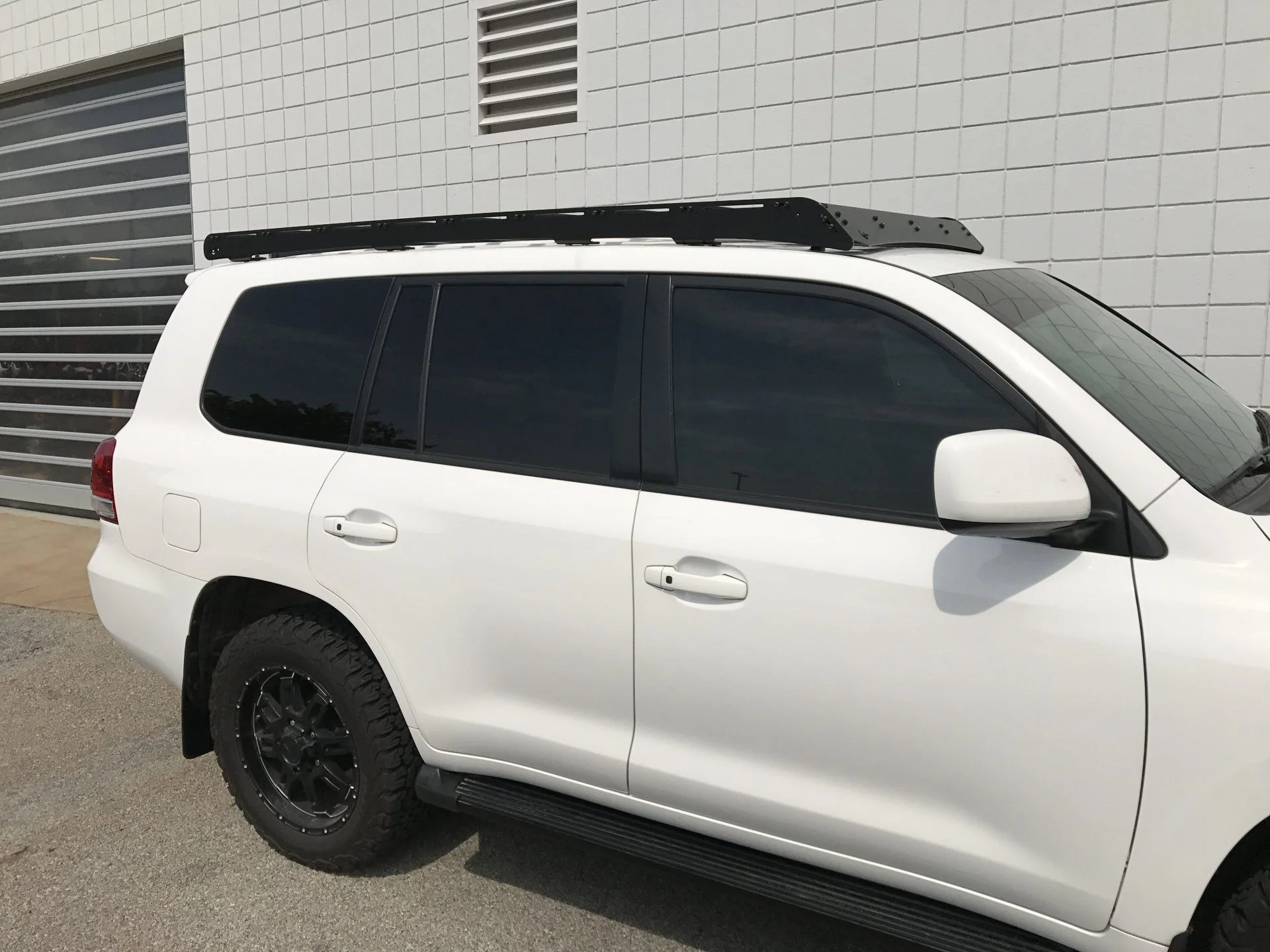

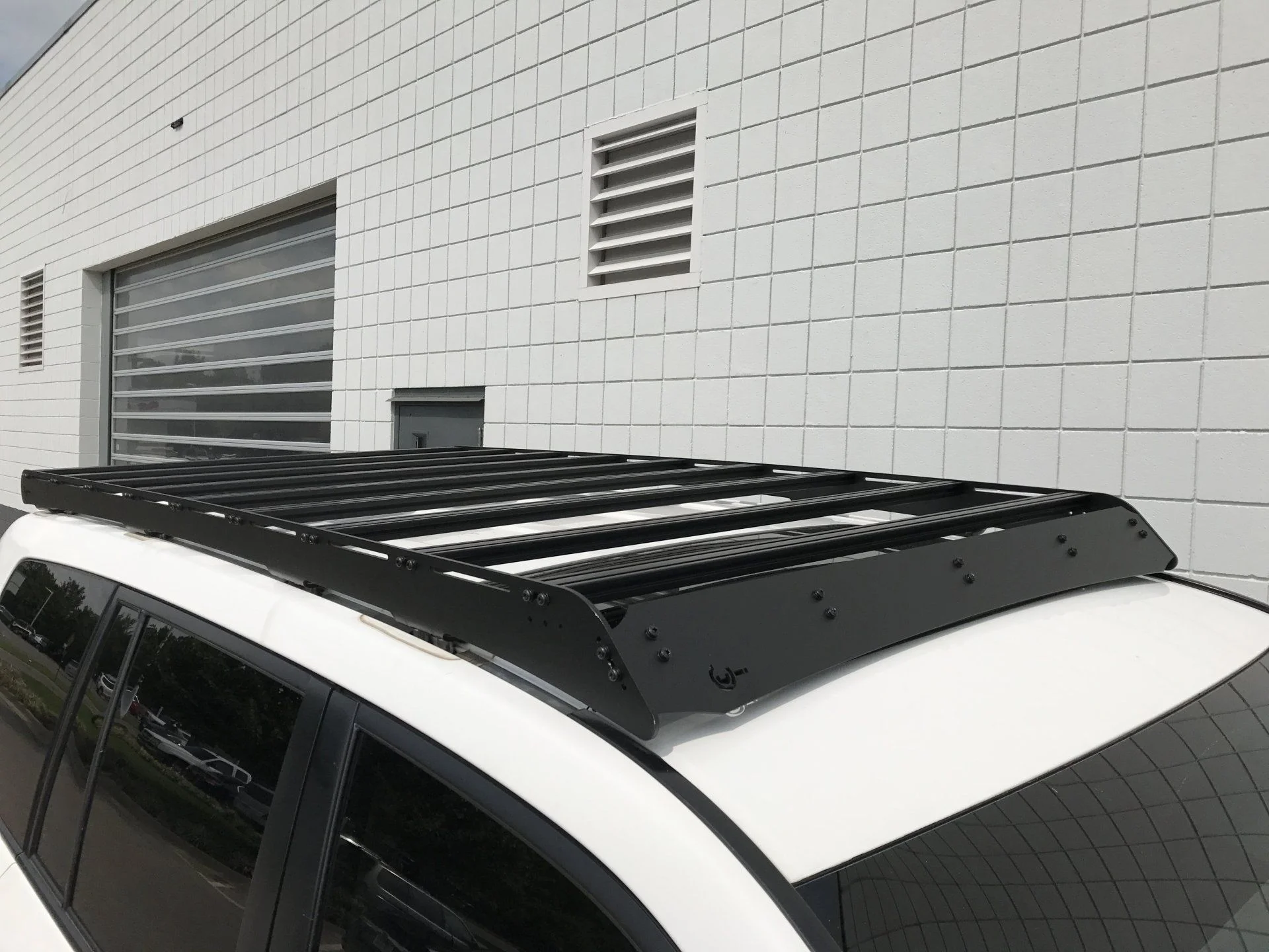

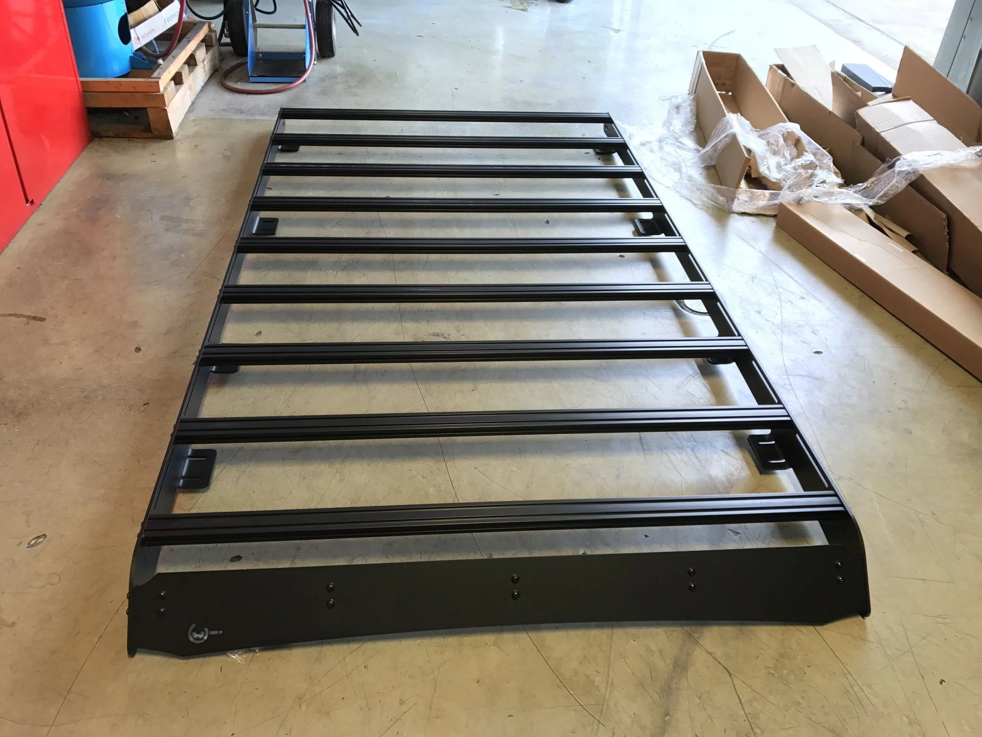

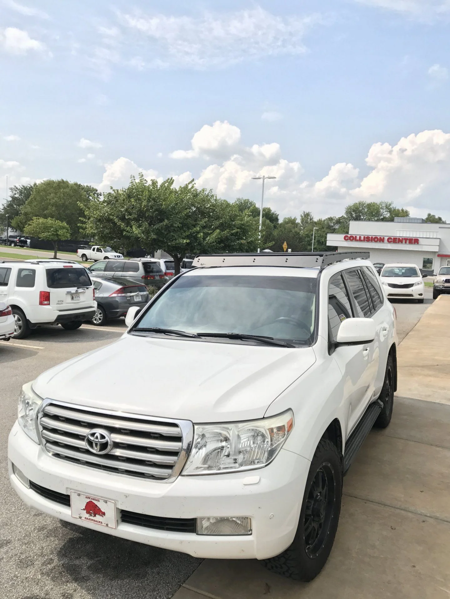

Making some gains! Got the Prinsu roof rack on today. They sent the wrong size bolts, but luckily had a shop 15 mins away with black bolts, so they worked out better than the chrome ones they sent with the kit. Only $6 total cost for 18 bolts.
The install is easy if you make it easy. There are two bolts holding the factory rack and you have to loosen them a half turn alternating bolts so the plate doesn't fall off. I imagine it's a headache when the bottom plate falls down.

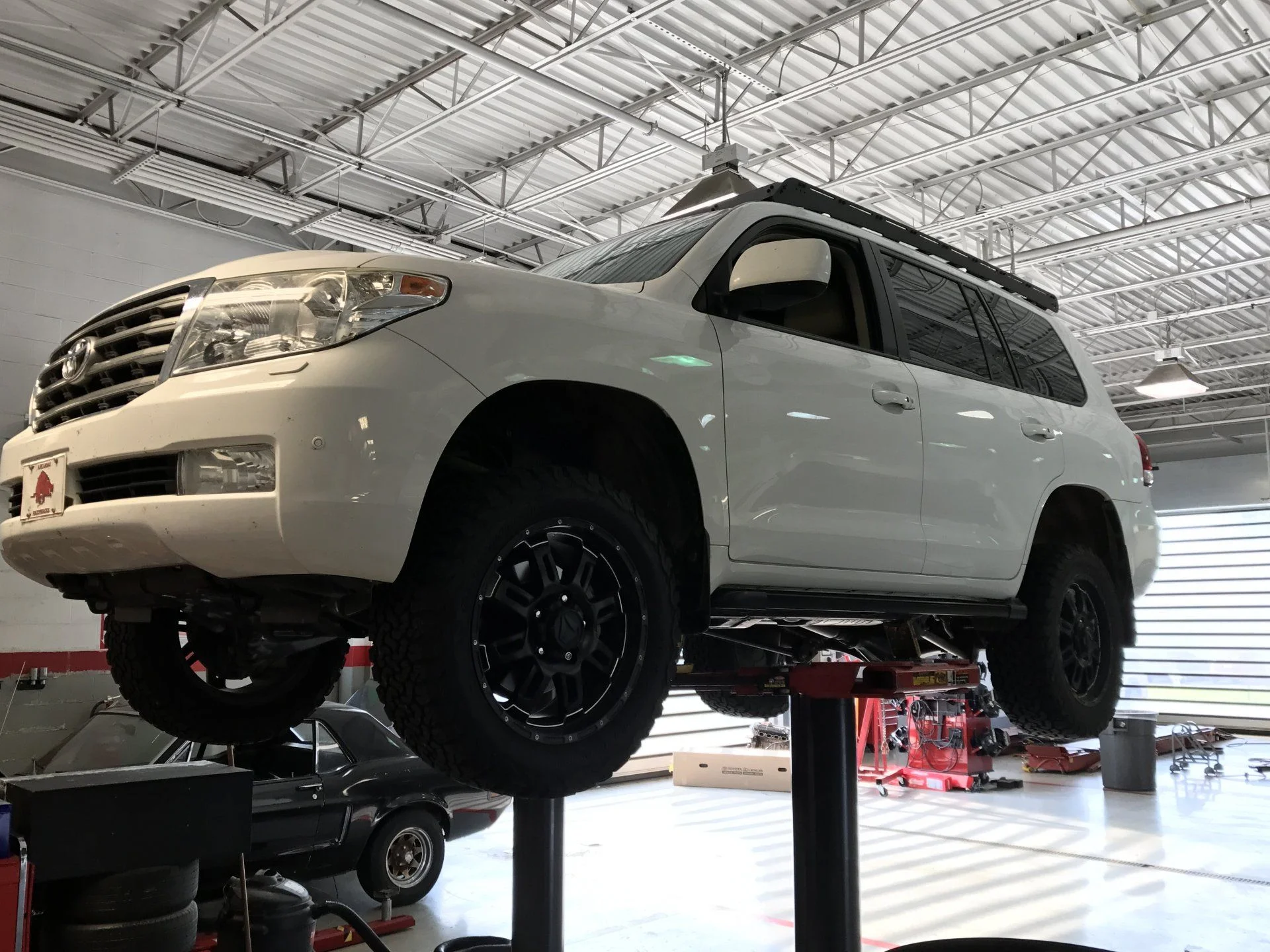

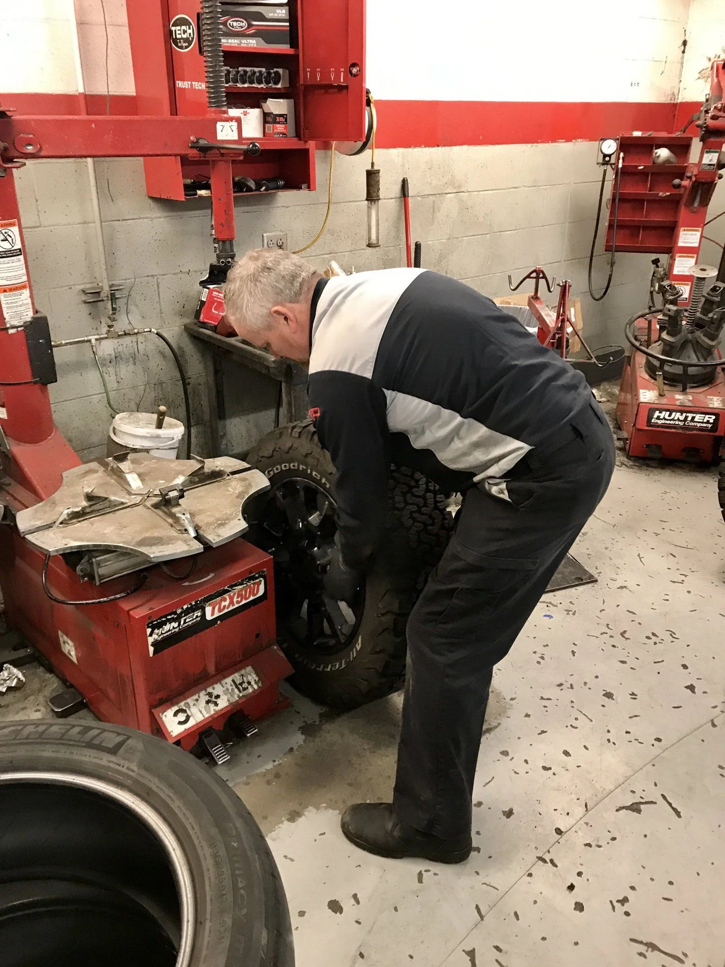

New wheels (TRD Pro Tundra 18") and tires are being mounted (275 / 70 / 18) BFG KO2's. The lift kit won't be installed until probably later today or Saturday, depending on what free time my mechanic Brian has. You can see him working hard to mount the new tires on the wheel haha.
Rack looks great -- what's the finish on those black bolts? If it's black oxide I would replace them with pure stainless steel as they can rust.

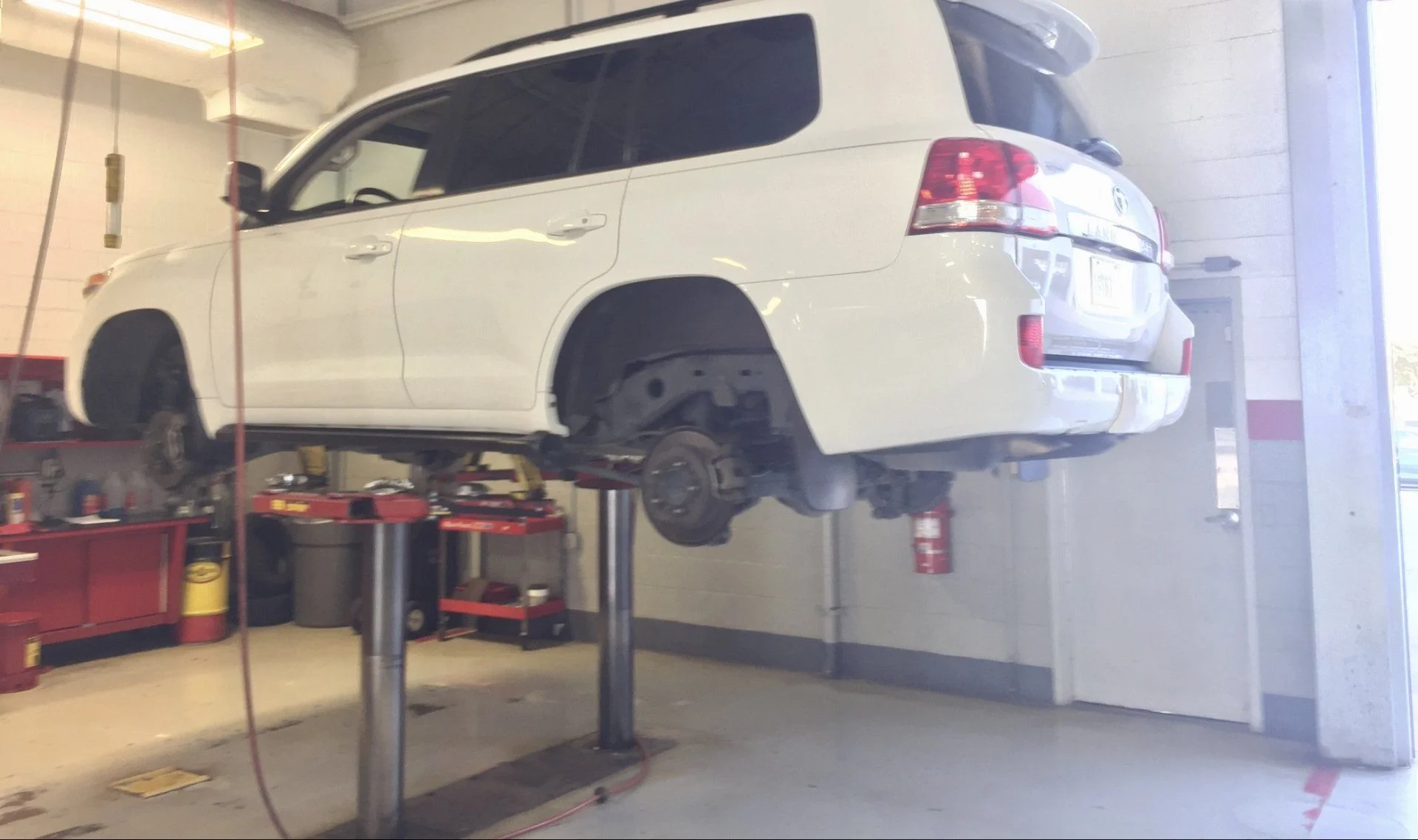

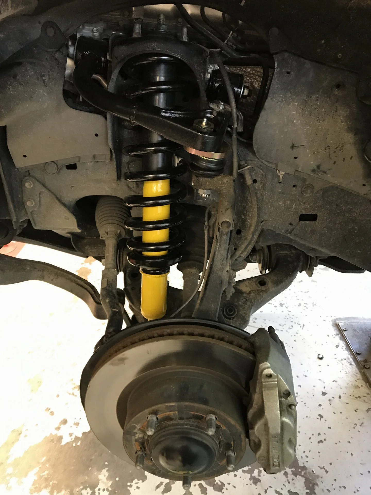

Finished, but one of the tie rods bent a little during installation. Won't be driveable until tomorrow evening once a new one is put on. $50 part, so not too bad of collateral damage. Looking forward to hitting the dirt roads and trails soon!
