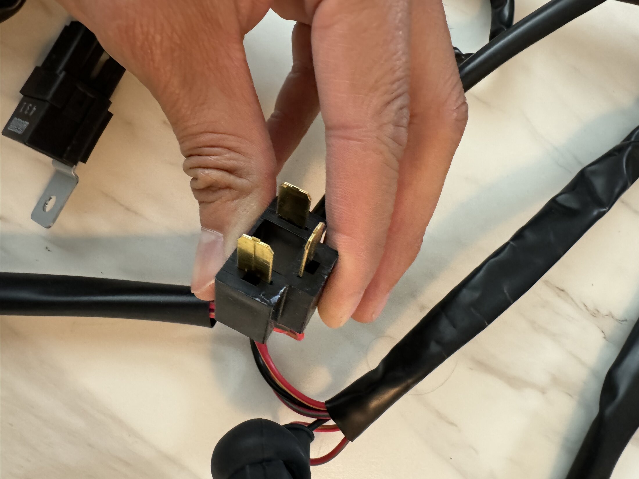

Hey All! Was installing the headlights this morning and realized the female connector from the original headlight harness is not the same as the male connector from the new headlights

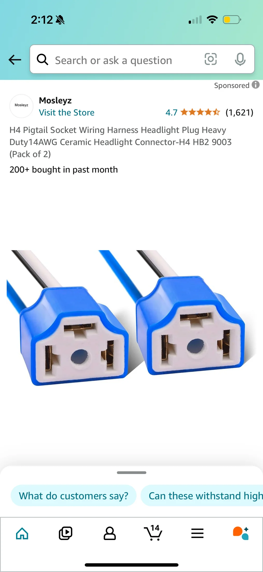

Is the fix as easy as replacing the old female connector with something like this?

is the rig from early-mid 1960's?
the headlight buckets were different back then, they used a similar plug to plug into a pigtail in the bucket, then inside the bucket had the correct headlight socket to plug the headlight into
