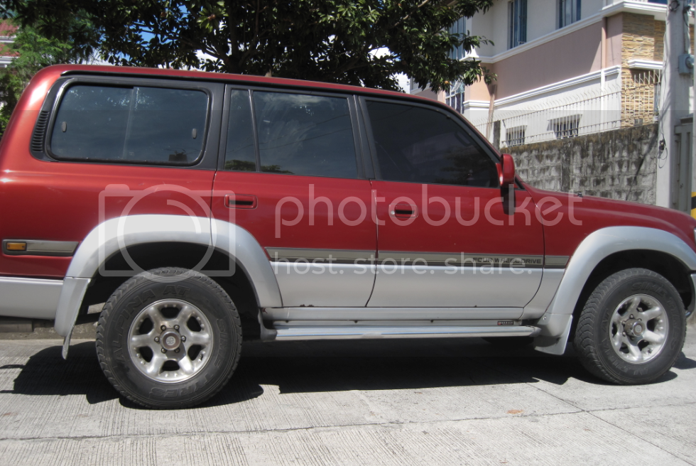

Pre Lift
Measurements I took pre-lift were:
Center of Hub to Fender:
PS Rear 20 1/2"
DS Rear 20 1/4"
PS Front 19 3/4"
DS Front 19 1/4"
Ground to Fender
PS Rear 34 3/4"
DS Rear 34 1/2"
PS Front 33 9/16"
DS Front 33 3/16"
Tires are 265/70/16 or 30.6".

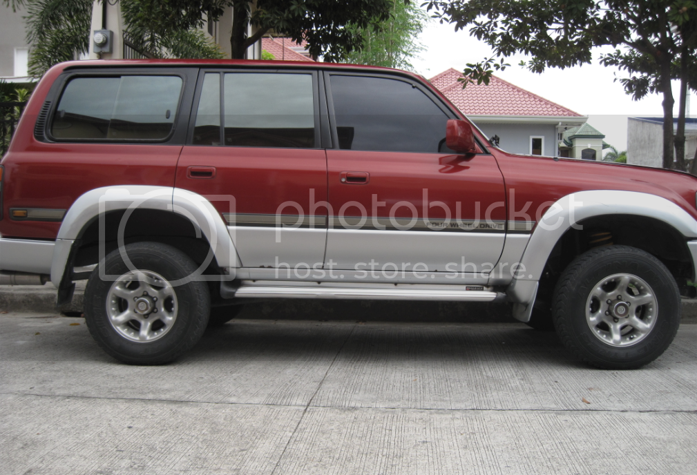

Lift Installed!
Measurements taken after lift
PS Rear 23"
DS Rear 23 5/8"
PS Front 22 3/4"
DS Front 22 7/8"
Ground to Fender:
PS Rear 37 1/2"
DS Rear 37 7/8"
PS Front 36 3/4"
DS Front 37 1/8"
With mini 265/70/16. need new tires!!! 285's? 275's?
I had the Land Cruiser lean before, now it has moved to the right side. Lift was installed with taller springs on the left side as marked on the coils.
Good choice on upgrade pare... now get some bigger shoes... 33" at least.
Is that a Gregzigen exhaust?.. :D How much is the gas price there now?:mad:
33"s cost 14-20K each:eek::eek: Bridgestone Dueler AT or TOYO OC. I was a couple hours late to buy a set of 4 Dueler AT for only 30K:doh: No duratrac here tho
I'm not sure on the exhaust, but it's just the tip. doesn't look like a full exhaust system either. just stock.
Shell V-Power 97 is PHP 54/liter. Just filled up yesterday in Dau.
