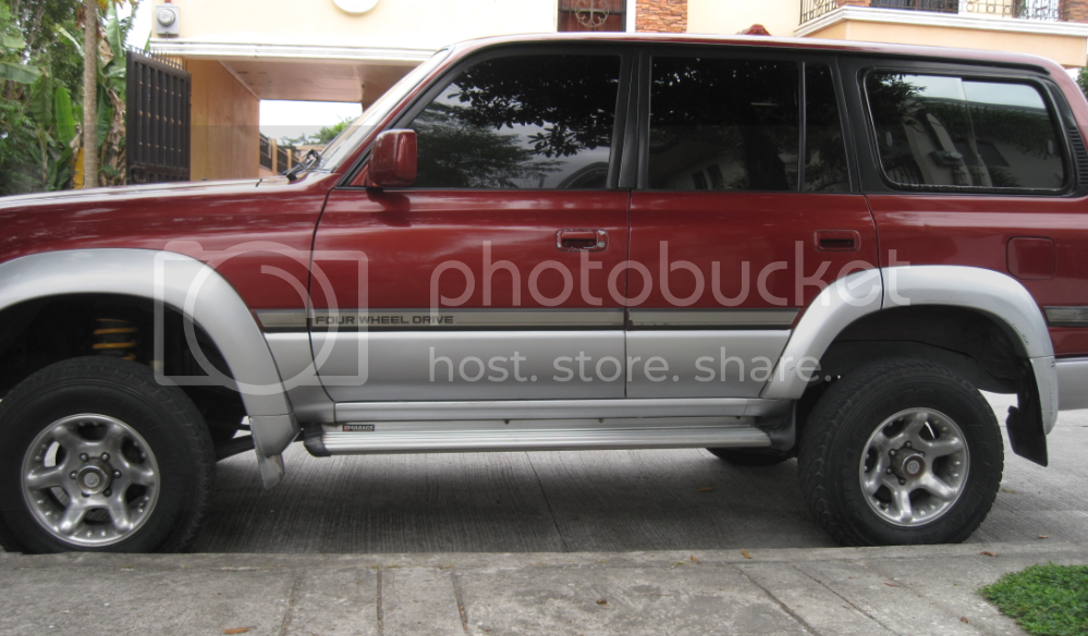

With mini 265/70/16. need new tires!!! 285's? 275's?
I had the Land Cruiser lean before, now it has moved to the right side. Lift was installed with taller springs on the left side as marked on the coils.
Good choice on upgrade pare... now get some bigger shoes... 33" at least.

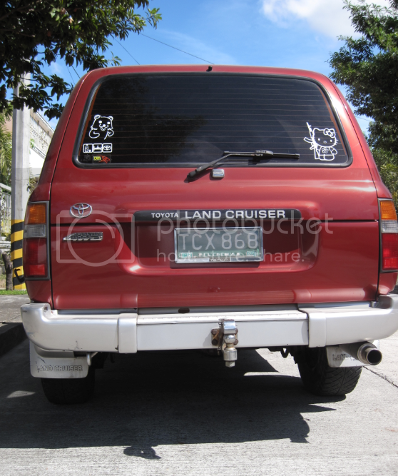

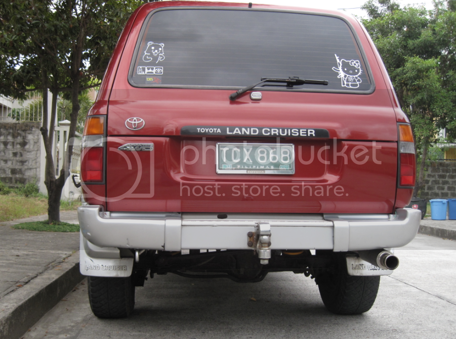

Is that a Gregzigen exhaust?.. :D How much is the gas price there now?:mad:
33"s cost 14-20K each:eek::eek: Bridgestone Dueler AT or TOYO OC. I was a couple hours late to buy a set of 4 Dueler AT for only 30K:doh: No duratrac here tho
I'm not sure on the exhaust, but it's just the tip. doesn't look like a full exhaust system either. just stock.

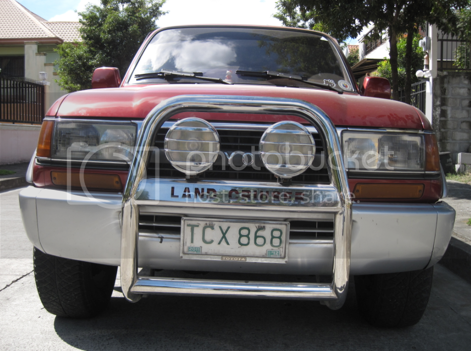

Nice Truck Bro. I like your JAOS centre protector. looks BARAKO. You can to go raon sta. cruz they have a lot of surplus from Japan.
