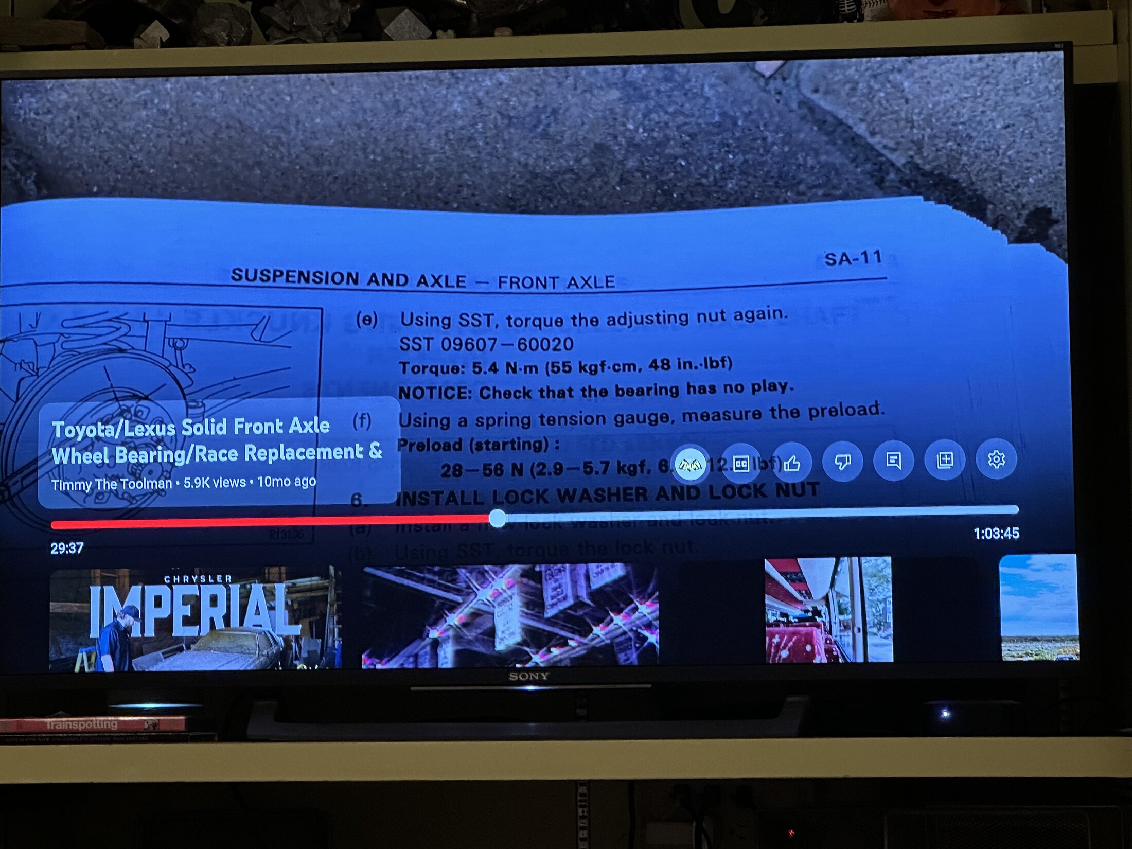

this is what this timmy the tool man does. he goes in for 43 ft lb preload. undoes it and then final torque is 48 INCH pounds.
am i correct in understanding both of these are wrong and it should be like 45 or 48 foot pounds for the final setting?
just checking here since the video seems wrong. maybe someone corrected him in the comments but seemed worth posting on. meaning the typo is this orange highlight and it should say foot pounds?
You will have to skip ahead to about 53 minutes into the video to find the part where he torques down the hub. There is a series of operations where you torque the first nut down to a certain value (I think it was in the 70 foot pound range), then loosen the nut back up, and then torque it back down to a lesser value. Then the lock washer goes on. Then the second nut which gets torqued down in the 40 foot pound range, and then the tabs on the lock washer get bent over to secure the nuts.
