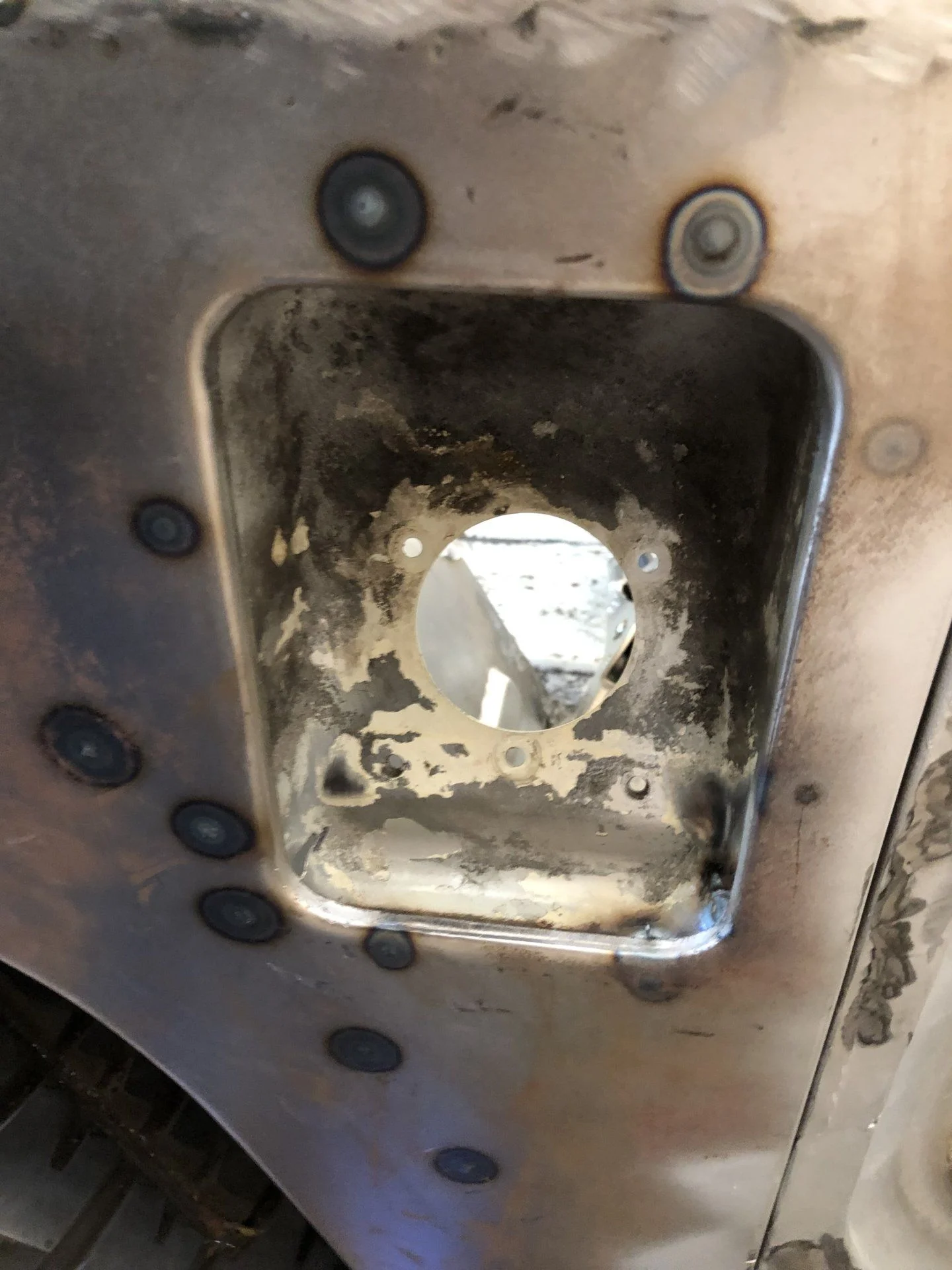

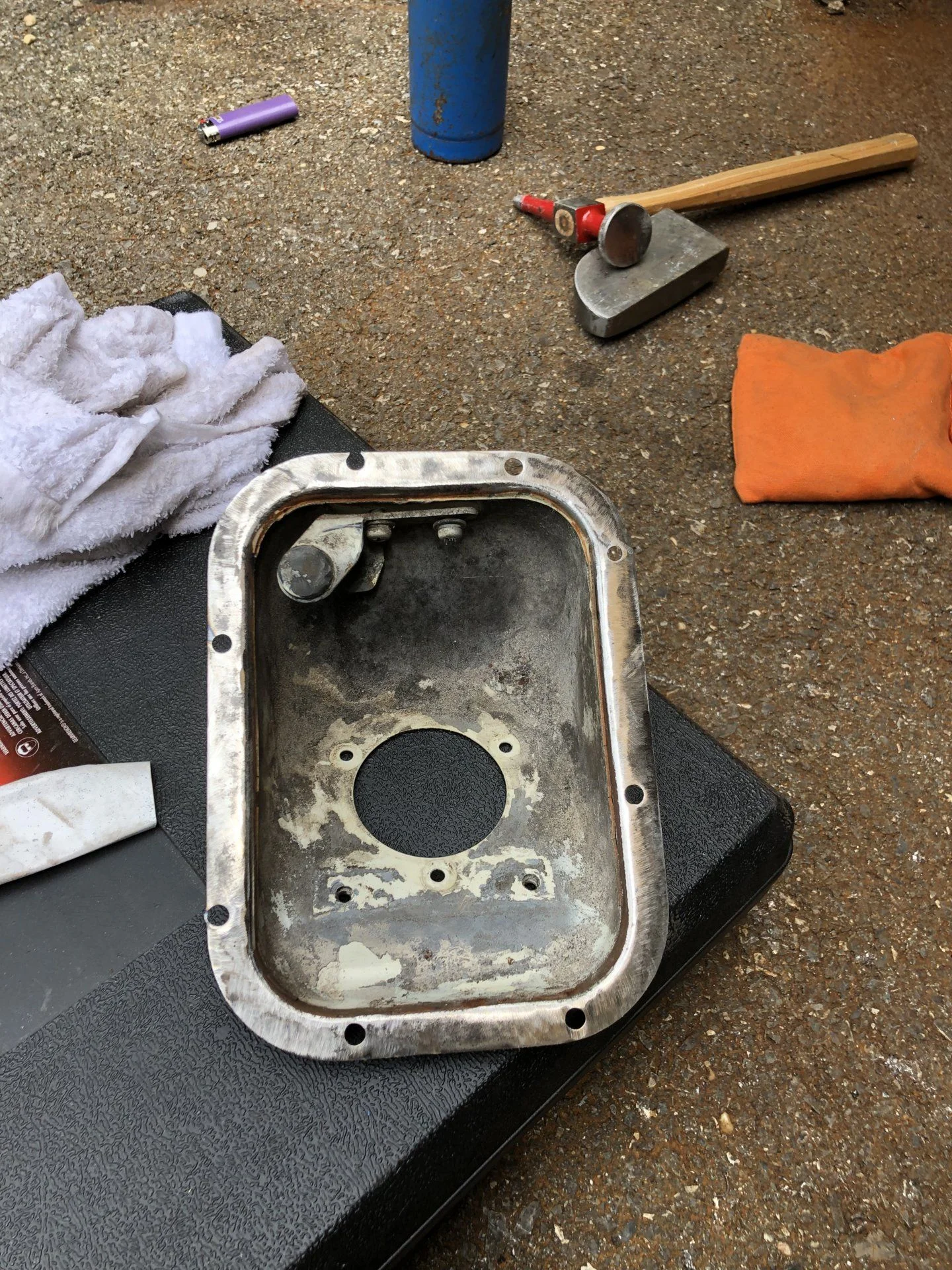

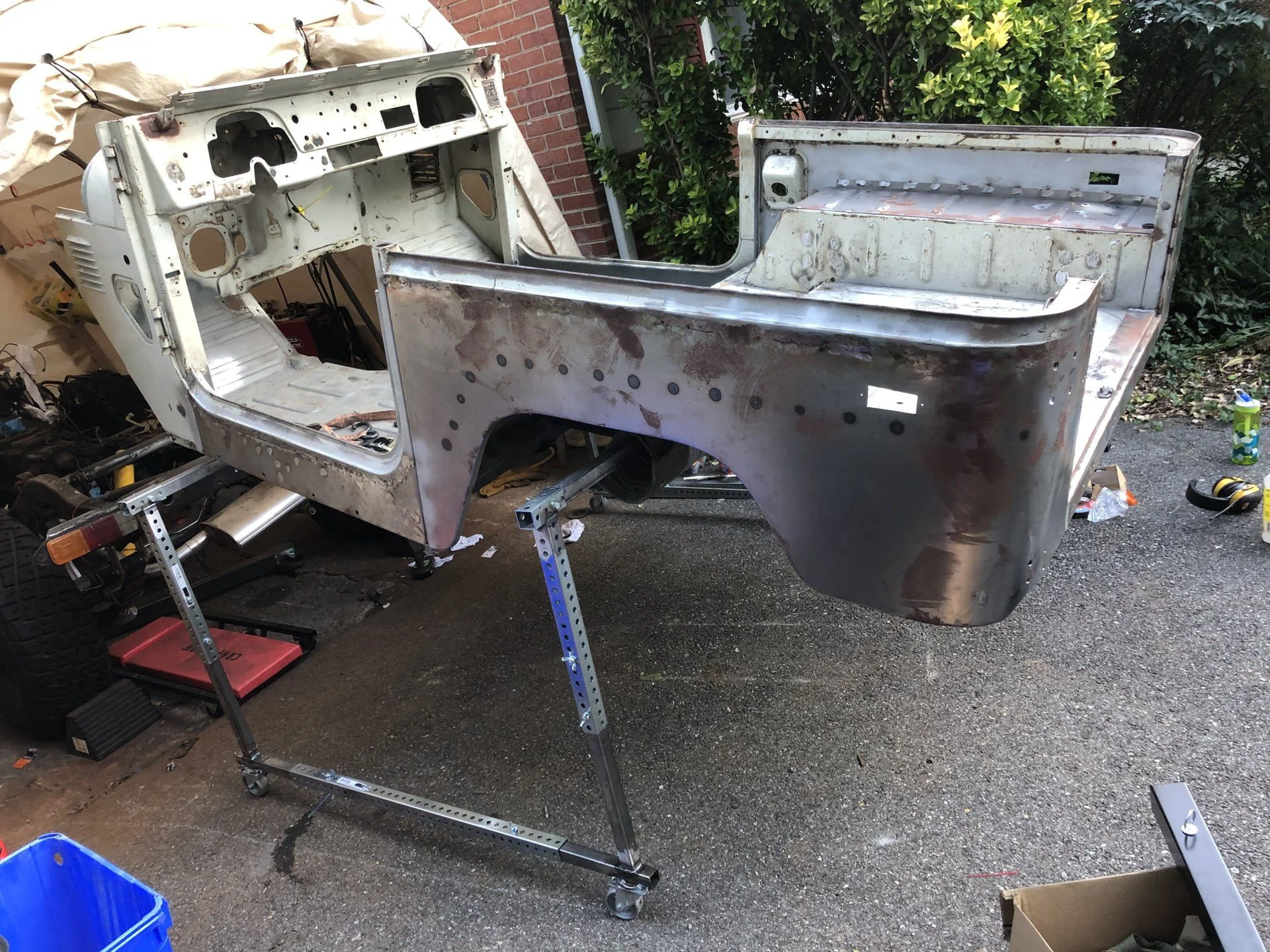

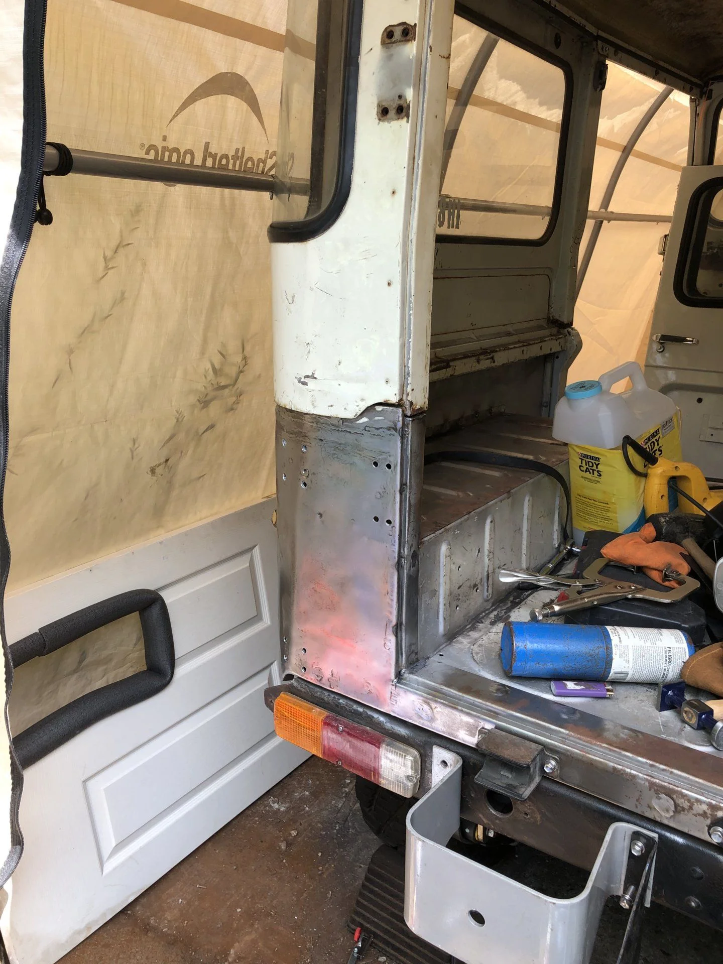

Lots of grinding today. Tried to install the “gas filler” (not sure what it is really called), but it was about a half cm too small for the opening! I had to cut the filler to make it fit.

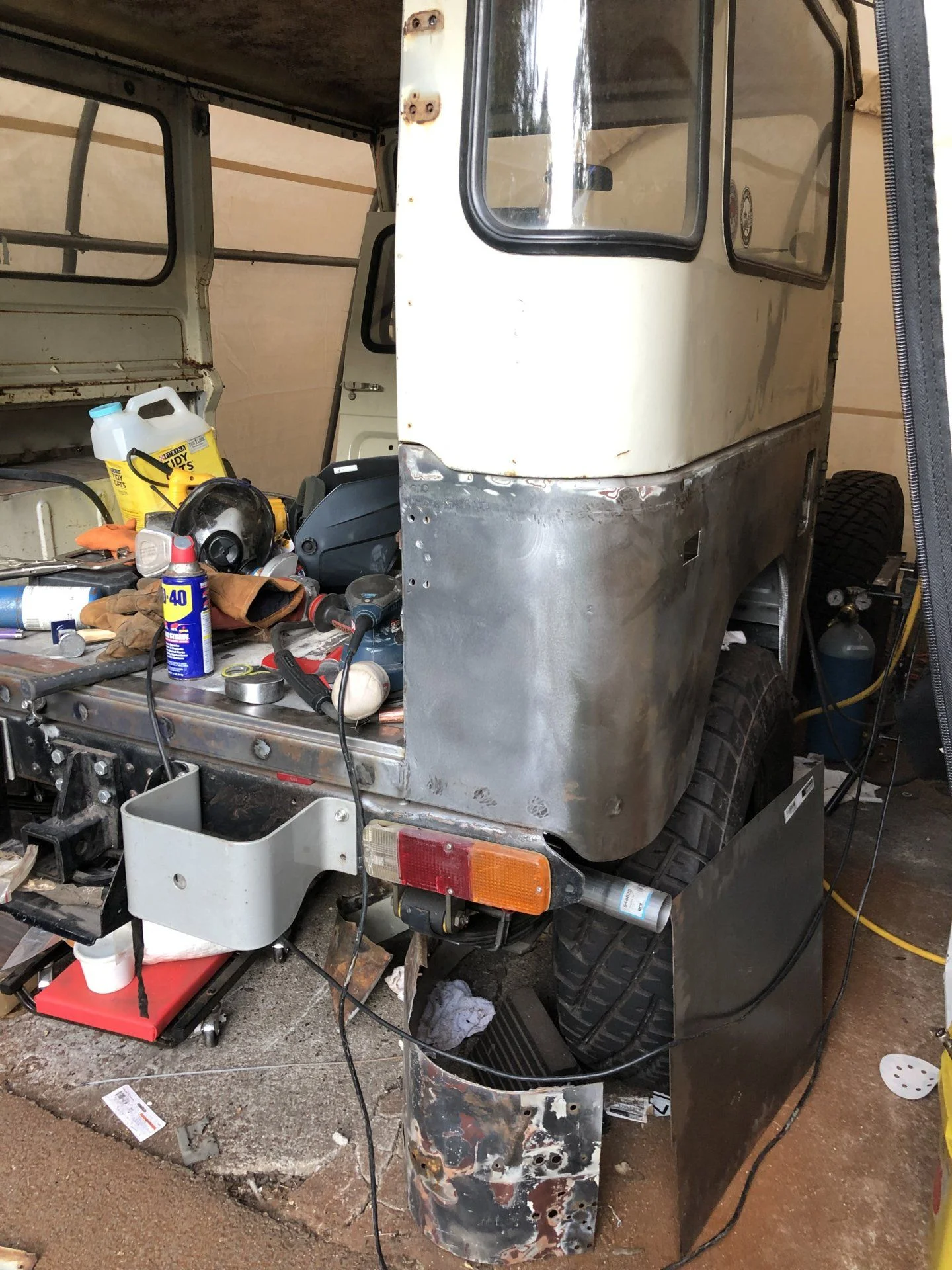

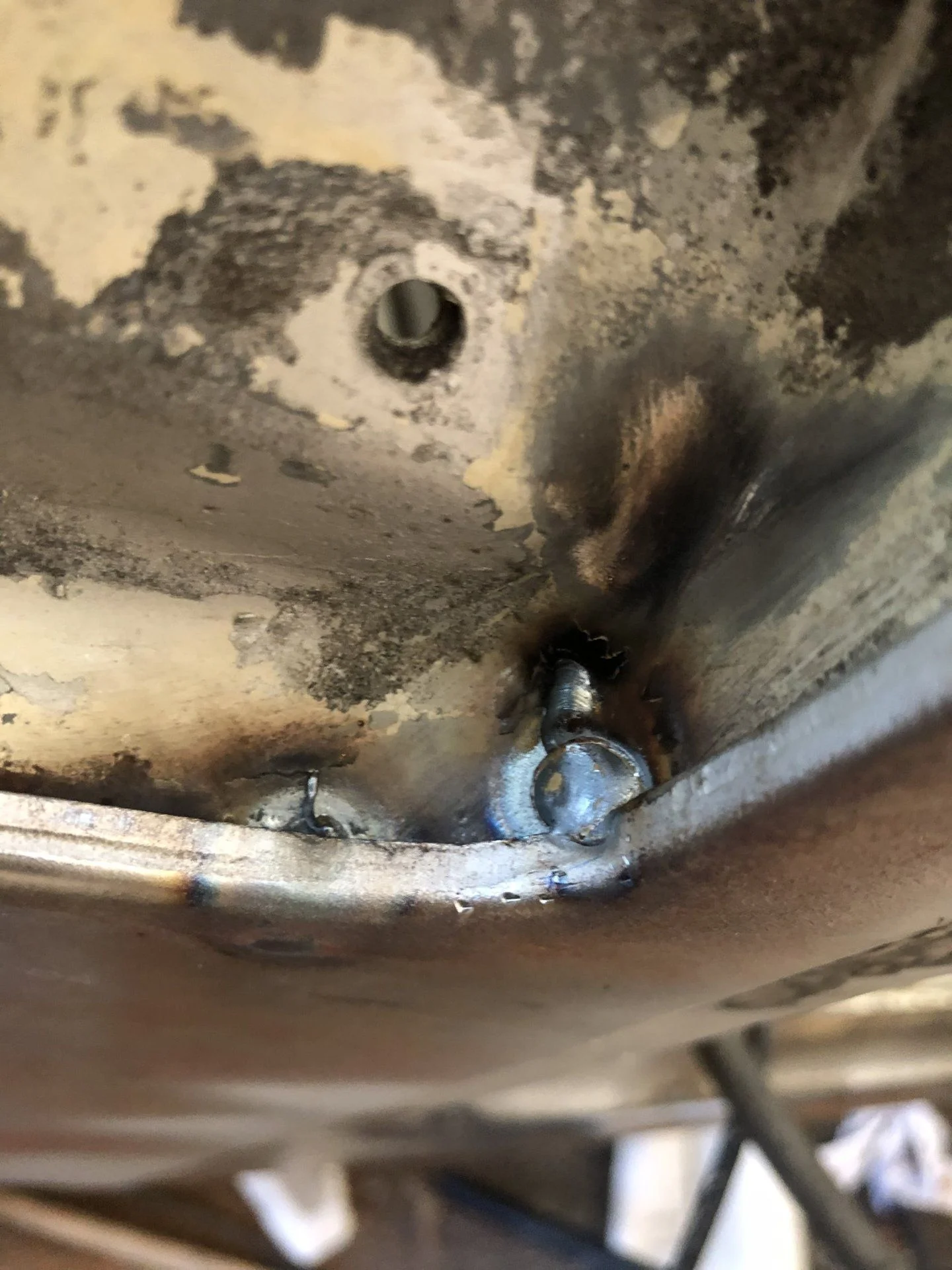

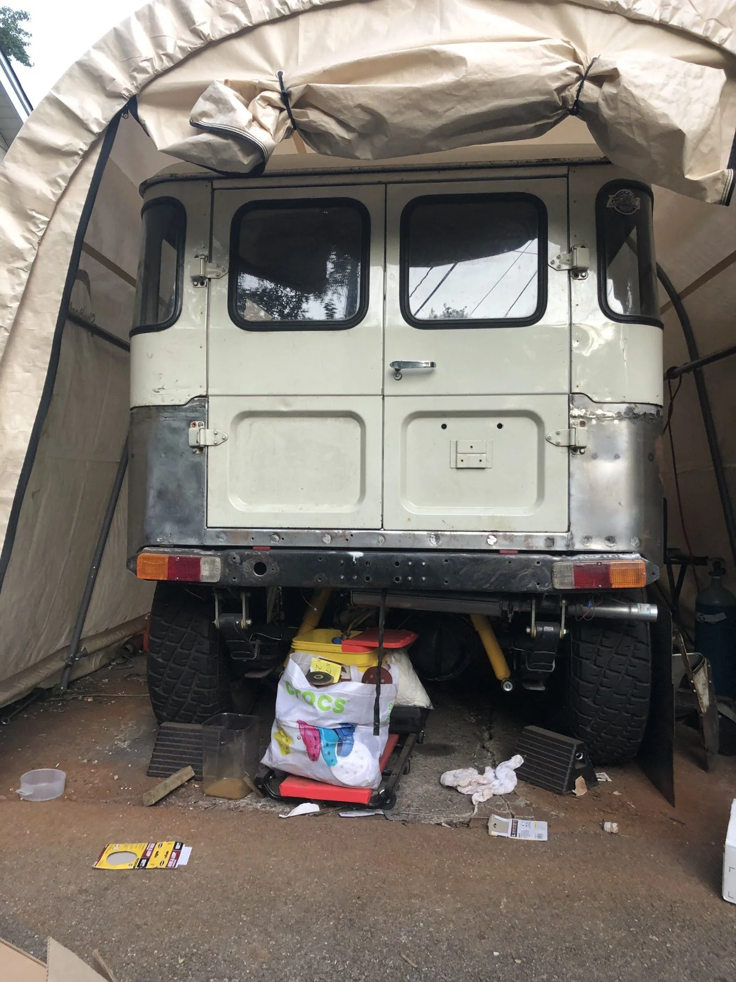

In case anyone was wondering, panels are from Real Steel. The panels all appeared to be great quality, but I have been disappointed with fit. The radius of the quarter panels at the bottom where it sits over the rear cross member and curves from rear to side was not quite right. I could not get it to rest flat against the horns ( it stuck out 1/2 inch and could not be bent because of the angled lip). I eventually heated it with a torch and banged it into submission, but not without dinging the crap out of it. Probably just me not knowing what I am doing!
The gas tank filler thing is another story. Not sure I can explain that poor fit away with lack of experience. The filler was clearly stock with factory welds in place. The panel was from the correct year.

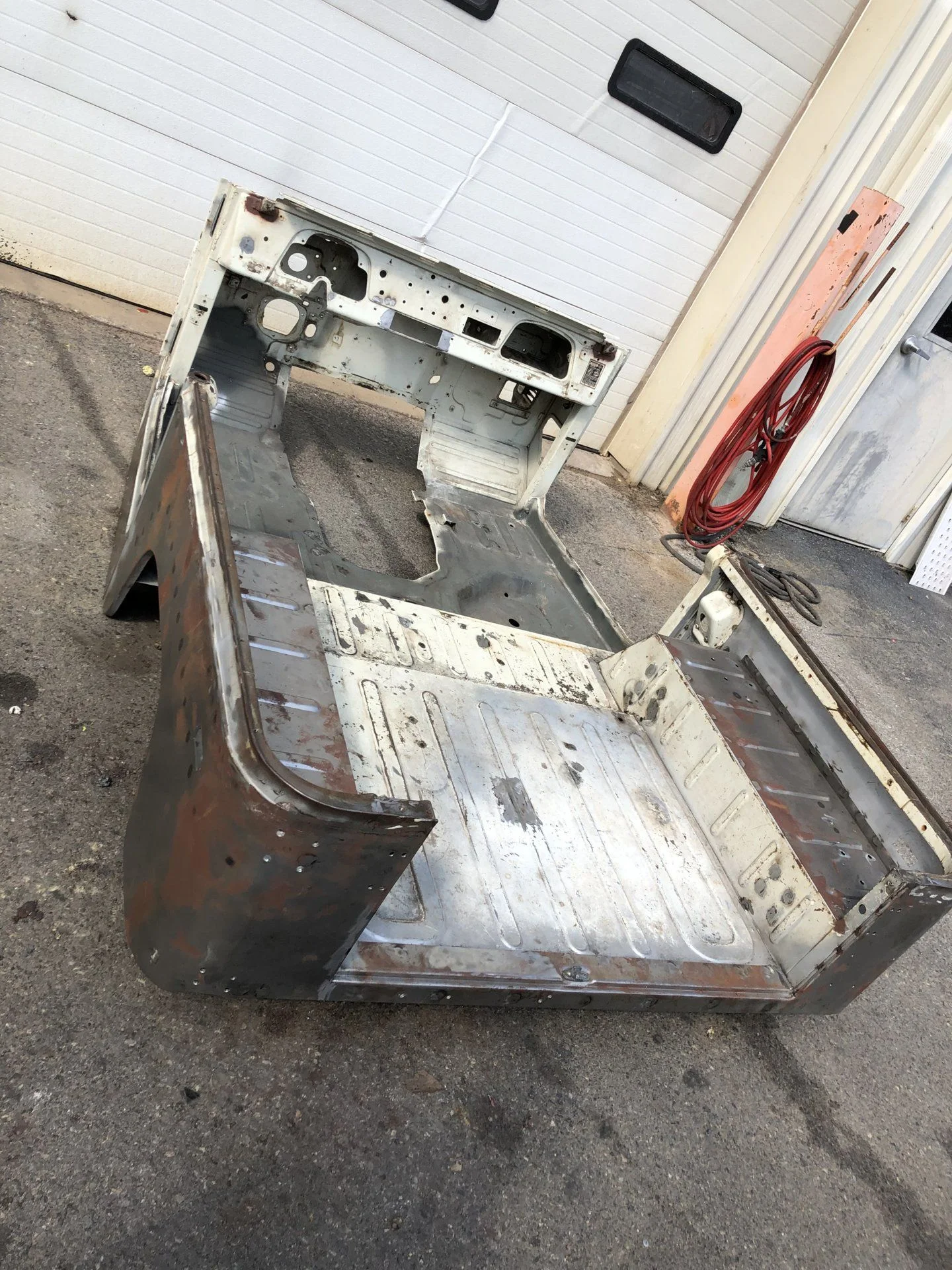

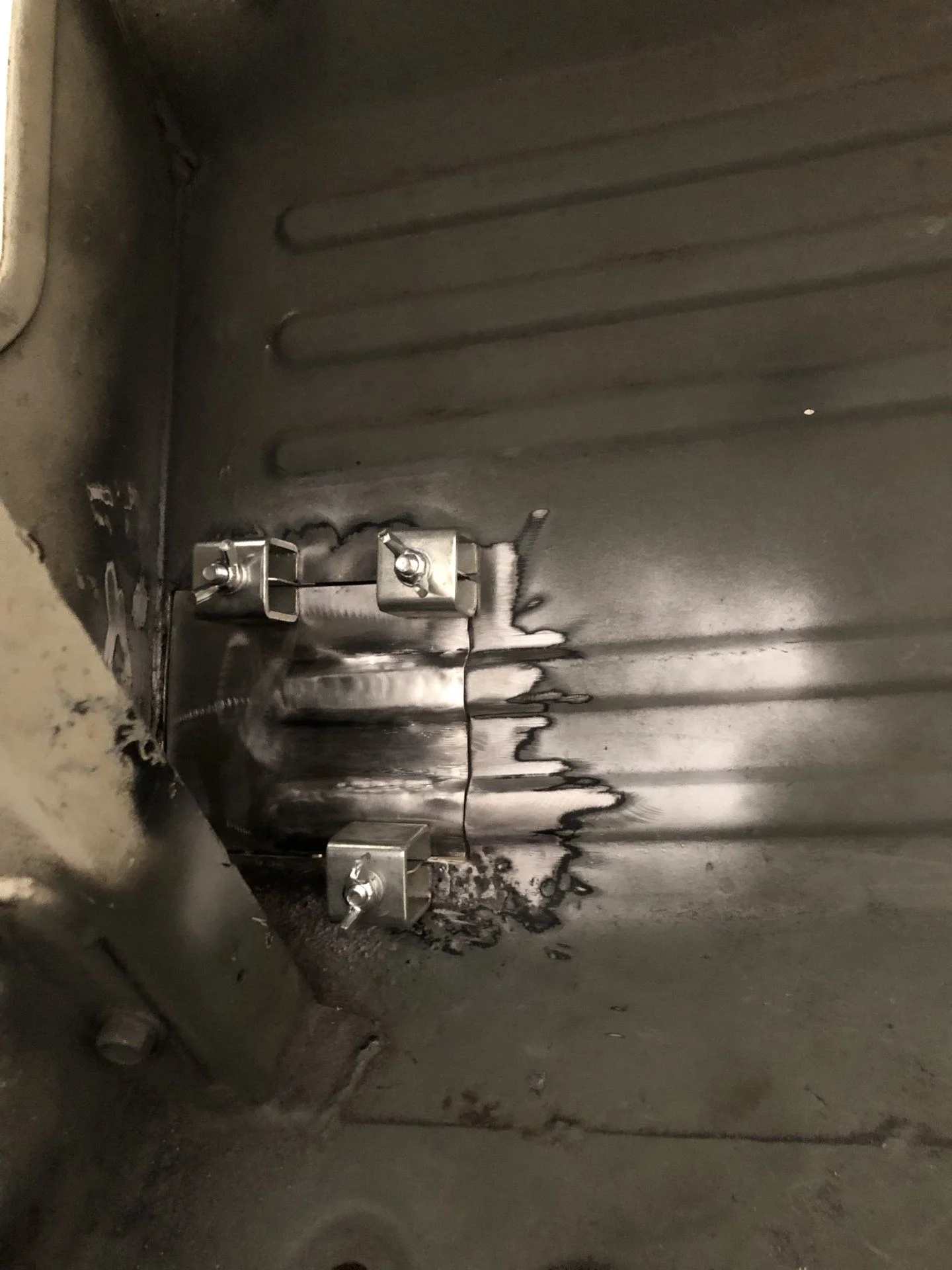

Been busy, back log of photos to post. Put everything back together, drilled some holes and welded on lots of mounting brackets and captured nuts. Everything seems to fit ok still.

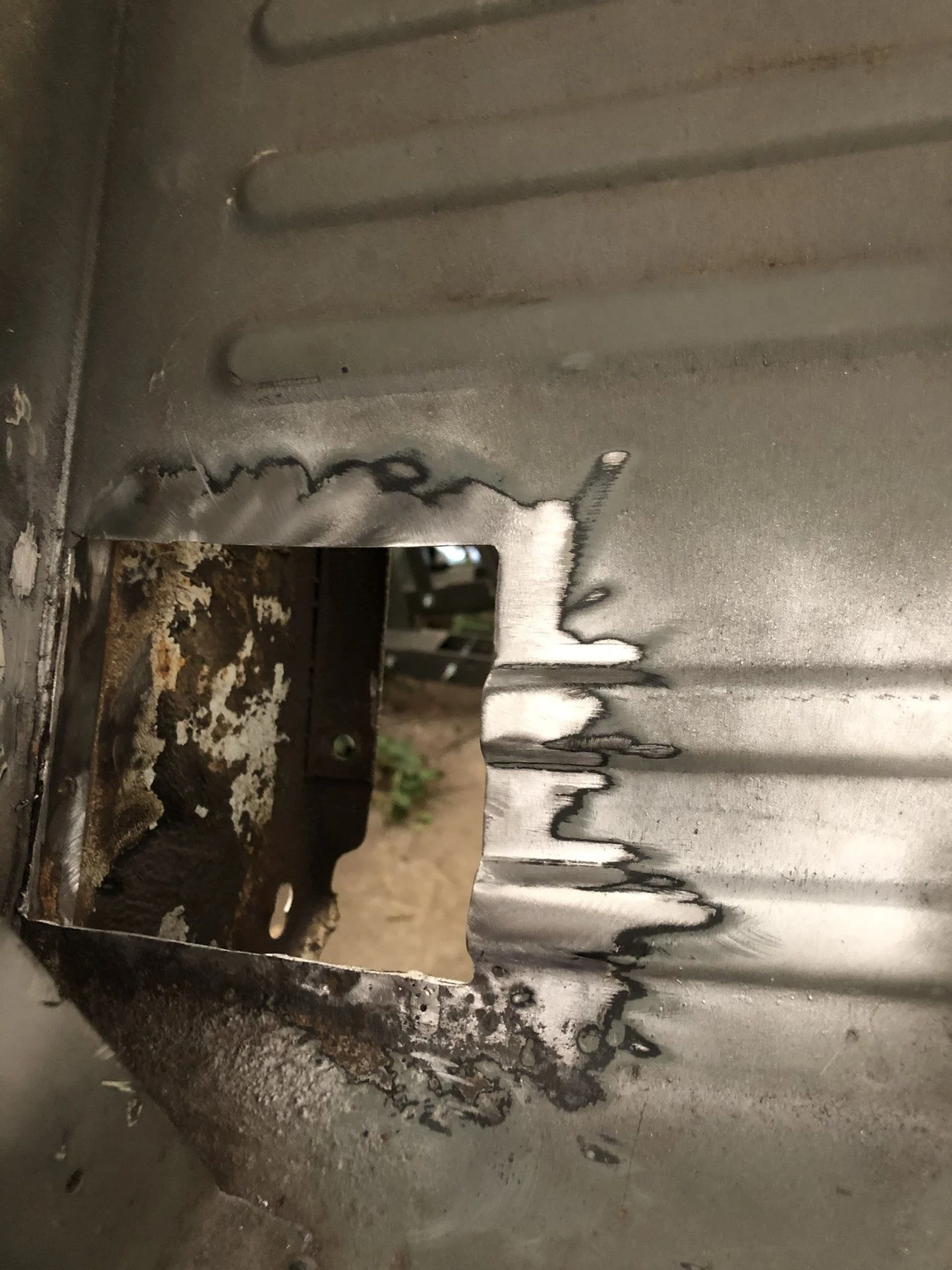

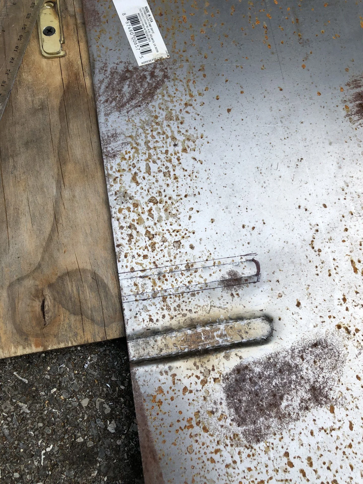

Not sure why all those pics loaded, just meant to post the last one! Made a patch panel for the driver side floor pan using heat and some hand tools. Turned out good enough. Will be covered by a mat anyway and it is now solid 16g instead of rusty Swiss cheese.

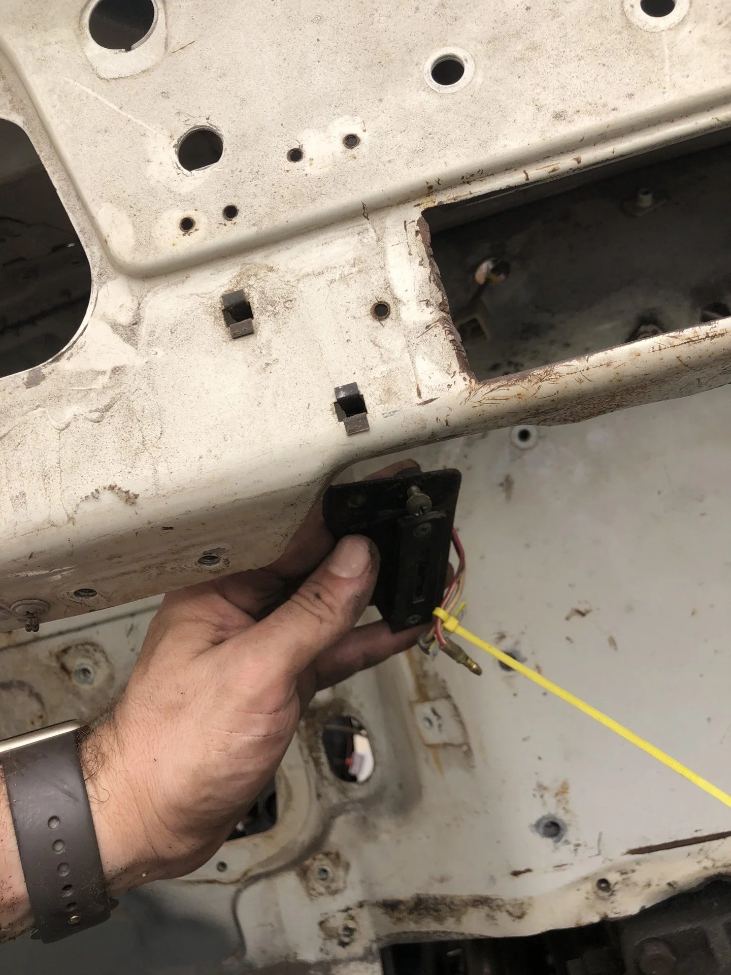

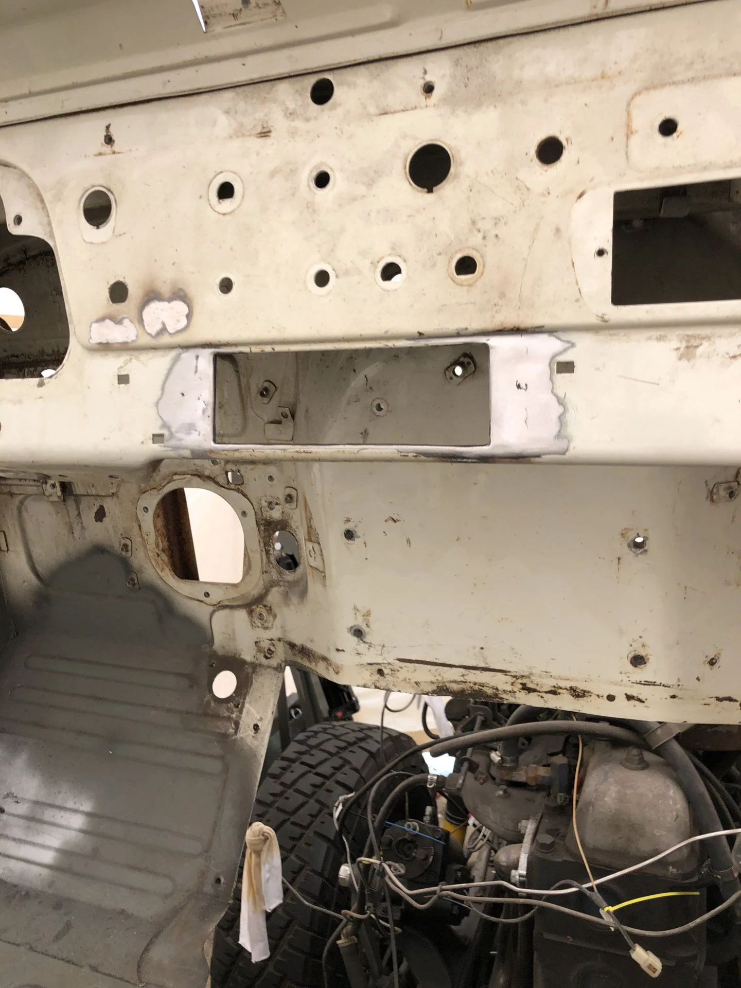

Also replied the cut radio slot and returned it to factory dimensions, still need to work out some mounting brackets for the sides, but at least I can insert the factory radio delete plate now.

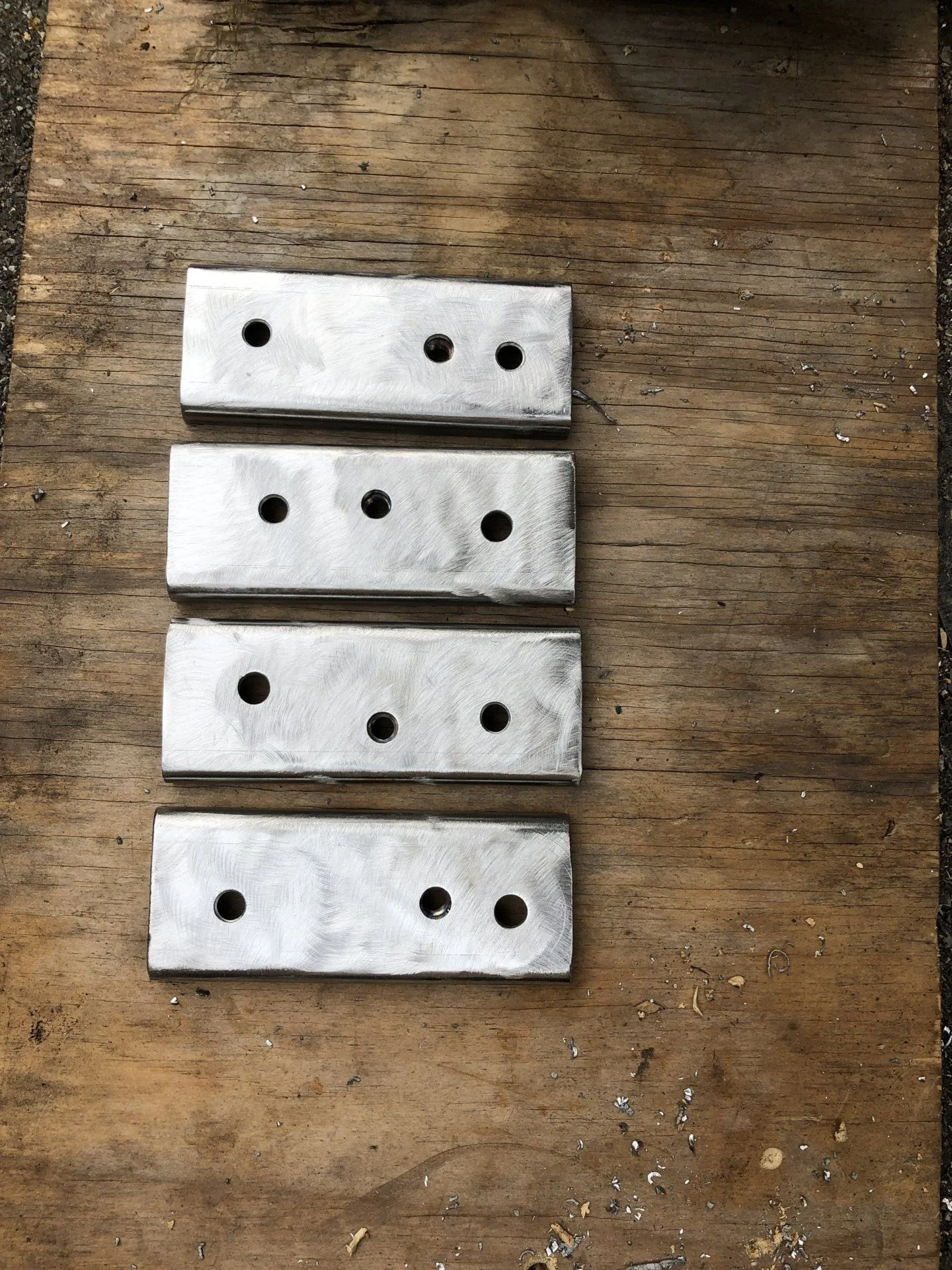

Also made some new brackets for the jump seats.

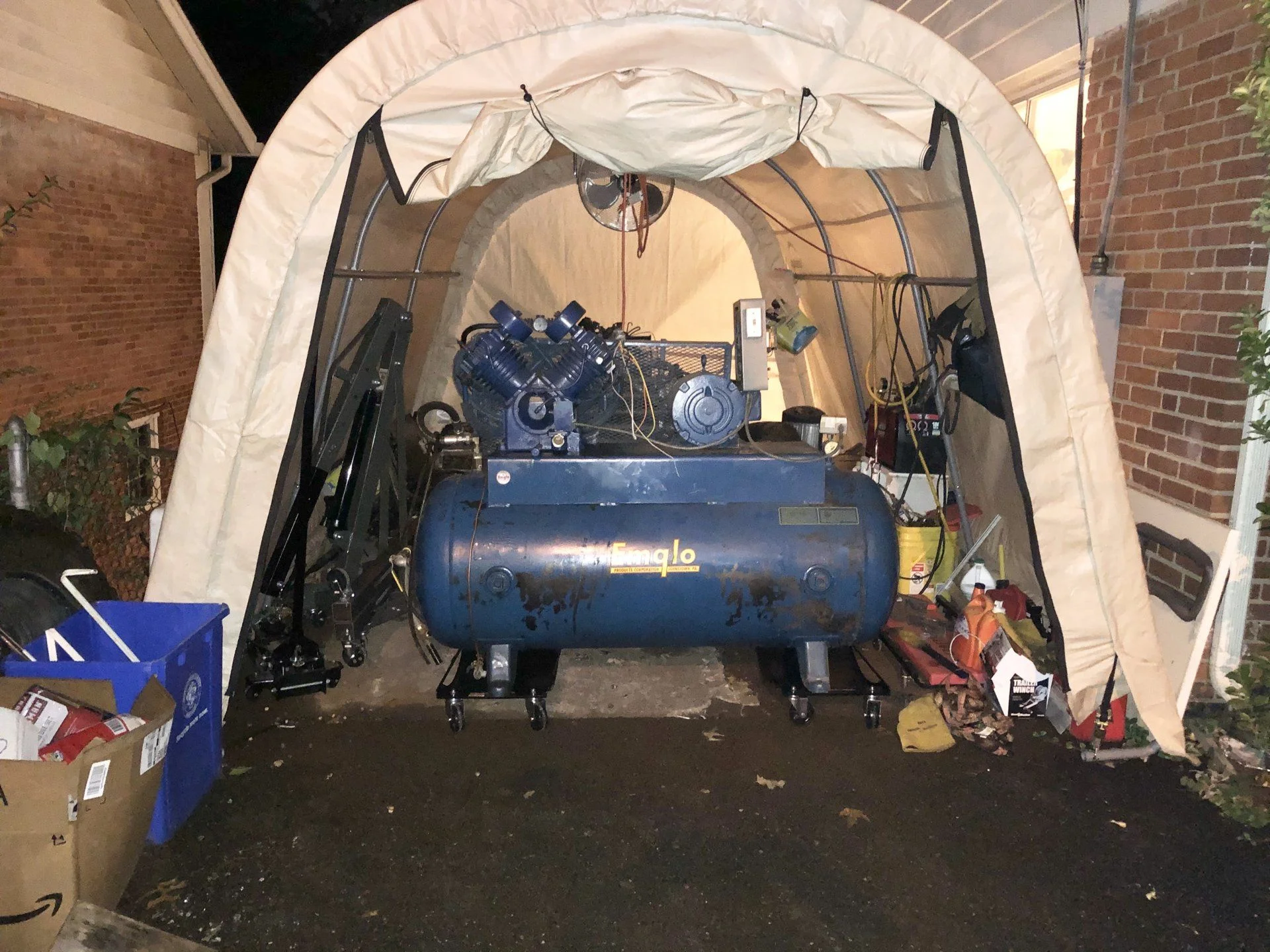

So, found an older 2 stage emglo 10hp compressor, about 2-3 times the compressor I need but the price was right. Was used in a machine shop previously and seems in good working order. Guy listed it as a single phase motor. After moving 1100 pounds of compressor 20 miles by myself, I noticed it was really a three phase! Looks like a VFD would be necessary to run it, would need a massive one, about 15-20hp! A bit impractical. Live and learn I guess. The search continues

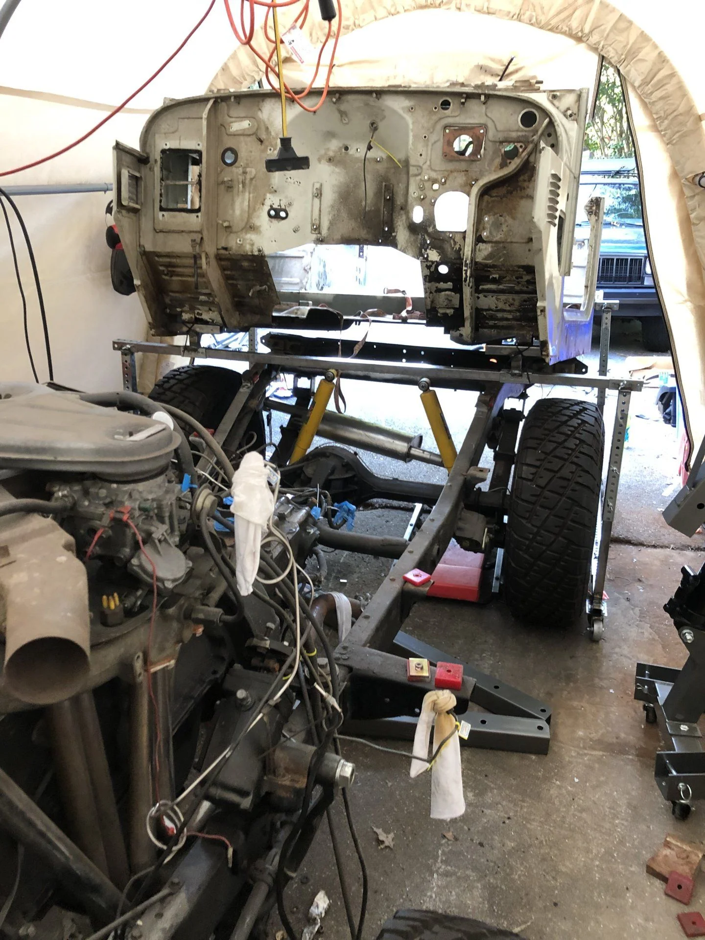

Pulled transfer case with the intention of just replacing seals due to extensive leaking. Most was from the speedo gear I think, but there is a bypass hose between the transmission and transfer case so I suspect the seal is bad there as well.
Gear oil looks clean and the gears visible through the inspection window look to be in good shape. I want to avoid a full rebuild. I plan on painting the case and having the rusty hardware replated.

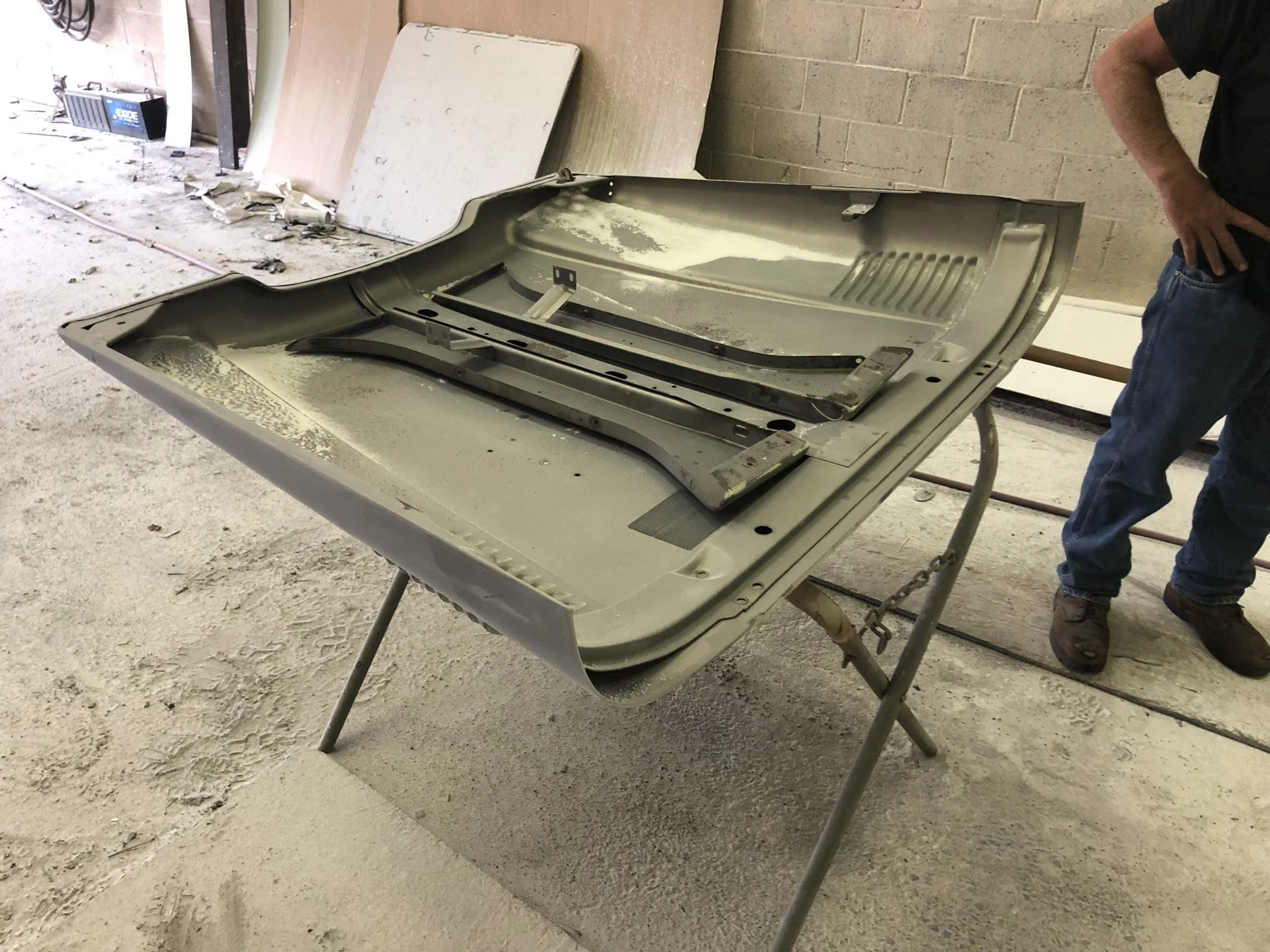

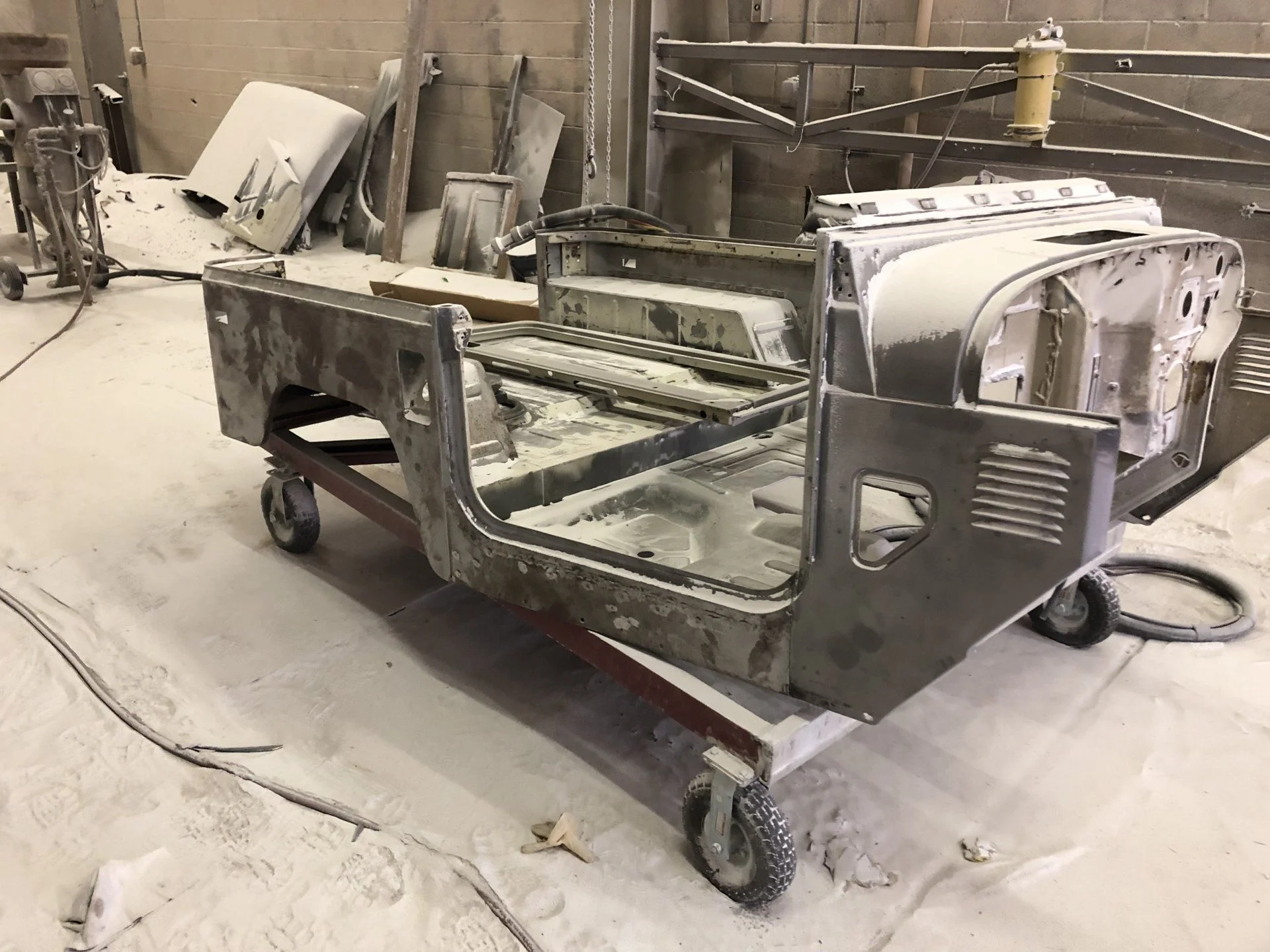

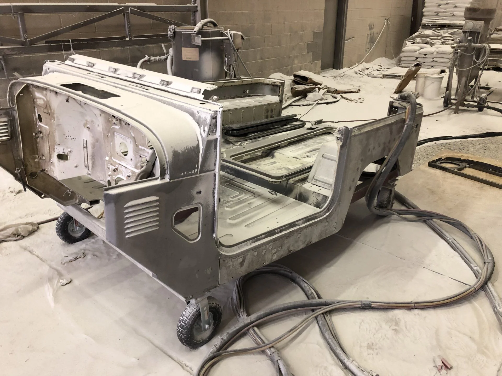

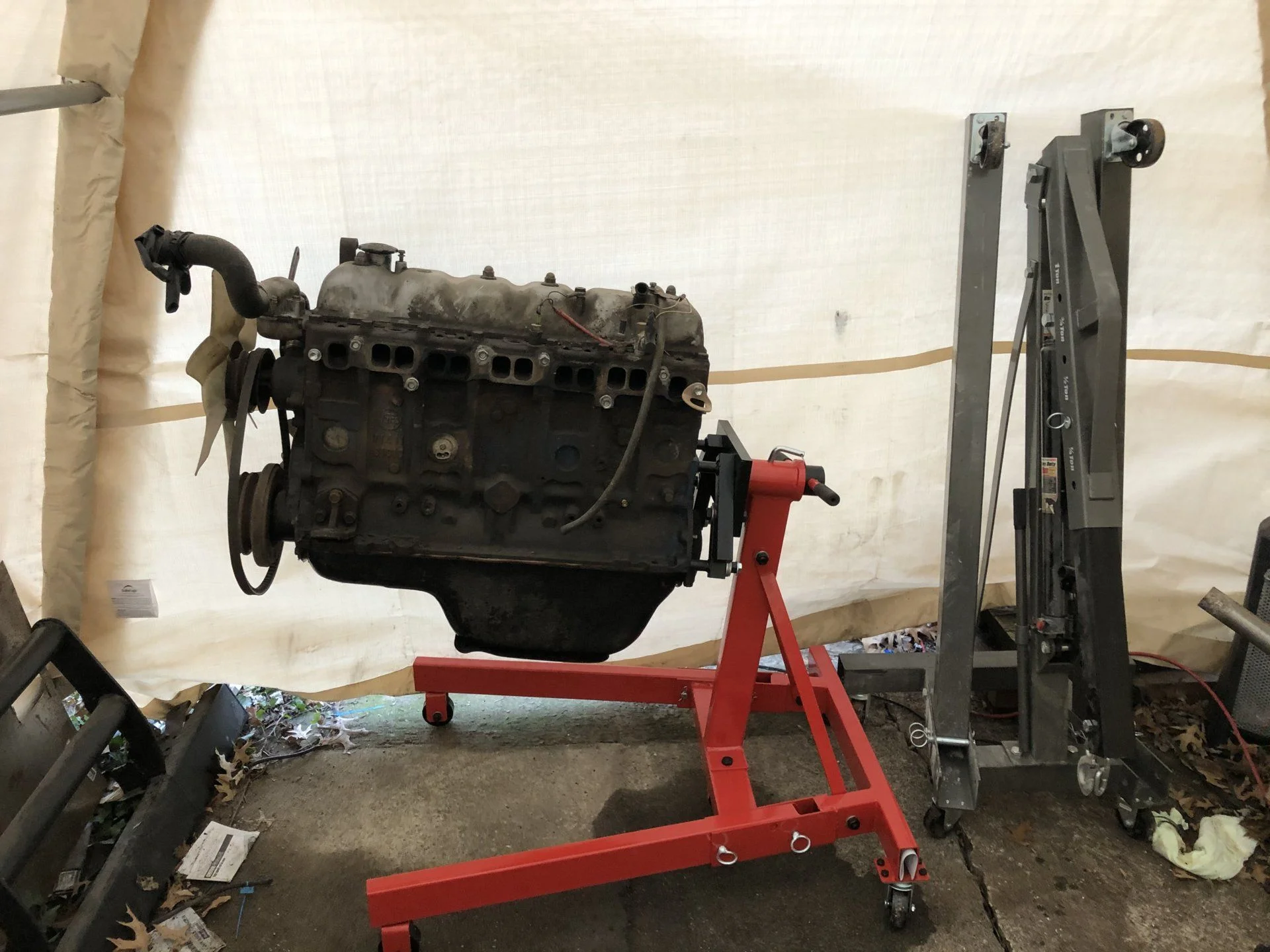

Engine is out. Still deciding on galvanizing frame vs painting. The shop that blasted and primed the tub did a terrible job. After not taking pictures of the whole thing in bare metal and clearly pruning some parts without even blasting, they left the entire mess in the rain for a week!!! Already rusted. And tried to charge double for “additional blast media.
Needless to say, it will be redone, and I will need a new shop to do the frame.

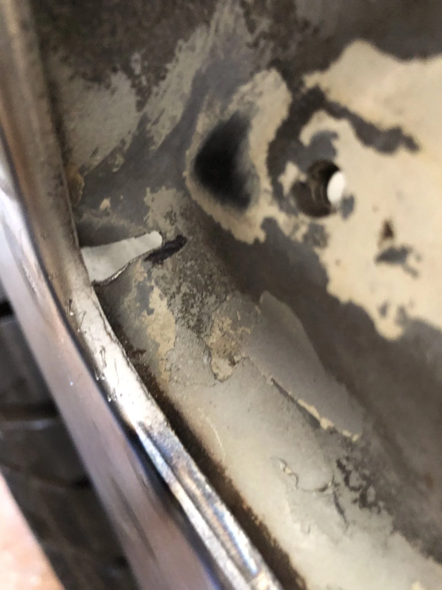

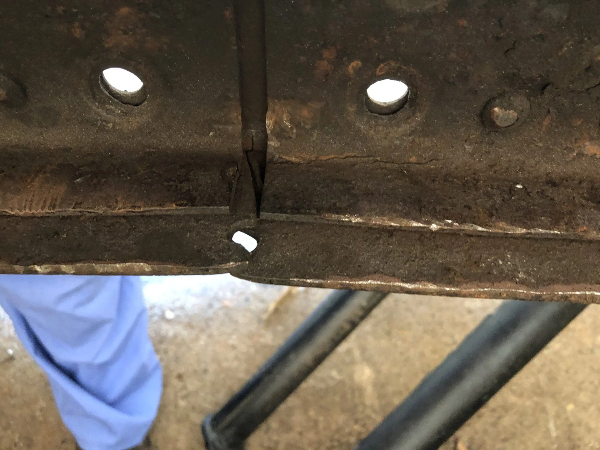

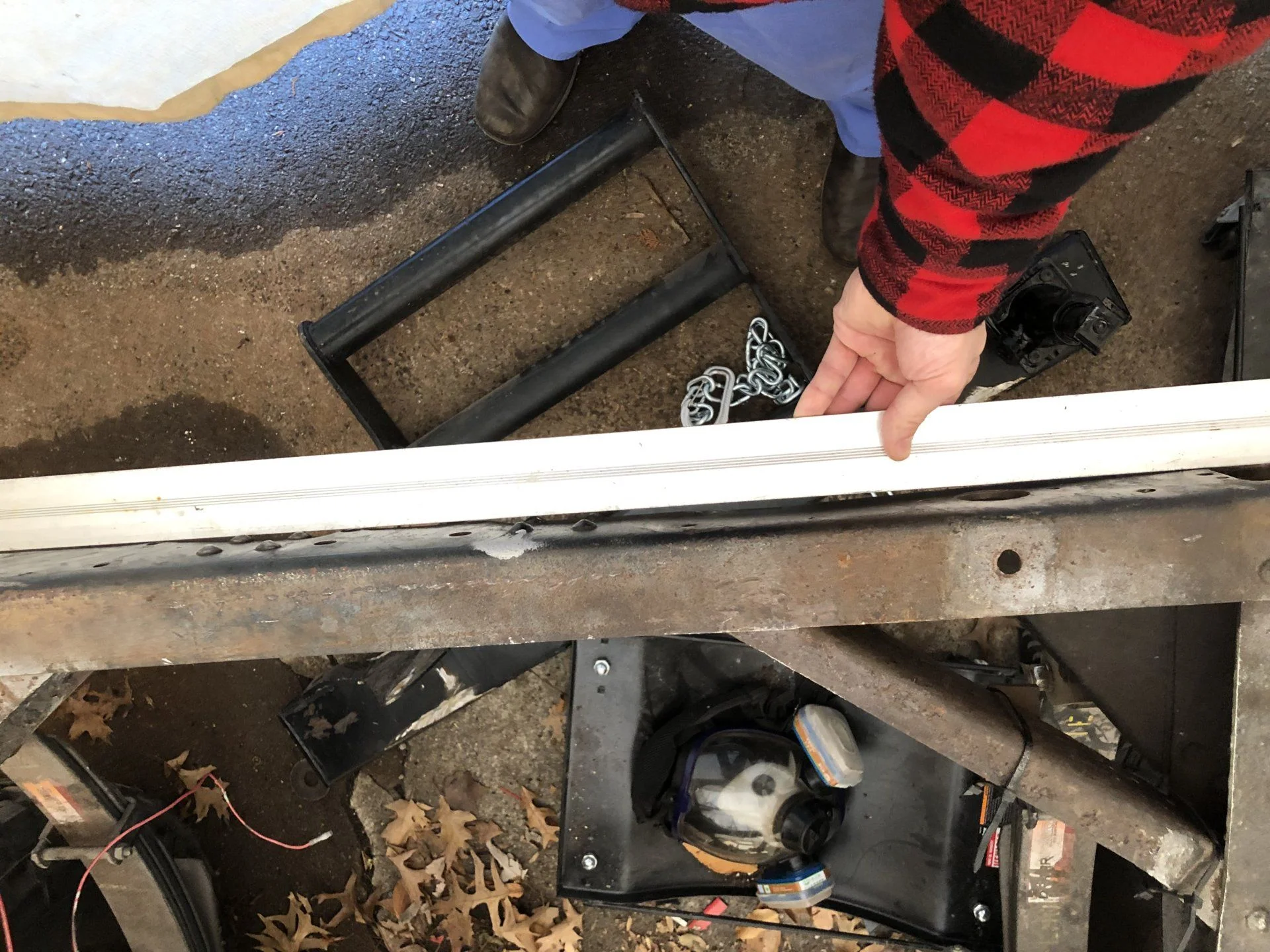

I also have some extensive repair to do on the real cross member, I really don’t want to replace it. There is an unfortunate bend, a crack, and the horns are a mess - lols like they were bent upward toward the tub and the holes for the lights have been widened, perhaps to accept a later model light?
