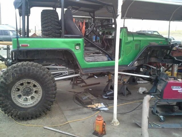

A pic from the left coast with the front mocked up.
2 - 2.5 weeks of downtime huh? If that's the case, then I guess you wouldn't be too terribly upset if I tried to hire Bill and Kevin Auto Transport to bring a certain pig halfway to MS...maybe Albuquerque'ish.

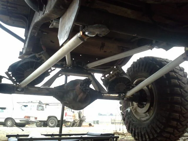

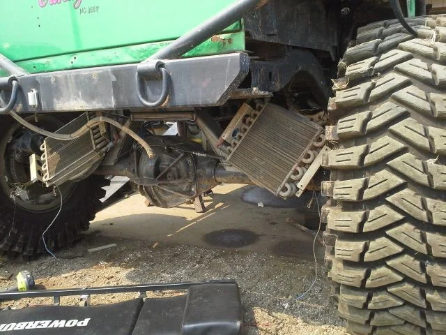

T-minus 22 days or so til the wagon train leaves Cali for crawl. Apparently the transmission and steering cooling fans needed to be relocated for the rear brackets. The rear axle is placed and links should arrive on Wednesday.

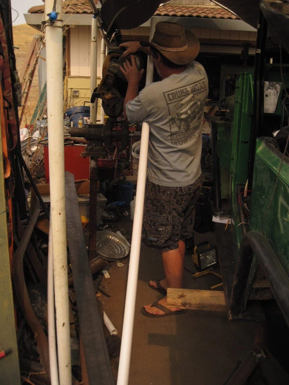

so some stuff actually got done on kermit this weekend. I have some other pics, but I'm kinda hungry and need a sammich. for now, here's Bill cutting a link for kermit. note him modelling the prototype Stayner Safety Sandal{tm}. yesterday, the prototype underwent welding slag, metal shavings, and a garage that looks like someone exploded a junkyard with 400 lbs of ANFO - all with minimal yelping, cursing, or bleeding.

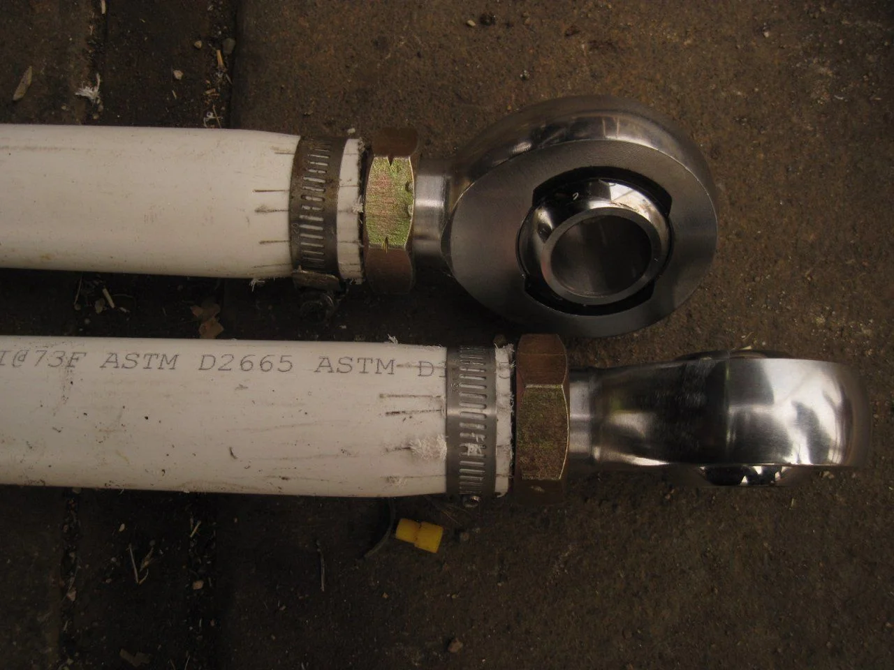

a careful eye might have noticed the reddish-white link material and wondered what it was. the red is from all the fires in the area that have done wonderful things for all the blue skies we usually have this time of year. after the glow of the fire is removed, it's just plain old PVC pipe. it's taking too long to get the links Heather actually wants, so the truck is getting built with PVC pipe. it'll help keep the weight down, and as long as she doesn't land a link on a rock or anything, it should hold up more or less fine. it also provides a safety fuse for the welds on the axles and frame, as those can tear off easily. spare parts aren't a problem, just bring a ten foot chunk or two of PVC and a hacksaw, and you're back and wheelin. try THAT with DOM links. :lol:
