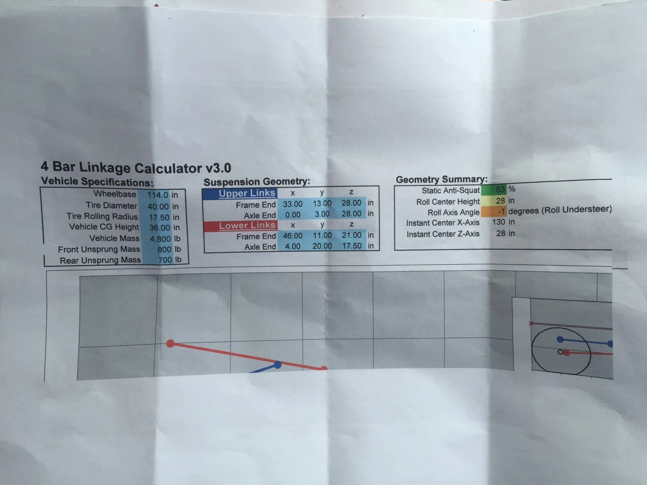

Really interested in seeing how the front end turns out...having trouble visualizing the panhard 8" in front of the housing with the axle moved forward 3" and the frame horns trimmed.

So yeah. The panhard that far out made me scratch my head too. But FC said we could move it back some. Likely that will happen.

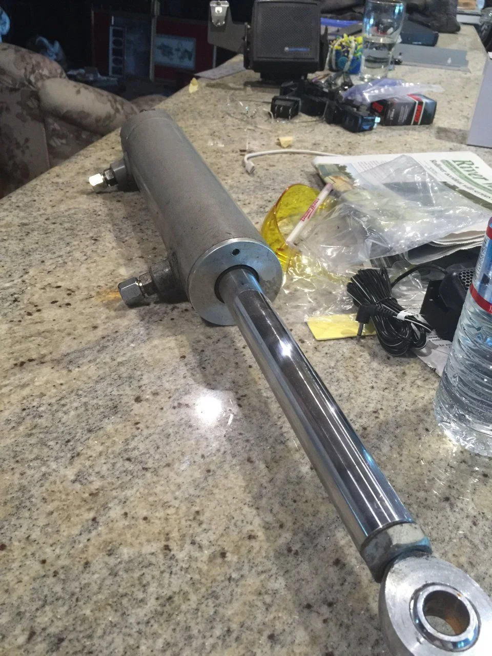

Steering will mostly stay the same. It's already full hydro. I'll be putting in a new ram that FC gave me. That will be the only change. Well, that and making the ram fit.

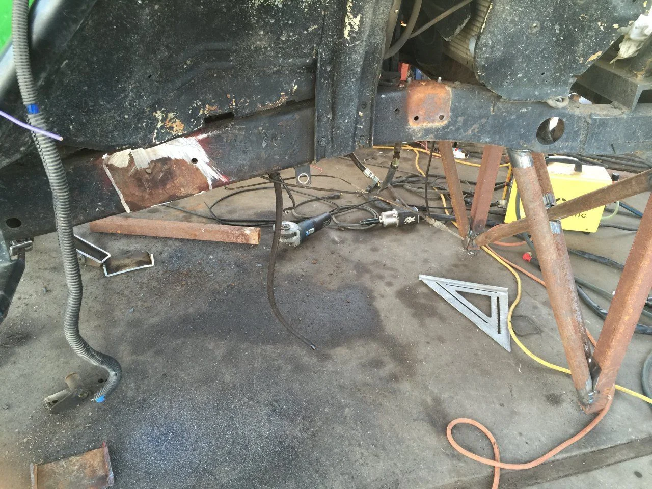

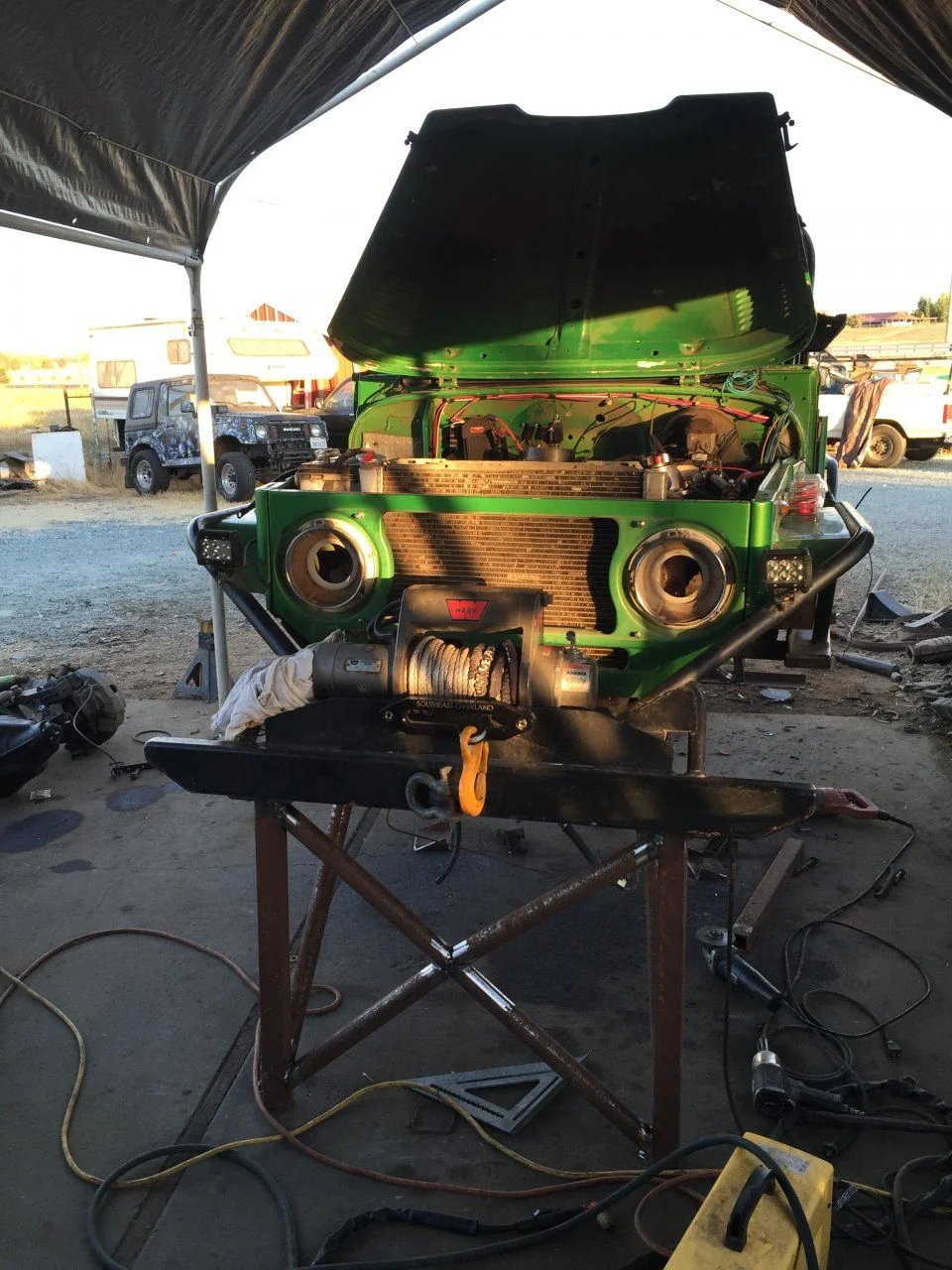

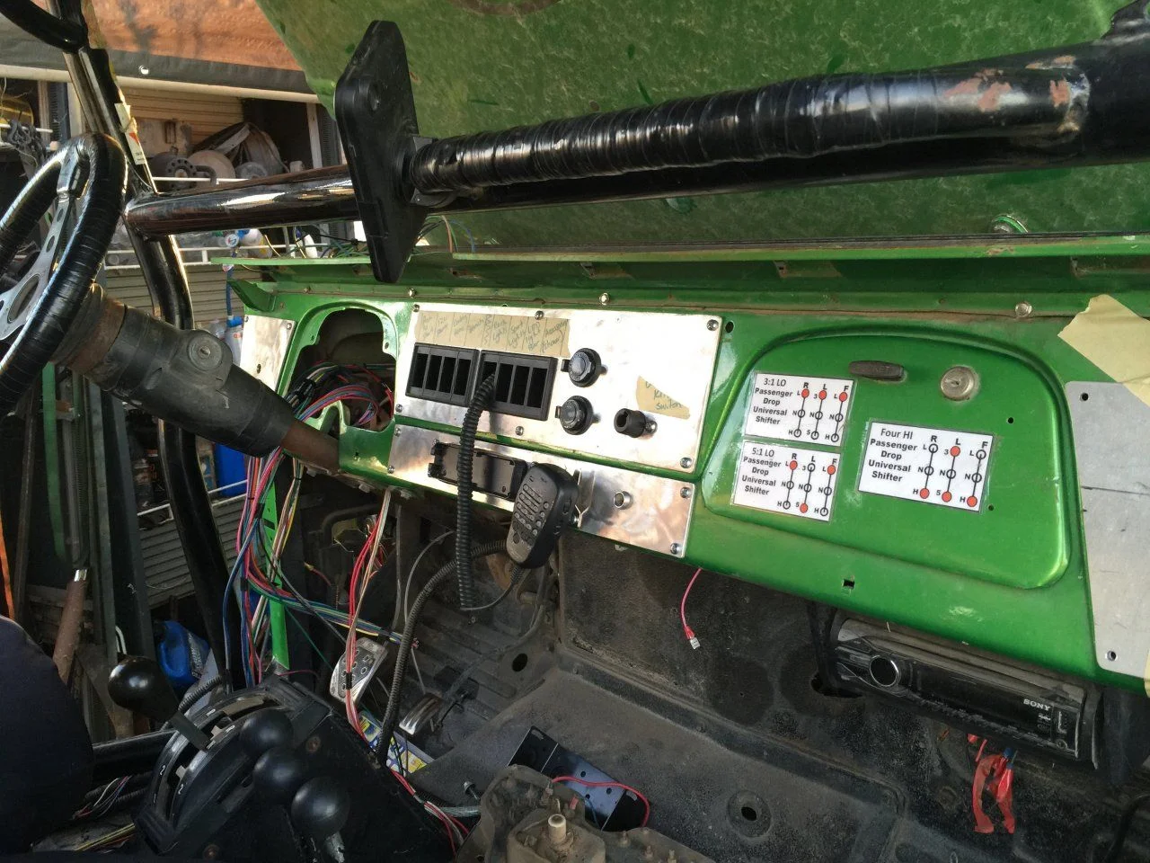

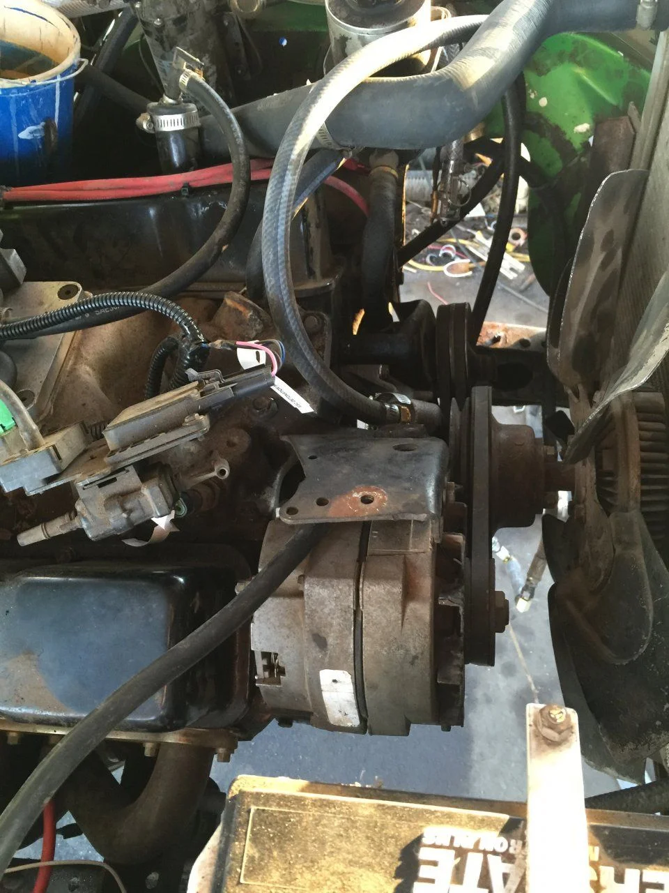

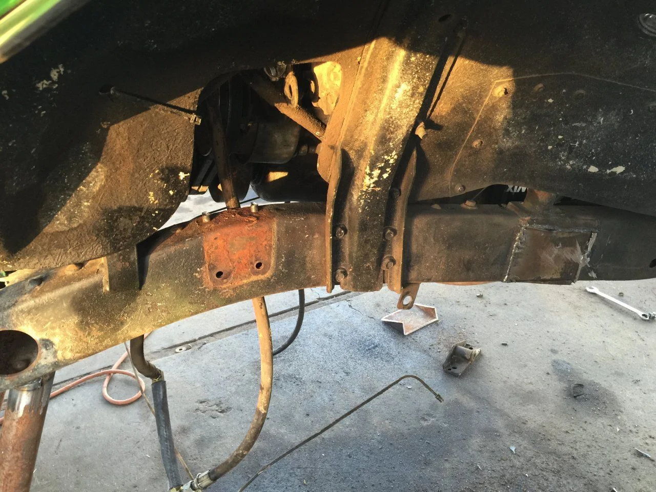

So today I spent some time finishing up under the hood, finished installing the panels inside, took out the headlights and cleaned up in preparation for new ones, etc. Mostly just little time consuming stuff I needed to get done before I head home. Bill started removing all the crap that's accumulated on the frame through many years of redneck engineering. There is a lot to do there. He also build stands for the truck. It was on jack stands previously. However, when Bill Stayner says "this doesn't seem safe" you know to run. FAST.

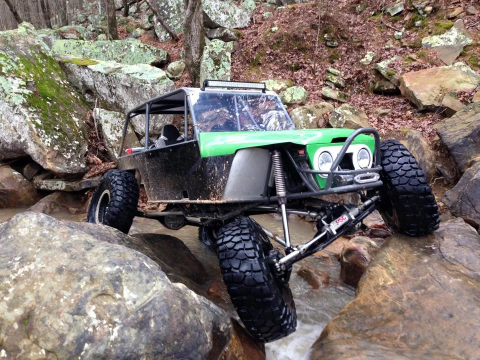

Me too, obviously. I wheeled with some friends at Clayton and Round Up and watching the ORIs work sold me. This is Ryan Busa's buggy he built.
So when I looked at ORIs vs. a good/very good coil over system these just seemed to be more straightforward. And honestly, the cost wasn't that far off when you looked at getting all the parts you needed for coil overs vs. basically just these. So no bump stops, no limiters, no sway bar, etc.
Maybe I'm just justifying the purchase, but it seemed like they would perform better, install more simply, and cost about the same $$ at the end of the day.

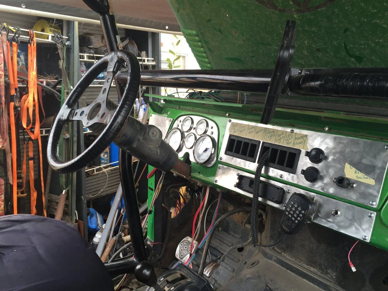

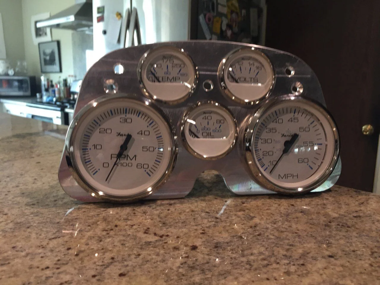

FYI...yes I know these are marine. I won't be using the speedometer, because really...I'm still going 2 MPH. I plan on doing something else creative there.

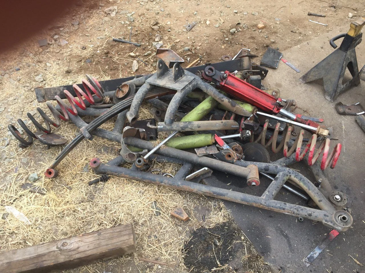

All the stuff pulled from under the truck so far
New dash. Now only thing left to do is wire it.

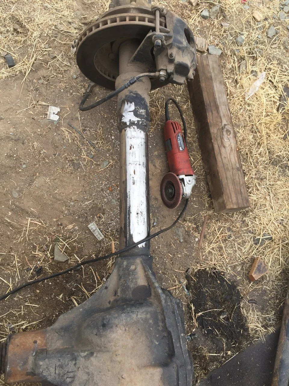

And I've been grindering...
