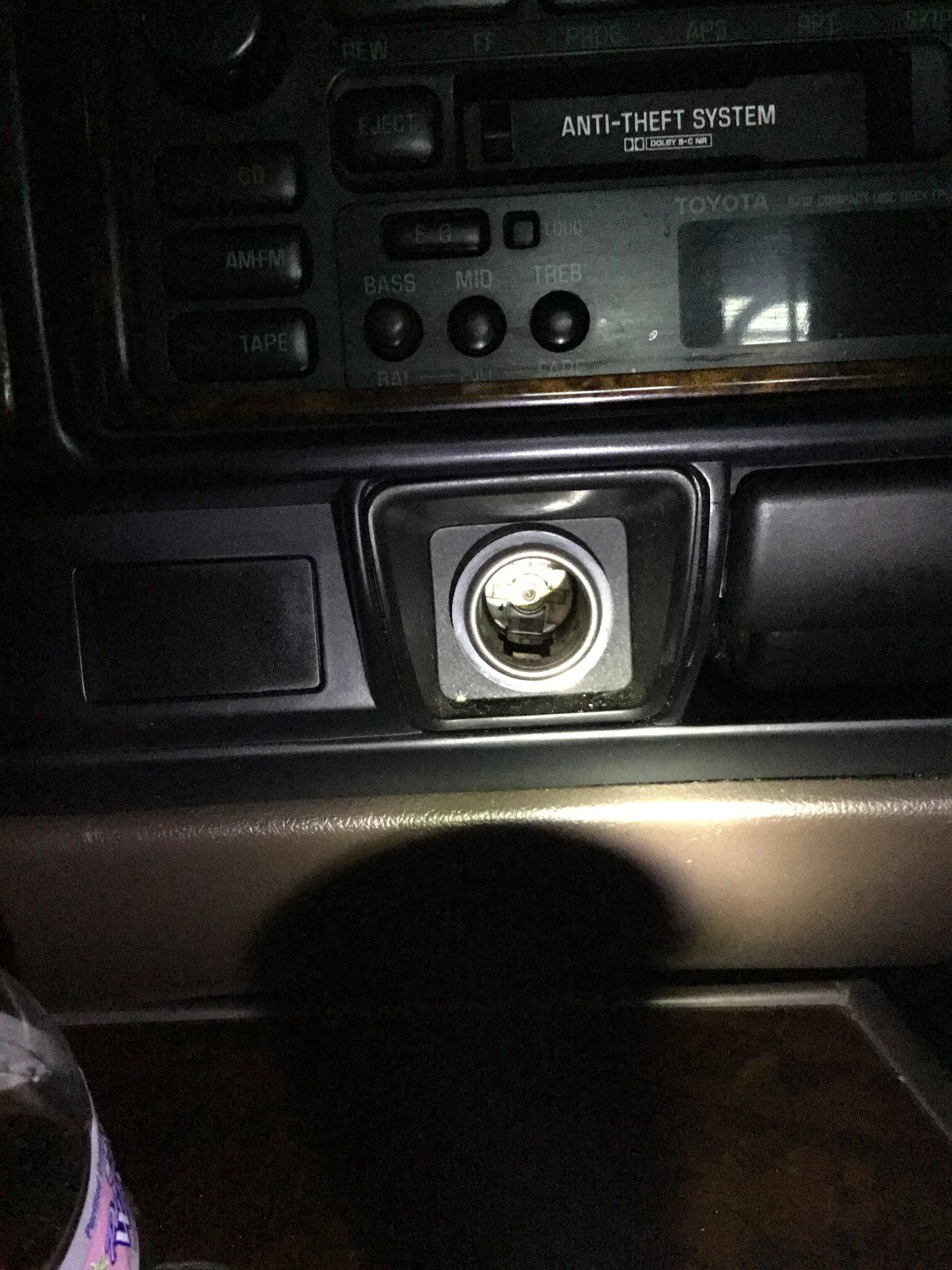

I'm curious if anyone has a quick fix (or not so quick fix) for something I'd like to change about factory settings with the cigarette lighter. I'd like to make an adjustment so that the cigarette lighter can still charge small items here and there when the vehicle is turned off. Seems like factory setting is that there is no power when the vehicle is off. Any ideas?

If the cigarette lighter heats up while you hold it in but doesn't stay in to heat itself up and then pop out automatically the retainers can be adjusted until it works properly. What commonly happens on these is that the metal retainers relax (due to heat cycling or overheating) or get pushed out by other plugs that are pushed into the socket. When they are stretched/relaxed the retainers either don't hold the inserted lighter at all or don't hold it long enough for it to fully heat up. If you over-tighten the retainers then you can cause the lighter to get too hot before it pops out so it may take a few small adjustments until you dial it in like you want it.
The "retainers" are down in the bottom of the lighter socket. There are two of them, on opposing sides of the socket bottom, and they pinch/grab the rim/tip of the cigarette lighter that you insert. The retainers have a bit of spring to them. To tighten them you can use a flathead screwdriver that you insert in between the outer edge of the retainer tab and the side of the socket. Once the screwdriver is in place twist the screwdriver to bend the retainer in towards the middle of the socket, thus tightening it up. Be sure that the socket isn't powered up or you'll likely short it out and blow the fuse. If you can't depower the socket and have it use a plastic flathead equivalent.
Once you peek into the bottom of the socket and find the retainer tabs and then look at the insertable lighter (with the sliding cover slid back to expose the tip) you will probably understand how it's supposed to work. You should then be able to bend each of the retainer tabs a little at a time until it works with little/time effort.
This is the correct fix for a cigarette lighter that will not heat unless held in. Thanks for this! I used a bamboo skewer to slightly bend the inner tabs. I think using phone chargers and gps chargers tend to get the tabs out of whack.
