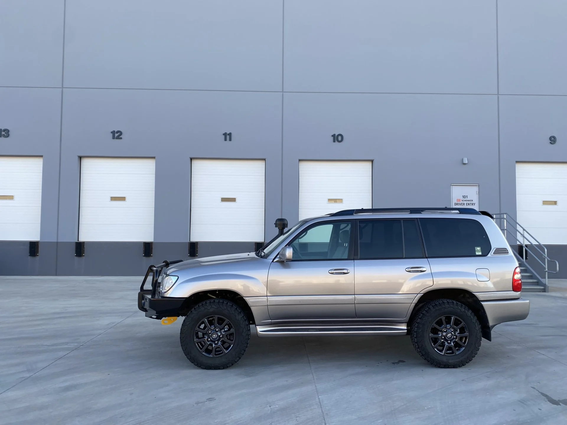

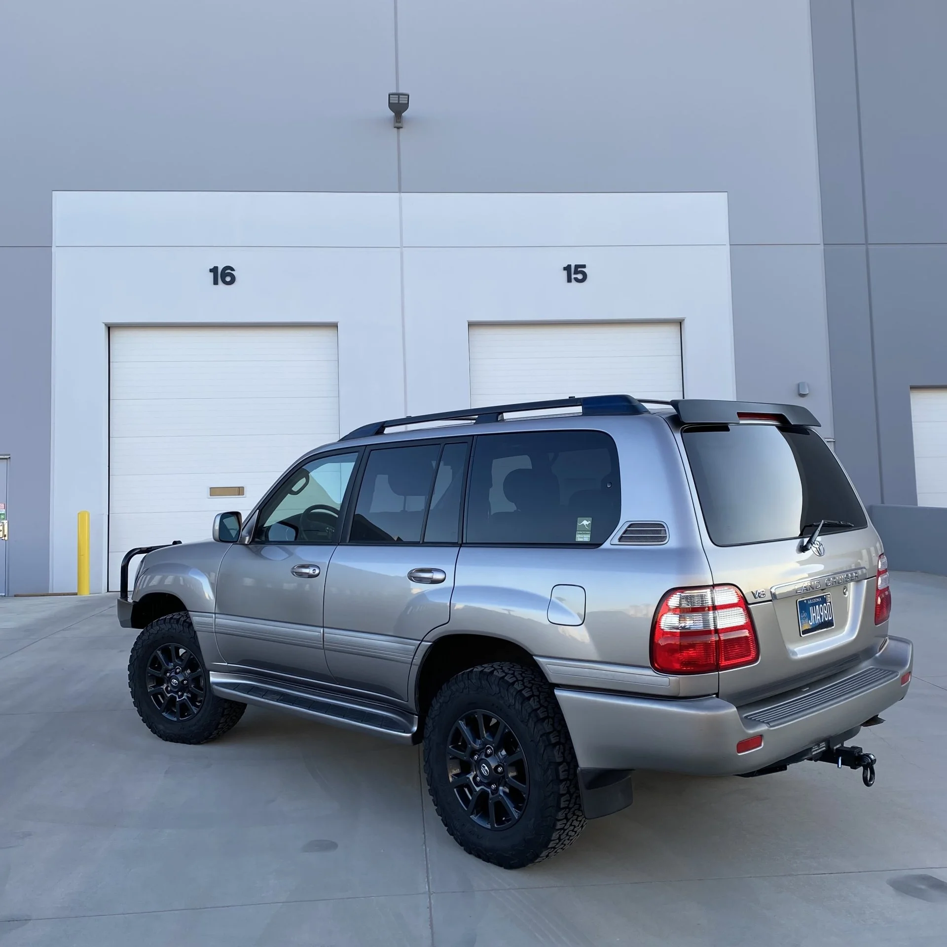

Wheels are 18” Mickey Thompson Deegan 38s wrapped in 285/70/18 Toyo ATII. No issues on stock height.

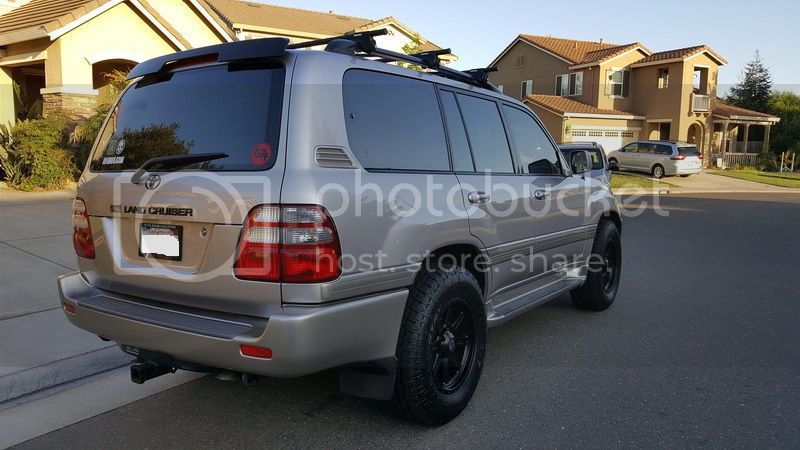

I'm running the 2021 Tundra Trail Edition wheels, which are 18" and finished in graphite. My tires are 275/70R18 BFG KO2s and I have BORA 1.25" spacers with an Ironman 4x4 2" lift, Stage 2. I regularly get compliments on my wheels, but I actually don't love the overall look. I think the rim face is too big and there is not enough tire sidewall showing--not to mention they're skinny. I've debated about increasing my tire size, but there's no denying that 16" wheels with fat tires barely hanging onto the rim look rad af on these rigs. Sigh...

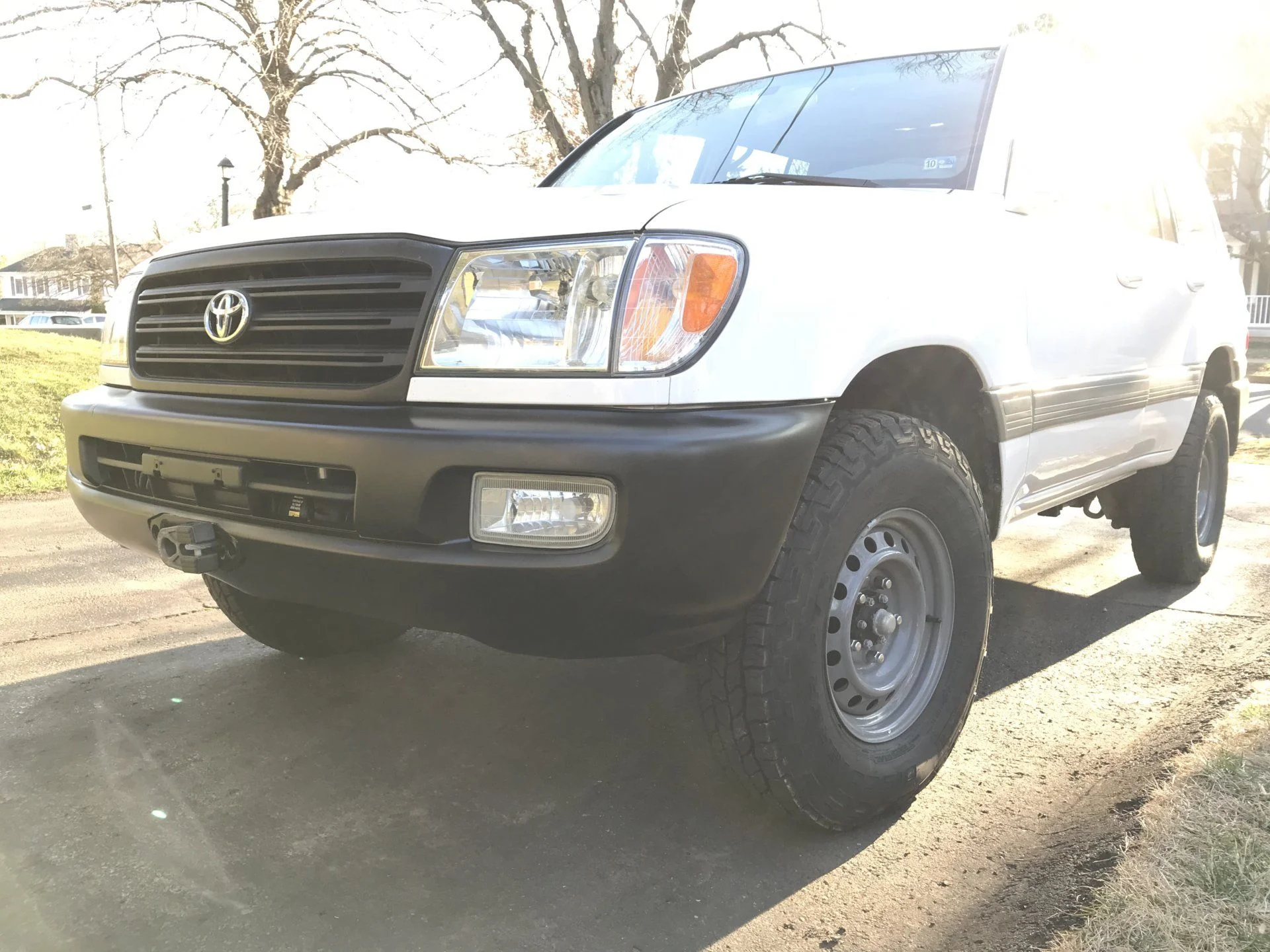

Sorry for the slow reply—I think you found me on Instagram and I might’ve answered there. But they’re 16x6 79-series take offs I got from Cruiser Parts…
Believe they’re part number 42611-60D30. They’ve been great—only wish they had a little bit of positive offset. (They’re 0 offset).

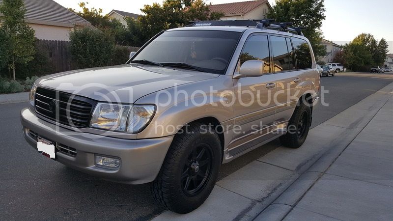

275/70R18 2000 LC.
