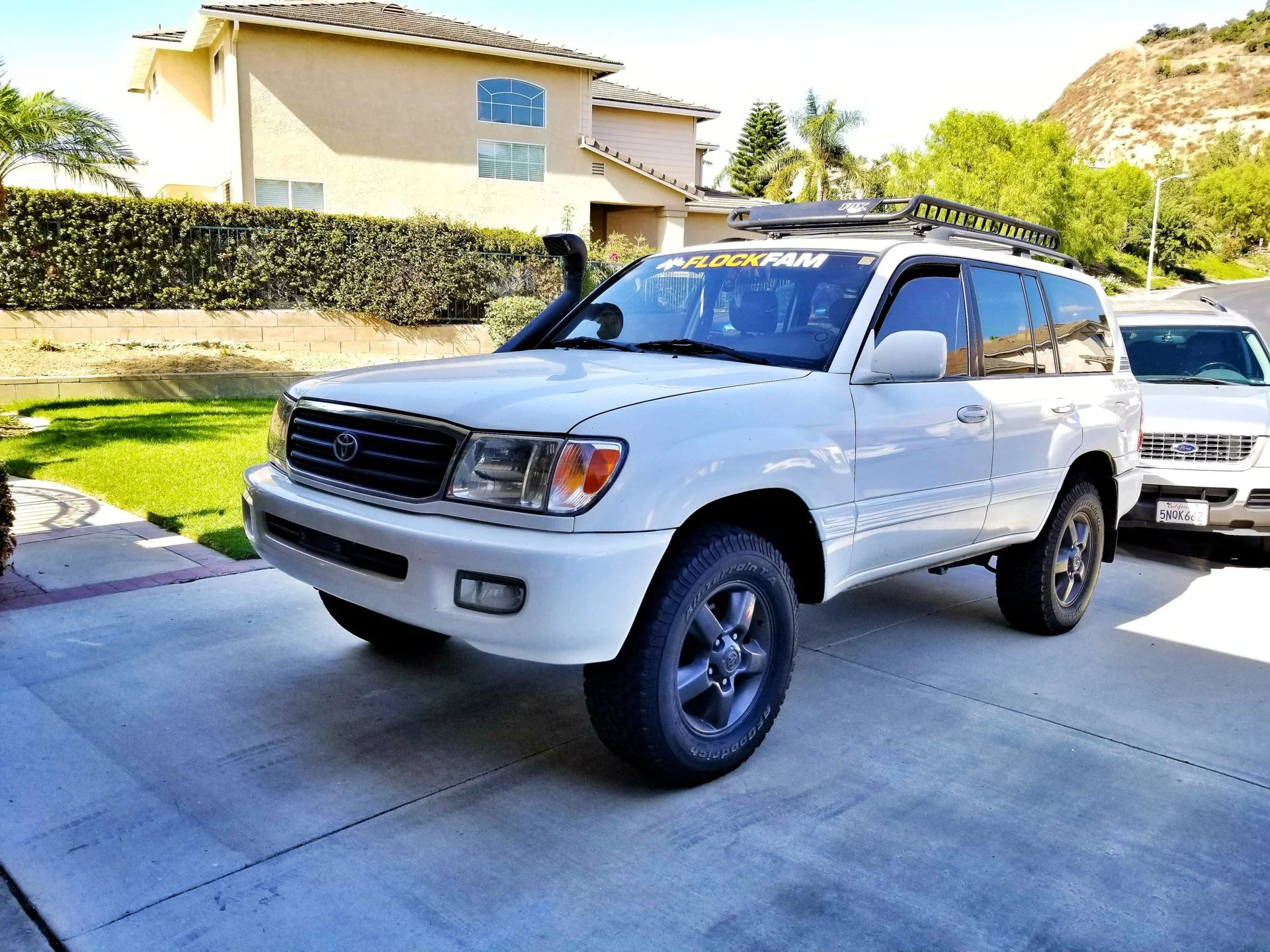

Keep 16inch wheels or get 18s?
I think your perspective on how big an inch is may be off a bit. 18s are not quite in the "homeboy" class. Ya really gotta have a 2 in the front there - 20s, 22s...
These are 18s. Not likely to see this wheel/tire size combo on any Escalades... homeboy ;)
Homeboy right here!! 20s!...
18's aren't going to hurt you offroad. Also, if you plan on keeping your 100 for a while, wheels/tires are only getting bigger. I feel the 18's make the overall look of the 100 newer. Sidewall flex is a real issue offroad, but with proper tire pressure along with good tire selection and I wouldn't give 18's a second thought.
I do agree you usually down grade your quality of wheel with an aftermarket wheel... OEM is VERY high quality.
Never seen those bad boys! What are they?
Thank you!! They're Black Rhino sproket wheels. They're 18x9 +18 offset
I went factory 18s since I daily drive a lot and it feels a lot less boaty on the road than 16s, but 16s for a dedicated offroad rig for sure.
I swapped from 16s to 18s tundras and they feel a lot better on the highway. Truck felt floaty before but now it's nice and tight, looks better too.
Powder coat the stock 16s, especially if it isn't your daily. Don't put those aftermarket black wheels on either your or your dad's hundy, they look awful. Stock wheels are forged and stronger than any of the cheap aftermarket wheels.
If you're going to off road, keep the 16". If you're going to do more DD, go with the 18".
I REALLY like the look of the 16s with 285 75 16 A/T tires..I've decided to stick with the stock alloys and just get them powedercoated.
