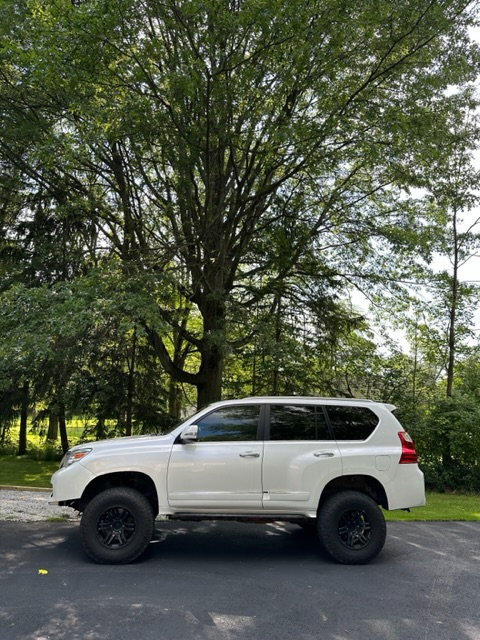

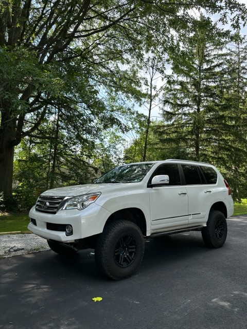

finally got the OME 886 springs on. thing rides like a dream! should have put the heavier springs on in the first place. body roll is much improved. definitely feels more planted now with the stiffer springs and wheel spacers in the absence of KDSS

thanks! defintely not a replacement for KDSS, but $500 total instead of $7000 fix on this this old turd is definitely worth it to me. If I had a longer commute or spent more time on the highway or anything that would cause concern driving without the system I would maybe reconsider
