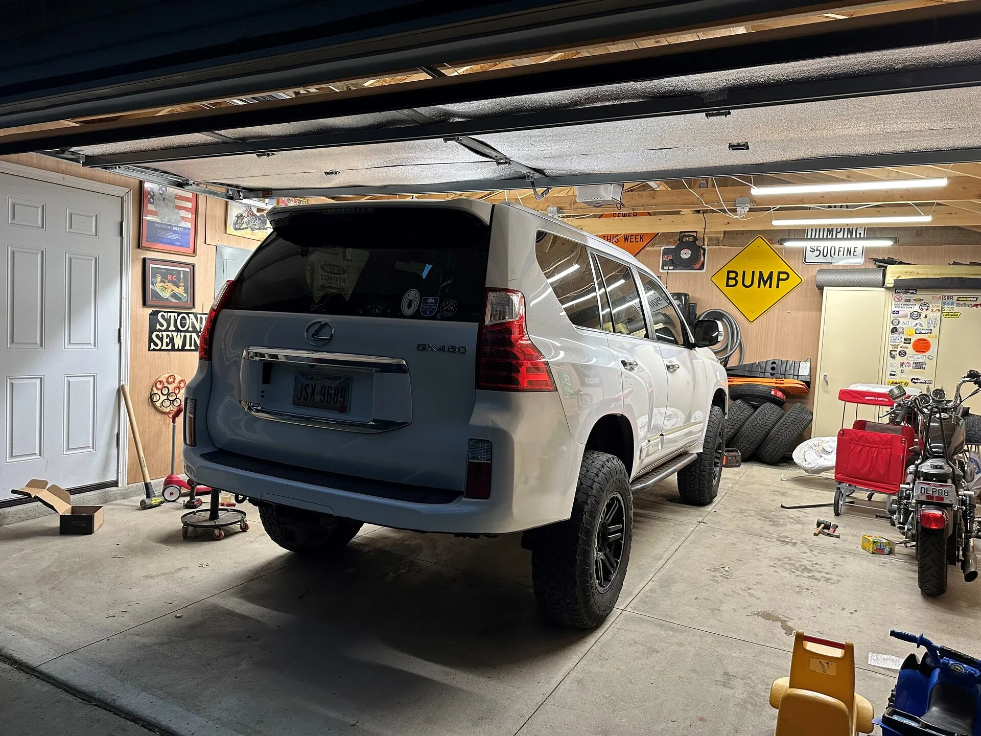

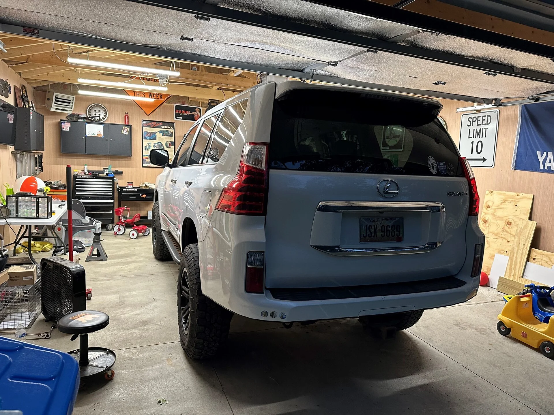

I did get the Spidertrax 1.25" spacers on front and rear this evening. Took it for a little spin. Seems more planted from my butt feel going around some round abouts at speed, slamming on the brakes, and taking some quick turns - but could all be in my head haha. OME 886 springs have been ordered and hope to get those on in the next few weeks to replace my 885s.
Looks decent with my 255/80r17 skinny 33s. Looks like I will have some rubbing on the cab mount on full flex, but very minimal. Will flex it out tomorrow and see. Hoping I can just grind down the cab mount a bit rather than needing a full-on chop.
