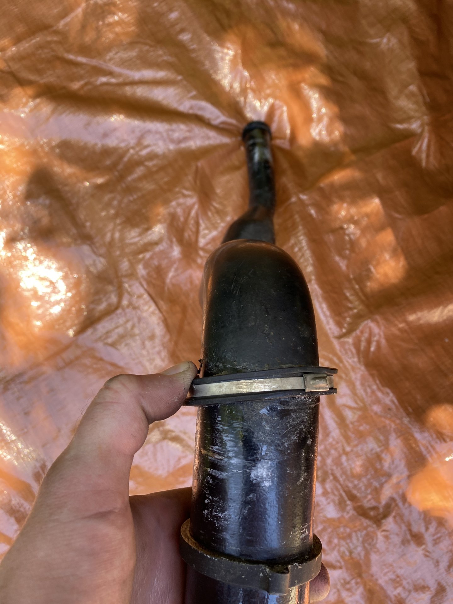

OP delivers. Took lunch today to check the sway bar and take some pictures.
it doesn’t look like the sway bar is terribly off kilter. Maybe it isn’t a kdss issue (hopefully).
it looks like it could be a bushing, but not the bushing you might have guessed. I’ve replaced the 4 bushings on the various sway bar connection points.

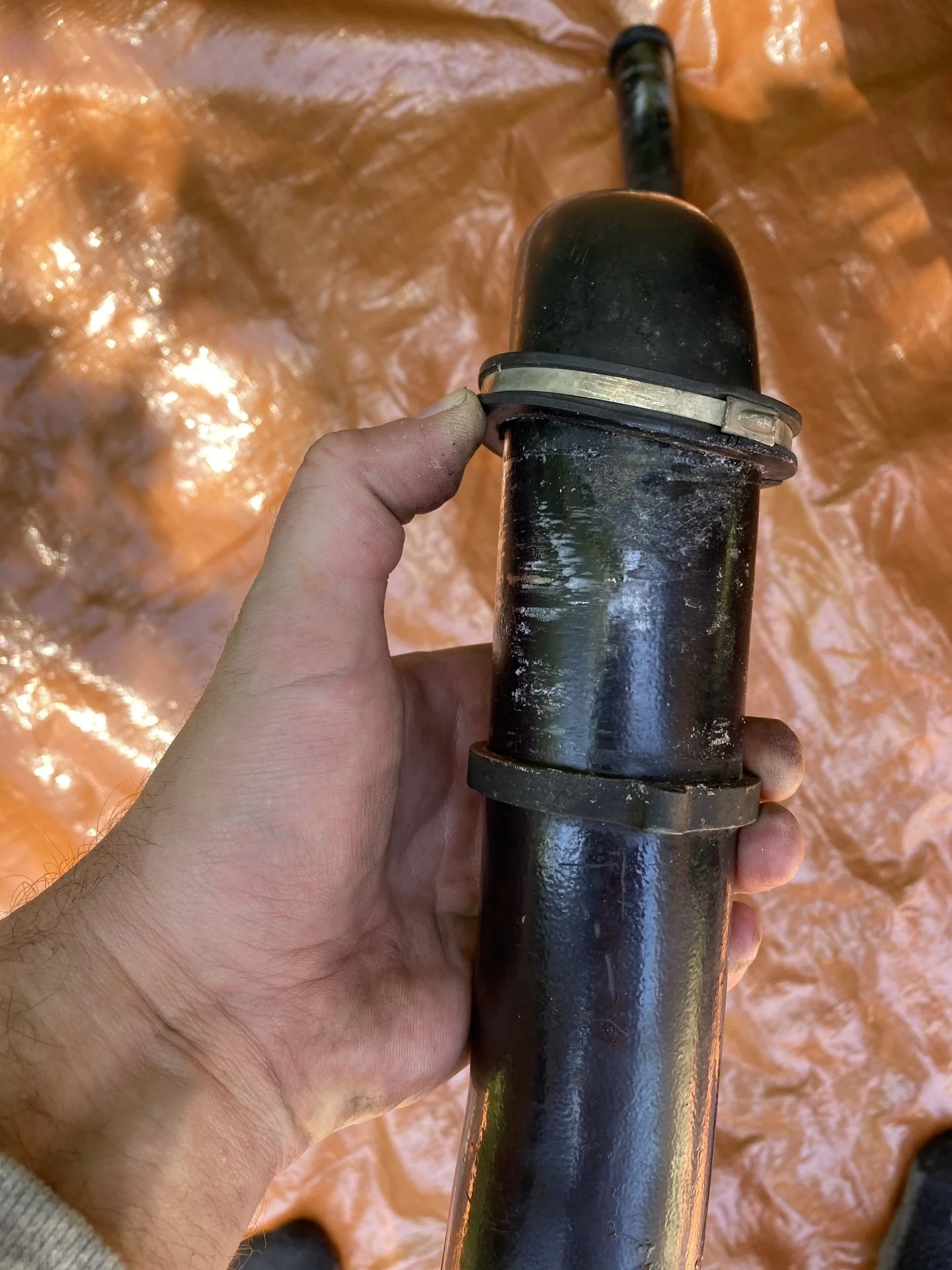

on either side of where the sway bar attaches to the fixed link and the kdss piston, there’s 2 “bands” that look like they’re supposed to help keep the bushing in place (from sliding to either side). The inner ones look solid. The outer ones are rubber rings with a metal zip tie / clamp holding them in place.
the one on the fixed arm has a lot of play! See the pics. Anyone know if this can be replaced oem?

Well that's interesting. I would have expected it to be two metal rings to keep the bushings in place.
That looks like a CV boot clamp, so you can absolutely replace that with another CV boot clamp of the correct size. Most good auto parts stores like Napa have an assortment of sizes. Then you'll need the correct pliers to crimp it.
Or... just use a stainless steel hose clamp!
Random hose clamp note: the "Euro" style hose clamps with the raised threads on the band are way better than the regular style with slots cut into the band.

Well that is fantastic news. Seems like an easy place to start. Figure I can remove the existing clamp and take it by O’Reilly’s tonight to check for a replacement.
Confirmed with Lexus they do not offer the rubber bushing and clamp as a part, gotta get the whole stabilizer bar. So hopefully the clamp replacement fixes this.

There's no way I would pay for a replacement bar, if anything I would get as creative/custom/ghetto fab as needed to make a replacement clamp solution.
Heck, even a metal shaft collar would work and be a significant upgrade *IF* you could find one the exact inner diameter as the swaybar's outer diameter.

for now I’m gonna try a new clamp. If it holds? Perfect! If it holds at least for a little bit before slipping? At least the cause is identified. If it doesn’t hold at all...back to the drawing board, lol.

I would be worried about potentially compromising the structure of the bar with a file, if the edge digs in a bit. Sandpaper would be a good option though.
If whatever is clamping onto the bar has minimal gap and full contact around the bar, a light coating of RTV would also help hold everything in place.

I don’t have a file, but I have everything else. So I think I’ll clean the sway bar, spray paint to touch up the spots where the paint has worn, and then do some very light sanding where the loose bushing goes. Finally, apply some rtv and clamp down the bushing.

You got it, a very light coating of RTV between the clamped-on bushing and the swaybar could help hold on it in place. And if it doesn't work it's easy to clean off.
