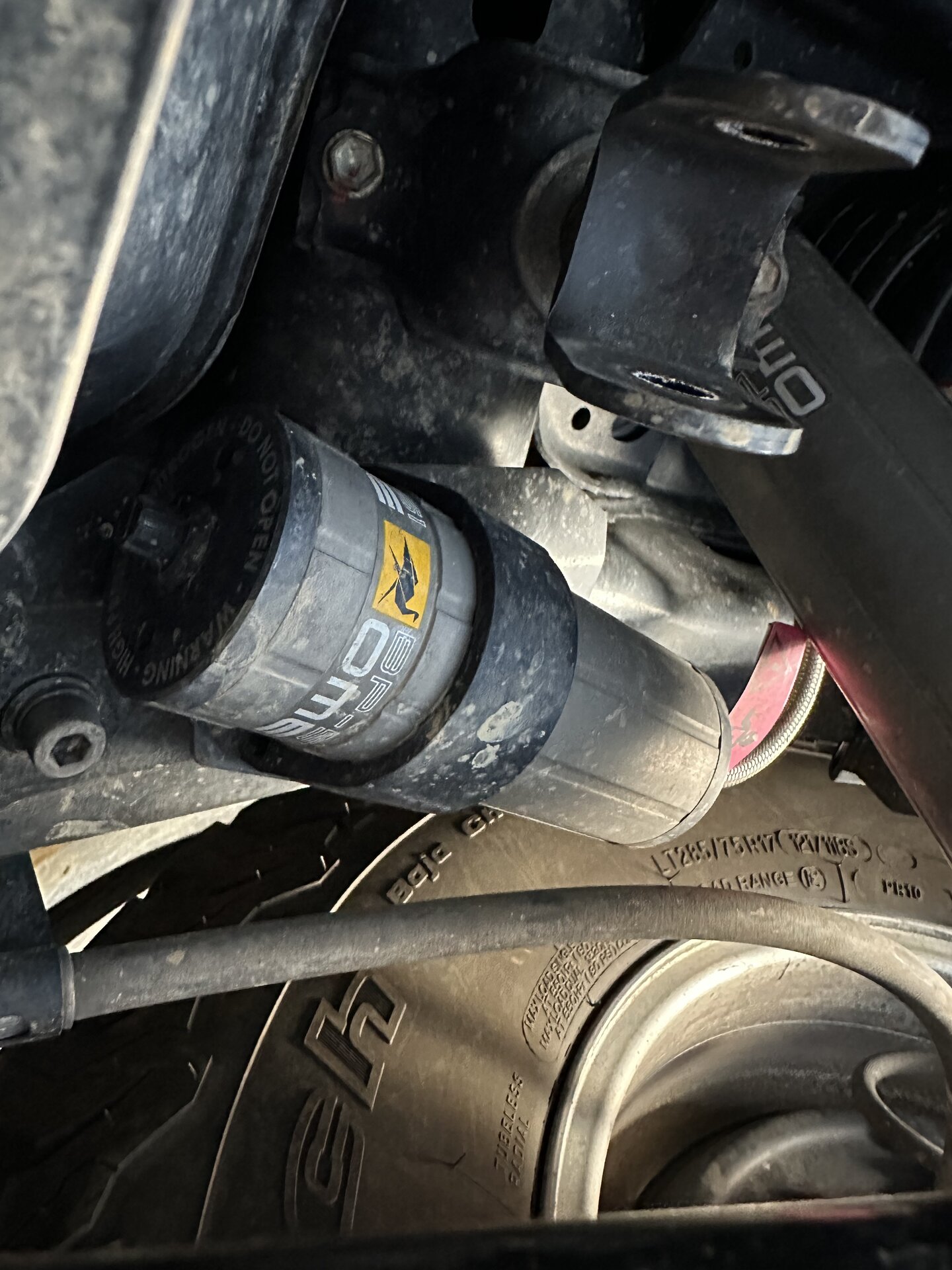

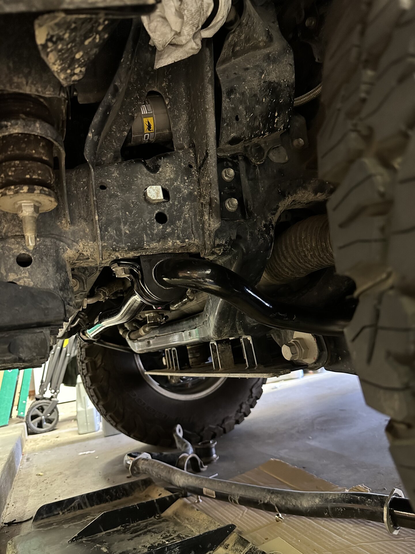

I decided to take another small bite of elephant today. I went ahead and installed the OME reservoir brackets today. This required installing the stabilizer bracket and links as well. Clocking of the shock is required to get the reservoir hose to clear of all the things.
Right side with KDSS stabilizer link and old reservoir bracket. The mechanical bar bracket and link gets pushed out to the frame rail vice slightly onboard as shown here.
Right side comparison:
New hardware installed:
The non-KDSS reservoir brackets are so much easier to install than the KDSS variants.

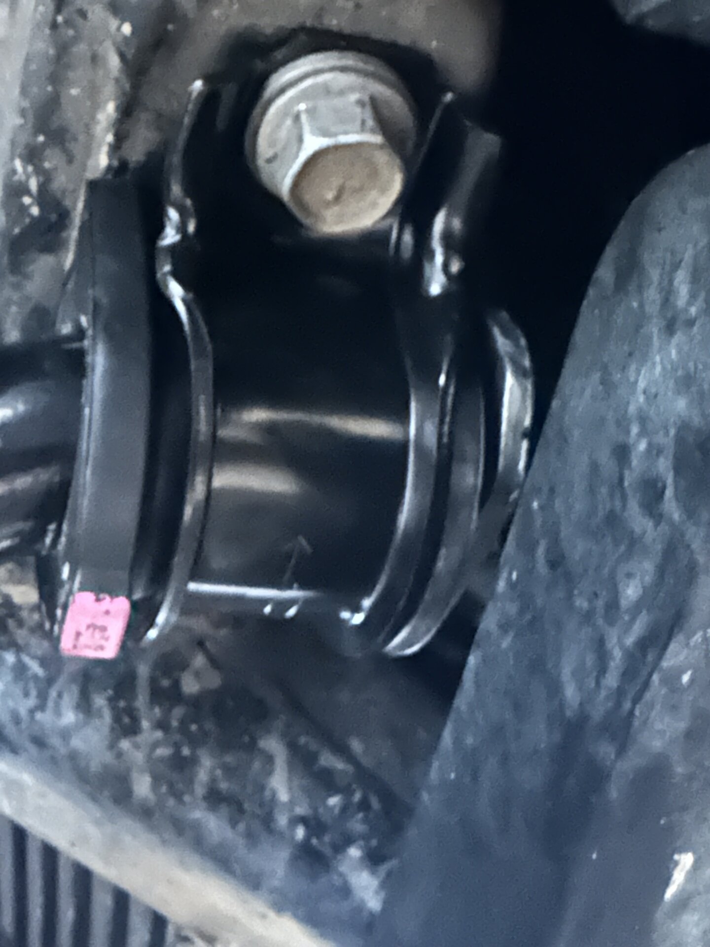

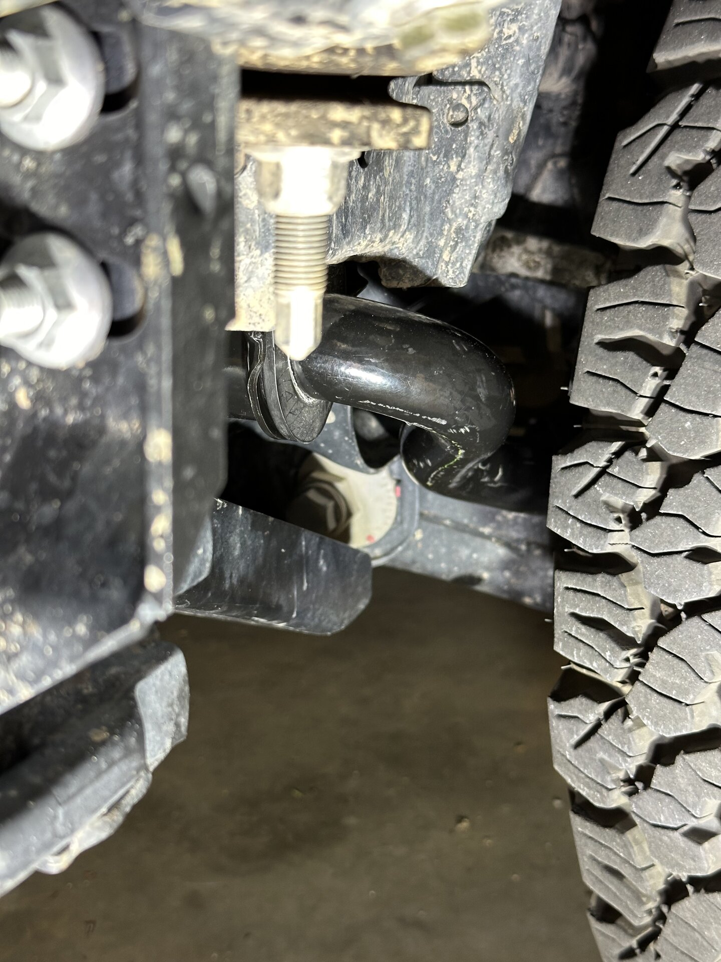

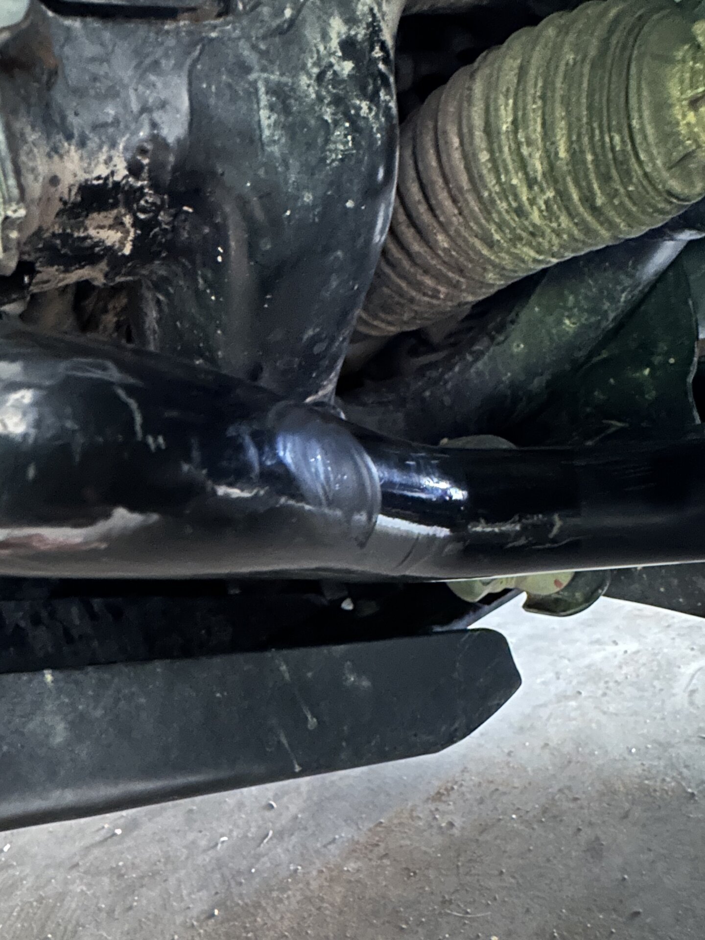

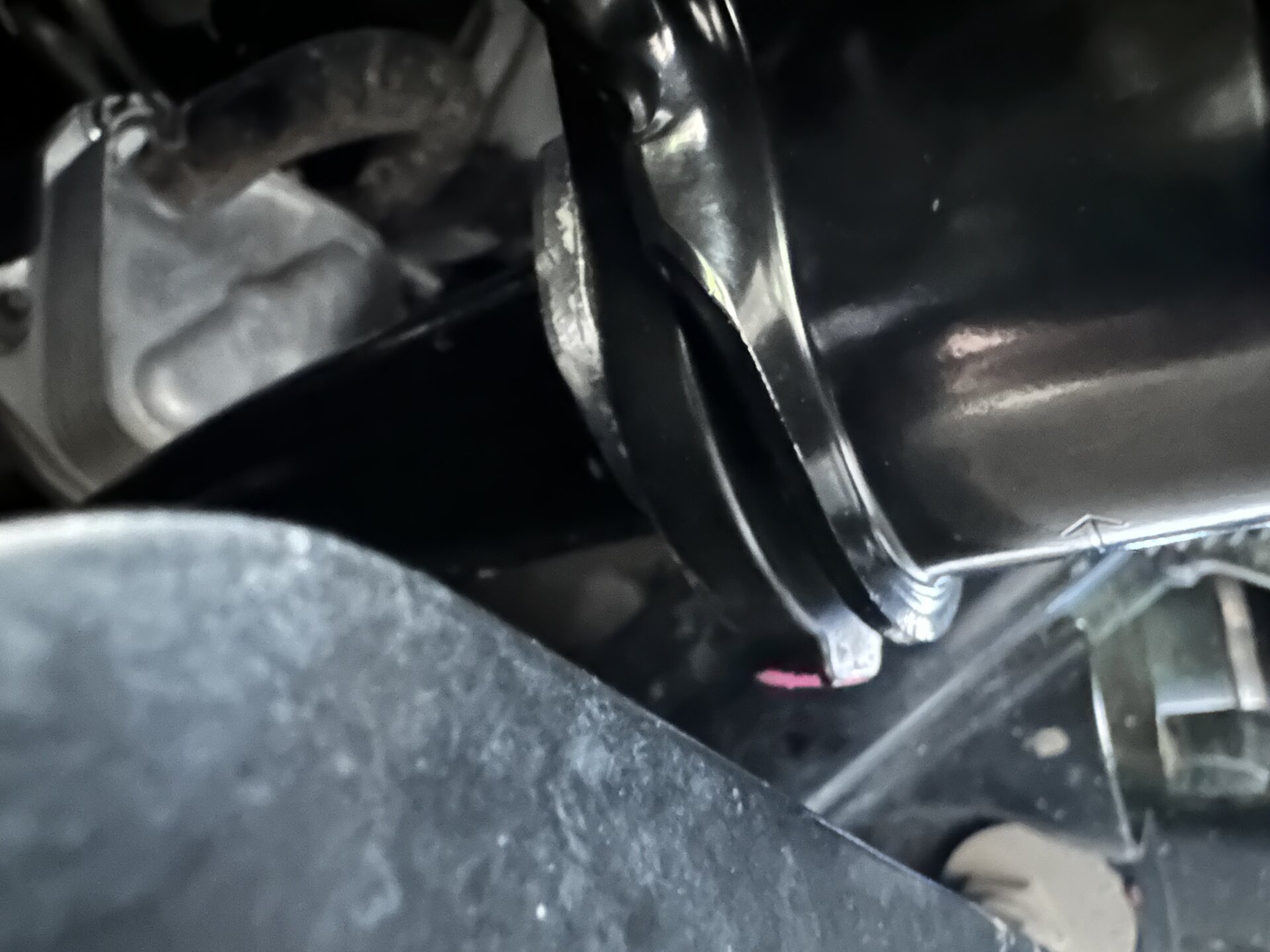

I now have a tire rub on the passenger (right-hand) side stabilizer bar that is worse than the polishing I had on the KDSS arm. It only manifest at full lock turning under braking ie. turning into a parking spot. :meh:
Is the swap bar perfectly centered? Wondering if you could shift it 1/2" or something if that would help.
I thought about that too, but I don’t have any slop between the centering tabs on the bar. I’m really curious to see if the vehicle dynamics change enough with the rear bar on to eliminate the rub. I can get the driver side to rub enough to feel it when doing a u-turn into an incline to the right.

I had that type of rubbing before I did the KDSS relo brackets. I know you’ve just removed KDSS as part of this and I’m not real sure how it all mounts up but can you push the bar forward in a similar fashion?
Absolutely, and the same terms and conditions regarding the links would apply.
I have a set of the Slee brackets in the garage. I should mock those up for ‘Mud to see.
Without needing to clear the tight kinks in the KDSS arm you may be able to make brackets that move the bar but not as much as usual, thereby cutting down on the link alignment issues.
Install the KDSS relo and mount your end links outside the LCA like I did. Works great, end links are at a sane angle, and no rubbing on 35s
Both are reasonable options, but I’m not terribly investing in running a front bar. Maybe my opinion will drift over time, and I’m not afraid to try something new!

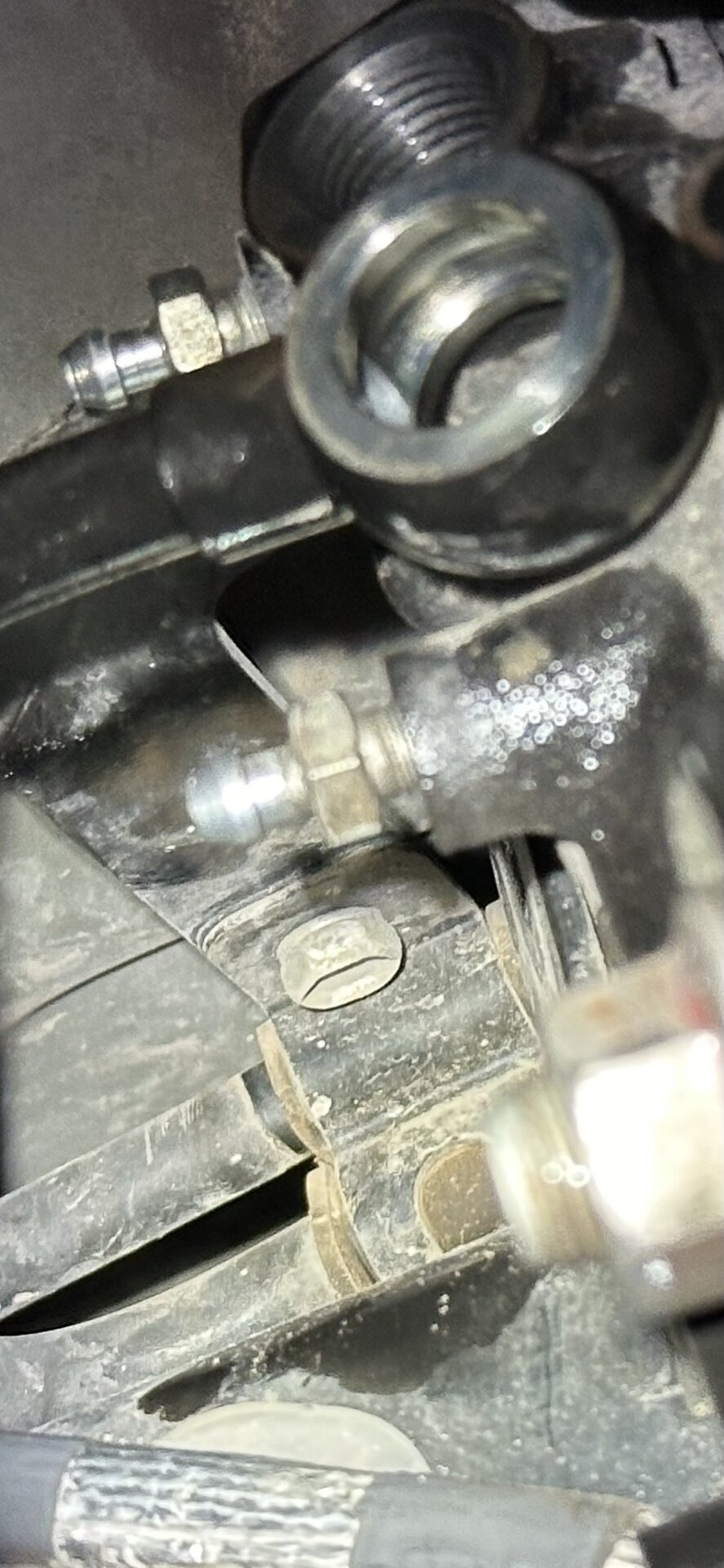

One unanticipated step I have encountered is disassembling the parking brake. They were do for an adjustment anyway.
Post-Op Feedback
Having studied the service manual extensively before deciding to do this, I was a bit frustrated when I stumbled into the parking brake. That turned out to be a bit of a time suck during reassembly. I didn’t have the tools on hand to deal with the bigger springs.
