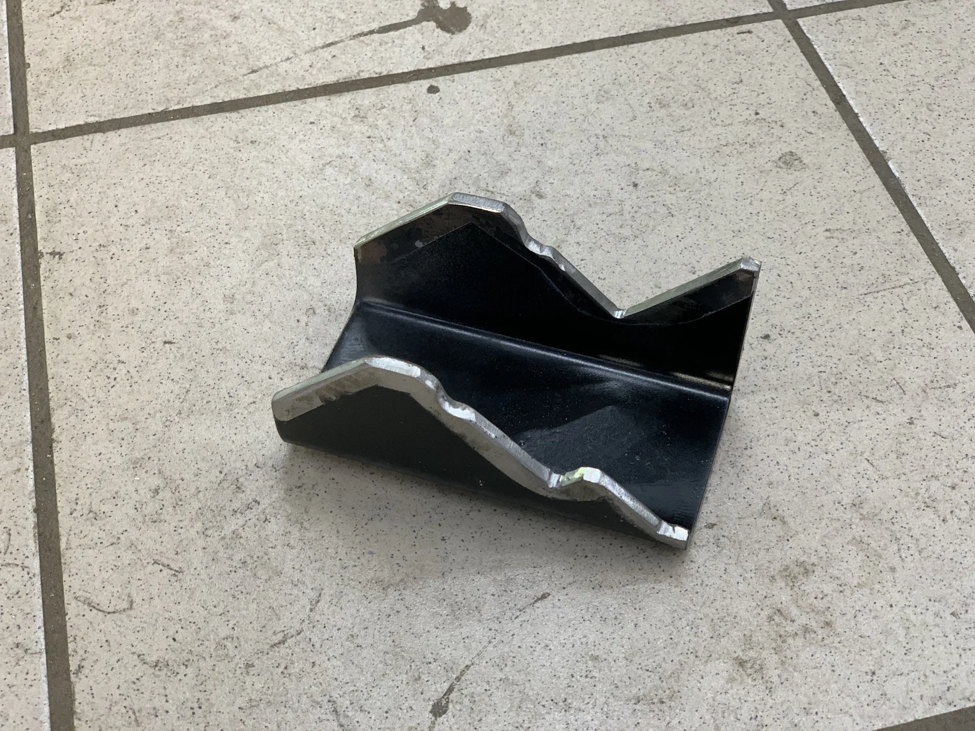

I'm putting serious thought into a KDSS delete on my 2010 LC , I deleted the X something hydraulic shock system on my 07 runner and never looked back. My question IS,,,, does ANYONE make the needed bracket for the driver side bar mount for the rear axle?? Maybe EIMKIETH (sp?) or another fab guy? I would rather weld a bracket to my axle ( I've done this plenty building hot rods) than shell out the long green for a whole new axle housing. Just a thought, Mitch. Thanks.....
I can see a market for this and @eimkeith skills and business seem to be a good fit this type of product
Here you are, the rear stab bracket to be welded onto the rear axle:
h = 130mm, the text says - "in situ with the stabiliser installed, through its bracket's holes"
From here (open with google translate): KDSS досвидания! - https://www.drive2.ru/l/503846256699769851/
Another good one: Удаление системы KDSS. Ставим рычажный стабилизатор от Lexus 570. Подготовка TLC200 к 35" колесам. - https://www.drive2.ru/l/551295955874349069/
DVA, Thanks much. Let the fab work begin !!!
