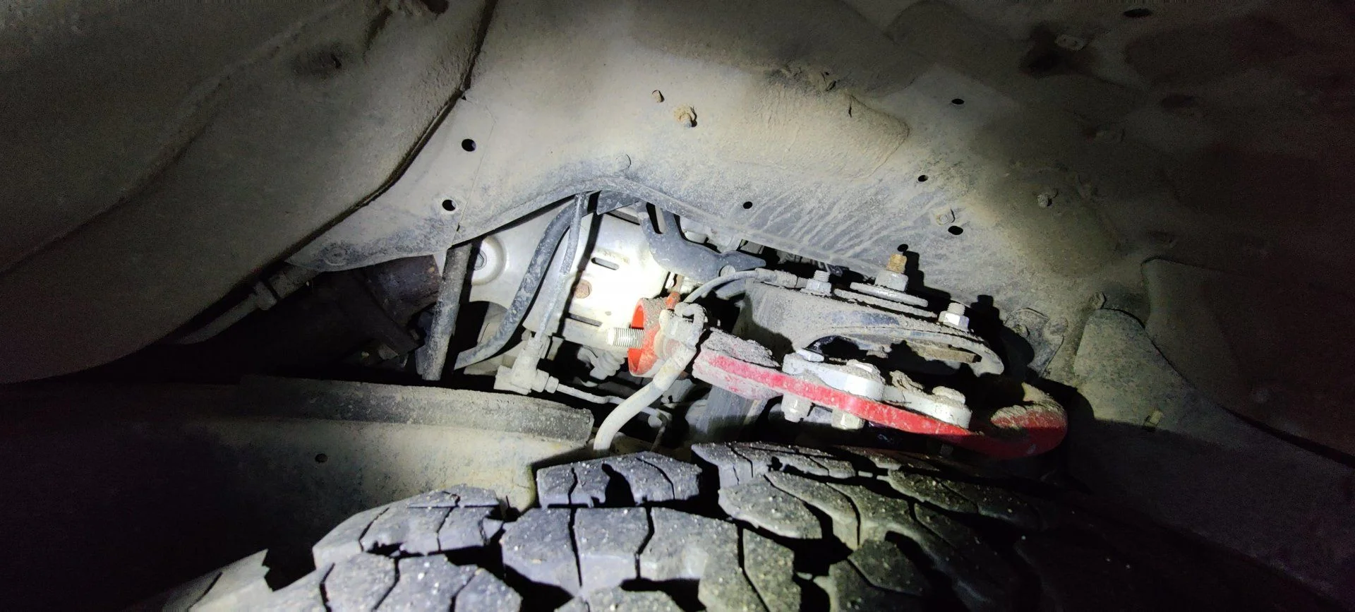

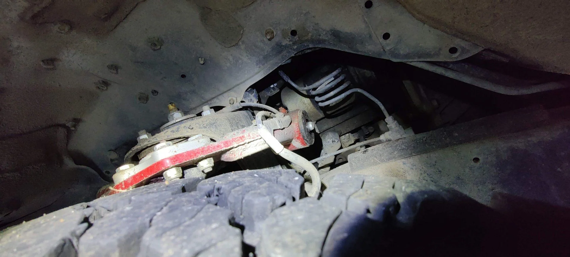

Good to know on both the amazon kit and the upper arms. How did they ship the arms to you? Duty extra? They look like the ticket for sure. Guess I better start saving...
Still leaves you with the knock. Hmm. Wonder if techstream could tell you anything about what the engine is doing? I haven't tried hooking it up to my 1KZ yet. Yours is even more advanced - maybe it could provide some feedback in terms of running parameters? I'm not sure.
$720CAD for the pair of jba UCAs + $90CAD to DHL for duties once they were at the border. Shipping was fast. Pretty expensive overall. I'd try and go for a cheaper option in hindsight.
Even tho the UCA's have the UBJs pressed in, you still need to press in the UBJ adaptors on the spindle. So its the same amount of work unfortunately. I actually ended up paying someone to press the adaptors in as my little ball joint puller coudnt do the job.

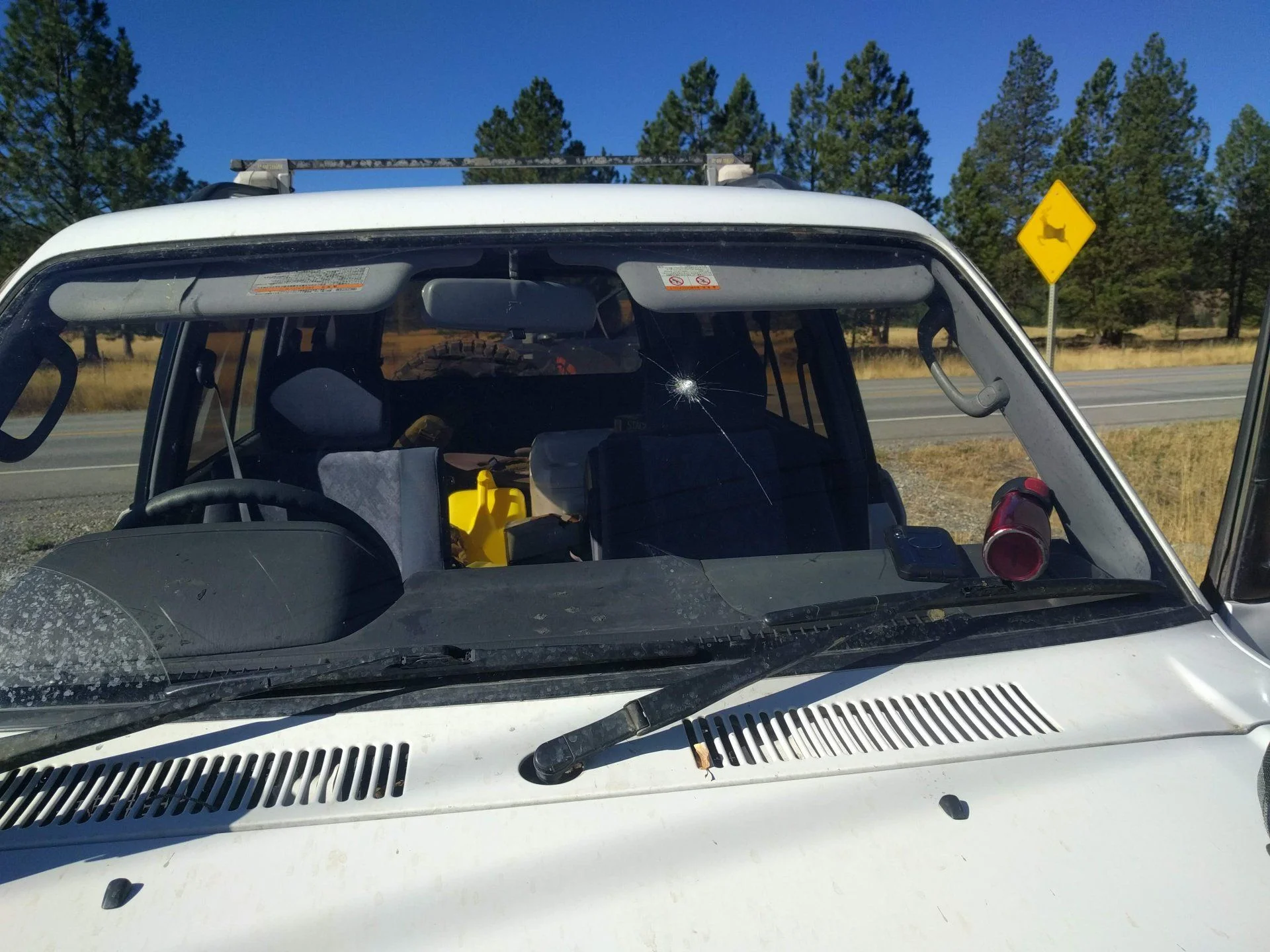

Then, as we were driving back leisurely, a goddam boulder came off a truck from the opposite lane. Almost shot my buddy in the face. Good thing he was wearing sunglasses as there was dust-size pieces of glass everywhere.
I went to
ProSight Auto Glass
230 MacKay Rd, North Vancouver, BC
They took some pictures, handled all the insurance paperwork and told me to wait a while as they figure out where to source the windshield. Their database was saying they had a windshield in stock, but it turned out to be for a sports car. Then, a Toyota dealer in California was claiming to have a windshield in stock, but for some reason kept delaying the shipment. Eventually I suggested to contact Rocky Mountain Imports and import a windshield thru them. Thats exactly what happened. ICBC mafia paid for all of it.
Price of the imported windshield by itself was 700$ CAD.
Also at some point when I was back in the city, just by chance I noticed the nuts of the long UCA thrubolts (installed couple of weeks ago) were gone. Very scary experience.
I ordered a bushing replacement kit from the JBA website as well the nuts for the North American equivalent tacoma from the local Toyota dealer. I made sure to use some threadlocker this time, as well as proper torquing specs (vehicle must be on he ground and have all its weight on its suspension for almost all torquing specs). So far so good.
