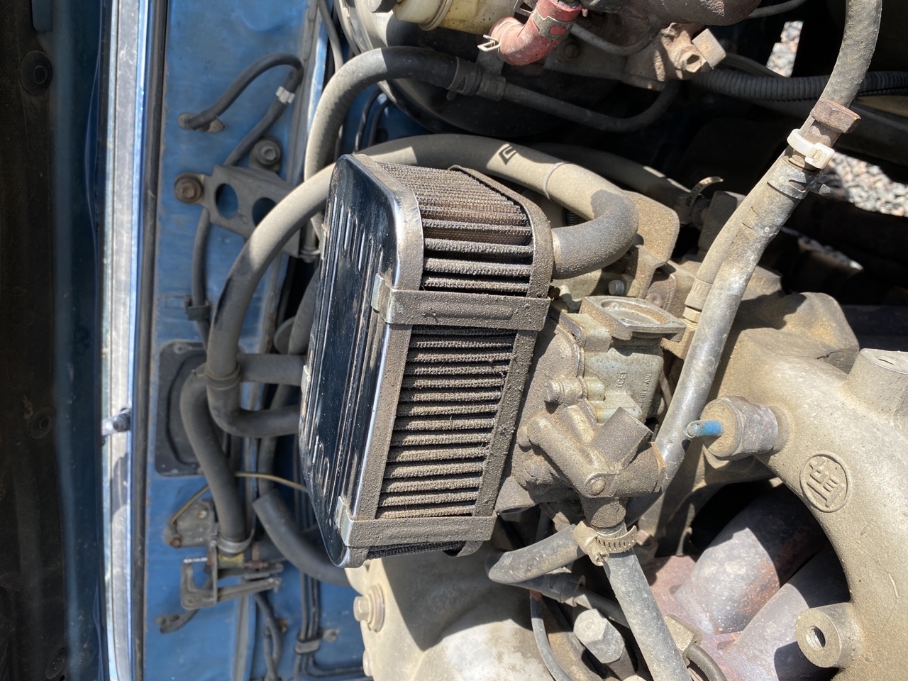

Hi all. Seems like time to clean the K&N air filter on my Weber carb. This is a relatively new-to-me ‘84 FJ60, but doubtful that matters in this situation. Anyway. Honestly I’m just not sure how to remove the dang thing. PO gave me the cleaner spray so I’m ready to get it spruced up. Can anyone provide some guidance to help me remove the filter for a cleaning? Thanks.
P.S. Sorry about the sideways pic.
Pop those clips off can see the two right in front there should be two more in the back and supposed to be one on each side too but dont see them. Not surw if they make a prefilter for that filter if they do i would recommend installing it with all that dirt/ mud all over the filter.
Sorry looked closer maybe there are not one on each side thought the last one i worked on had them but guess not.

Got it off and cleaned, thanks. Good to know about oiled K&N filters. Like I said, came with the truck so I’m not really sure. I’ll see what other options are out there.
