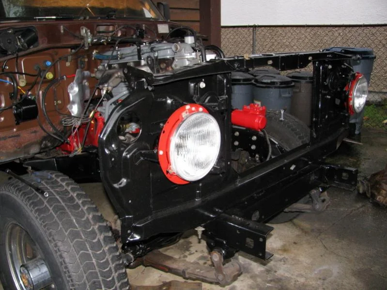

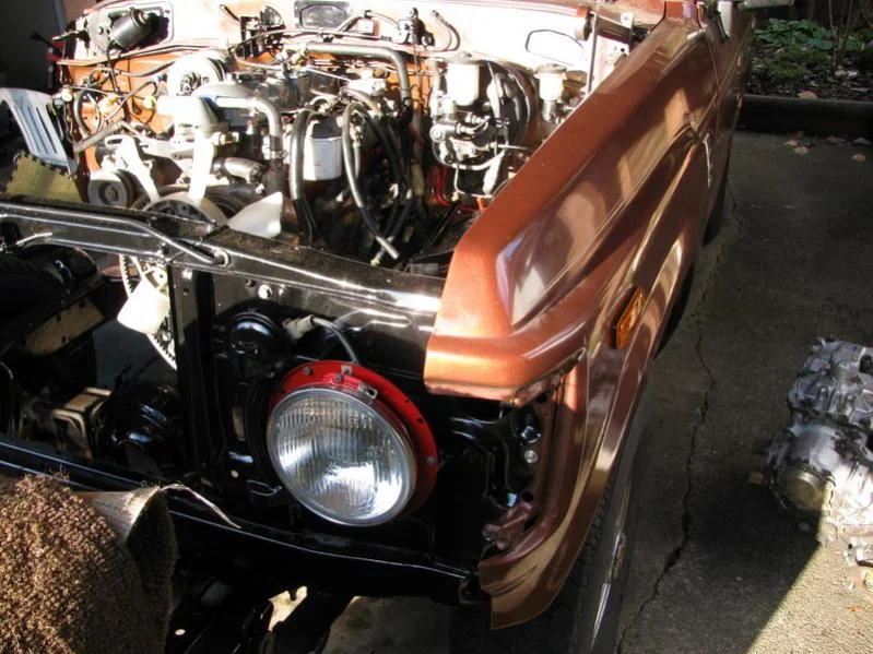

Front clip now installed and driver’s side inner and outer fenders are now in. The inner and outer fender did not want to bolt together very nicely though! When I originally removed them I noticed that there were several bolts not in place because some of the holes were not lined up. It looks like it may have been in a fender bender at some point as the inner fender had the Toyota part number sticker on it still.
Anyways! I wanted to bolt the outer fender to the inner fender (as well as the body) with all the bolts! Someone had previously already enlarged a few holes to try and make it fit but they must have given up. No giving up here! After taking the outer fender on and off several times and with the help of a die grinder I got all the bolts on properly, I then painted wherever I had grinded. The outer fender was sprayed with fluid film all over the inside before being installed (this will be done to the passenger side as well).

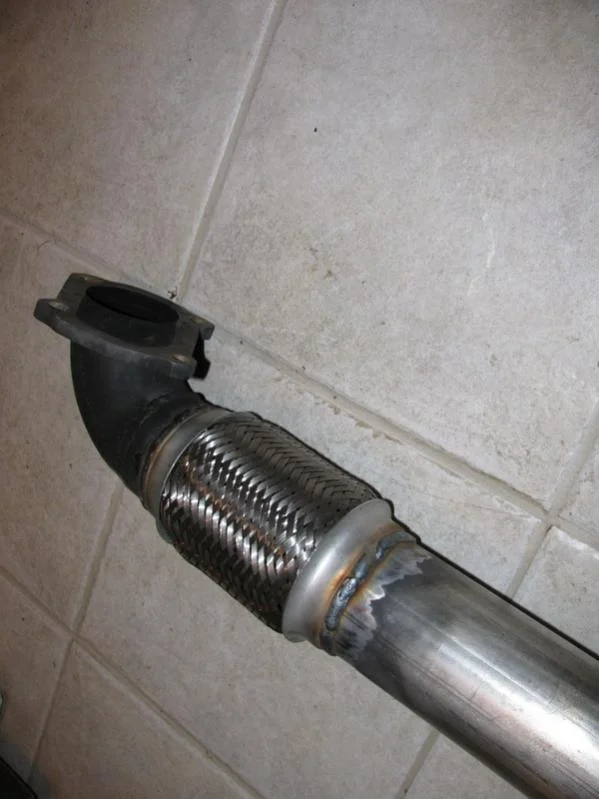

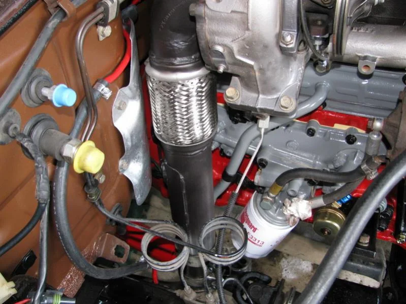

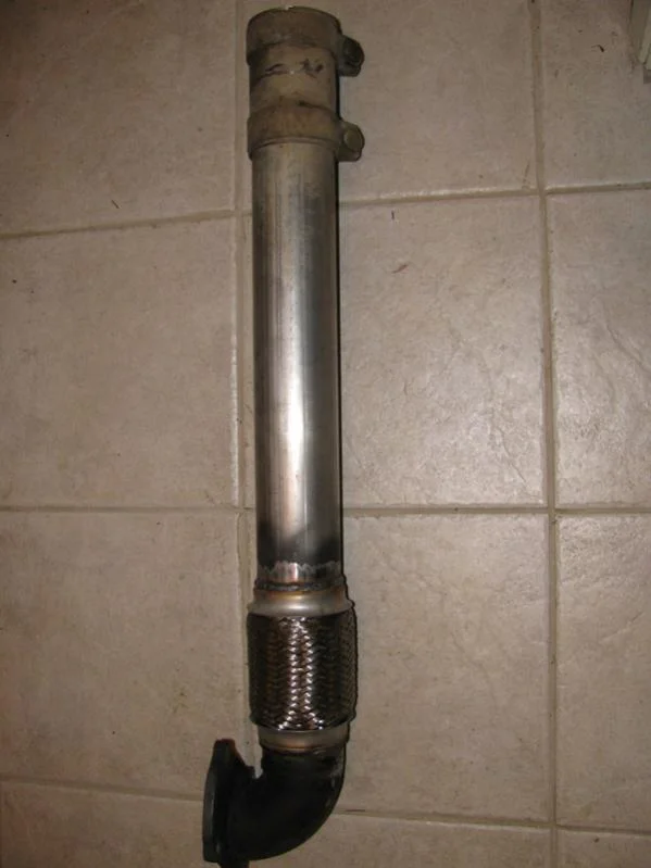

Received the 3 inch flex pipe I ordered from ebay (was about 20 bucks!), seems like a good piece, time will tell… It has now been welded into the downpipe from the flange on the turbo, I had a previous crack there from the vibration.

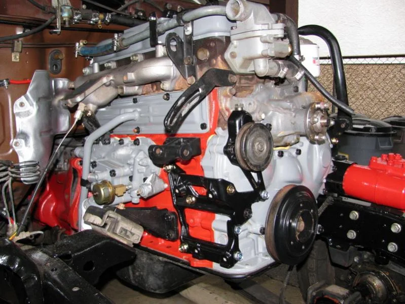

Fan installed on water pump
Alternator installed with a new lower bolt
All A/C brackets installed with new bolts

Turbo is all hooked up with new fittings and lines.

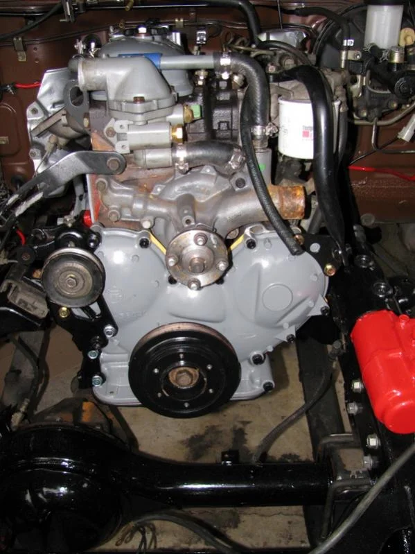

Finally some pictures!
All brackets and covers installed, Nov, 24, 2011.
