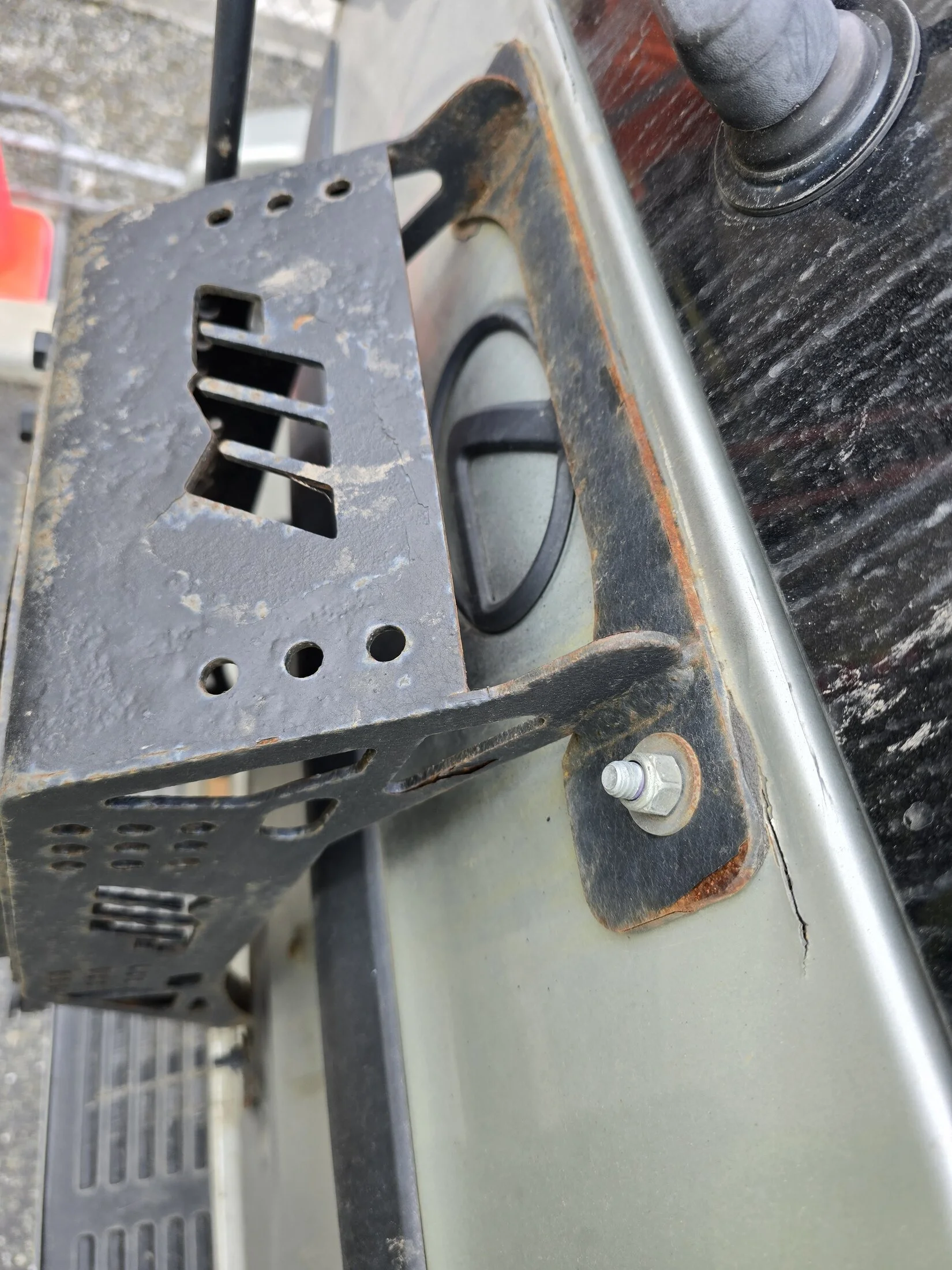

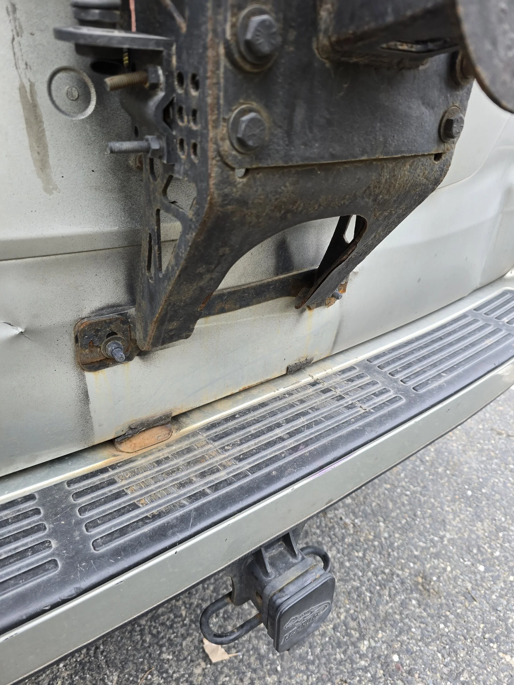

She's done now. The lower tab finally sheared off. The door is trashed, tearing apart at the top connection and smashed in at the lower section. I've got a new door in the shop, I won't be doing a door mount tire again.
What caused that lower piece to break off?
What size tire did you have hanging off there and how for how long? Did you do a lot of wash-board roads that may have helped it do fail?
I have a 35 hanging on my JW, done a lot of off roading, no issues. Doubt he has anything heavier than I do.
That looks bad.....real bad.
An expensive repair to replace that entire door, paintwork, etc. Damn

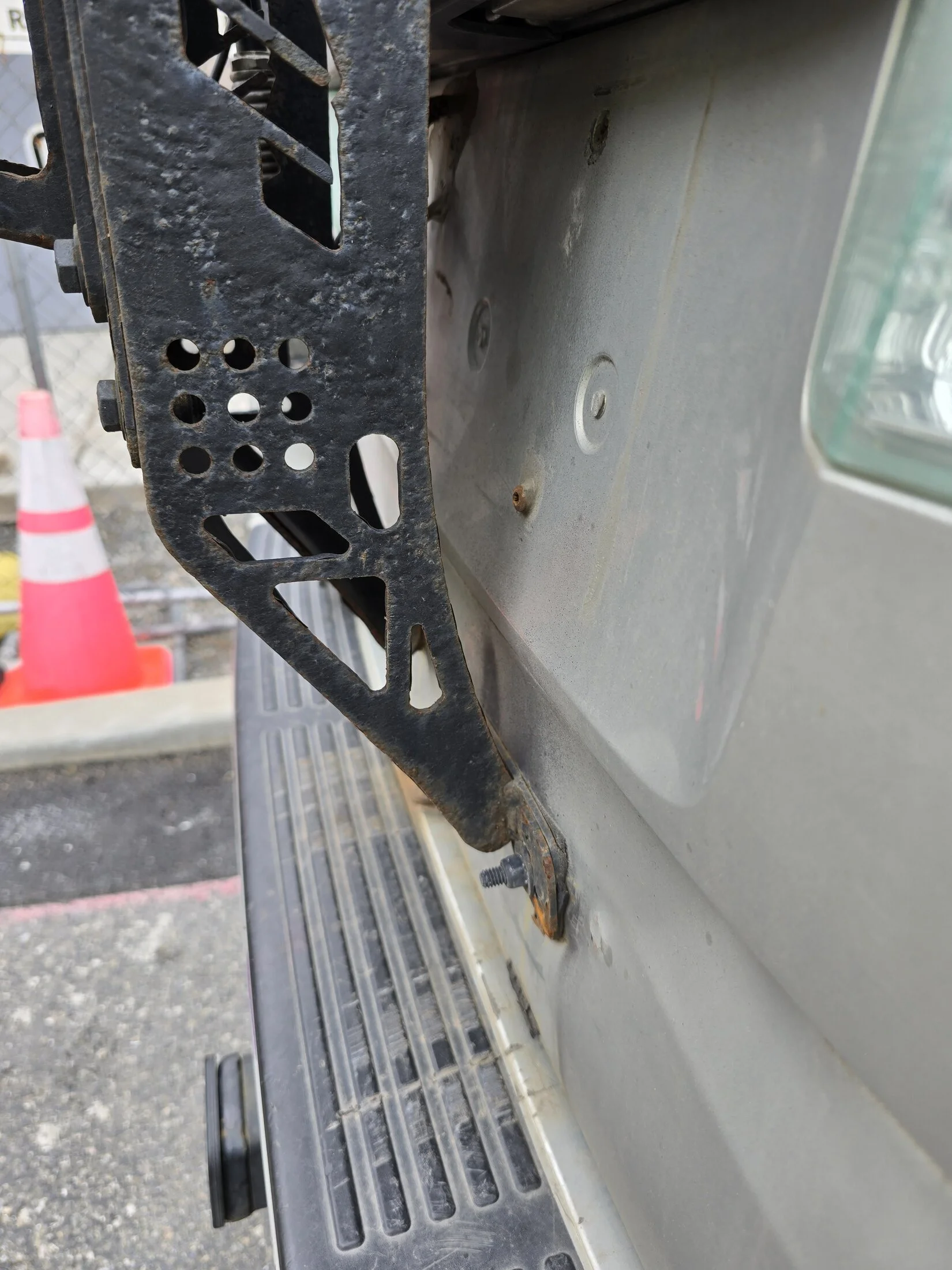

Since you're local, I'd reach out to Tuan and get a single swing out if you plan on getting a new carrier. It's supported by the frame, but still swings out when you open the door. I have one on my GX and it's been great.
That looks pretty slick but I have concerns that it only supported by the hinge and the leverage is still pretty long from the hinge. I am afraid that would wobble bad off road.
What do you mean? It's welded to the frame. Here's some detail shots:
It looks like there's support structure underneath the arm, similar to the JW. I don't think it latches to it though, so it's possible there's some vertical movement off of it still. Can't tell from the pictures.
I did not see how this is sitting on top of each other? Is there a pad that fill this gap? Even if there is a pad. It might not have preload that hold it down.
The hinge to the center grafity of the spare tires give pretty long leverage. Any play in on the bearing and it would move a lot more at the tire.
Normally the middle part become the second point and reduce the leverage from the tire.
