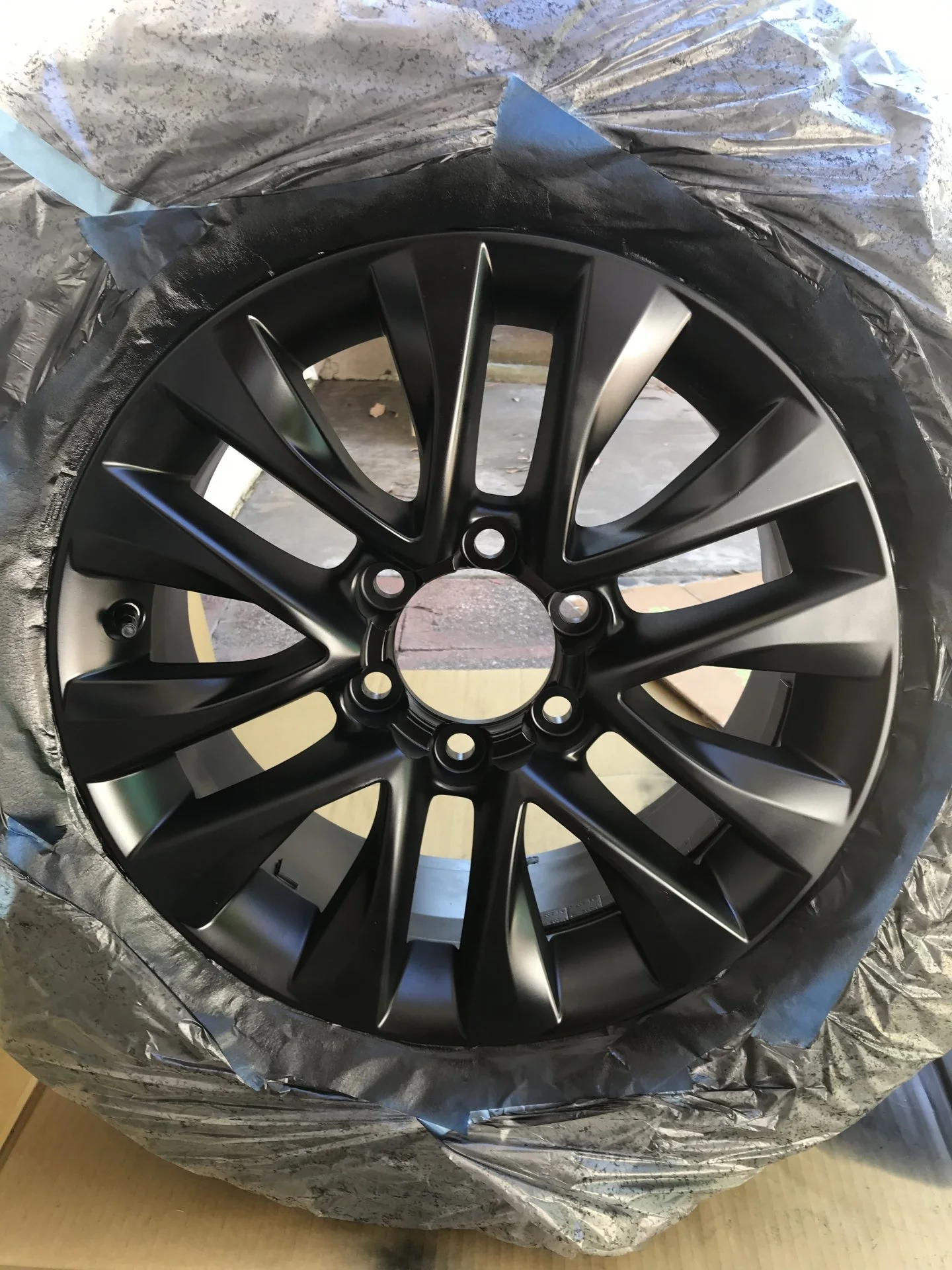

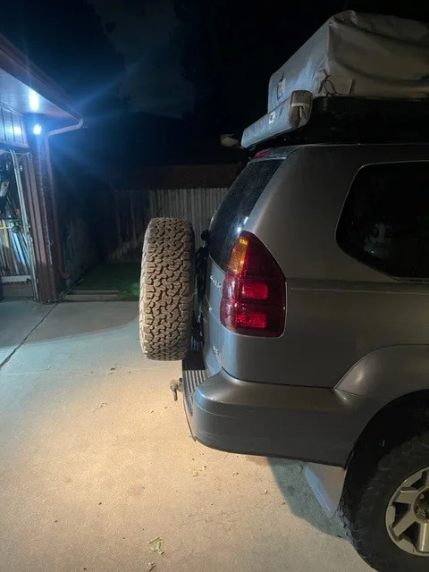

Well, the newest addition has been added to the GX. I’ve got 255/70/18 KO2s on stock wheels and didn’t want to deal with a deflated spare under the GX, the cost of a full bumper, or the looks of something like the RIGd carrier. This thing is stout with zero wiggle and definitely helps with moving away from the mommy mobile vibes. Thanks to the JW team for getting me in on a Saturday.

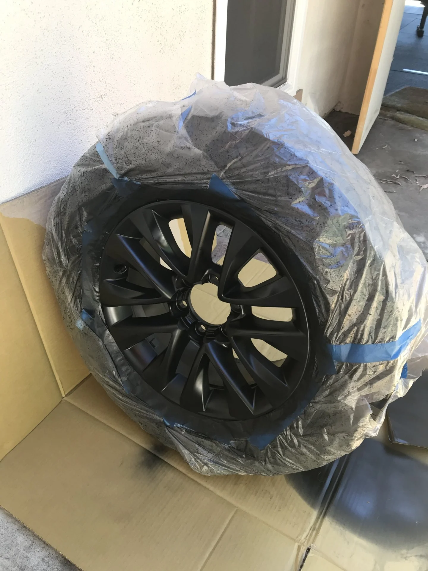

Painting the stock spare to match.
Final product.
I have the taillight overlays I’ve got to get on, need to figure out what to do with the chrome, then it’s on to sliders. I really like the DV8 ones that haven’t been released and Ronin which aren’t being made currently.

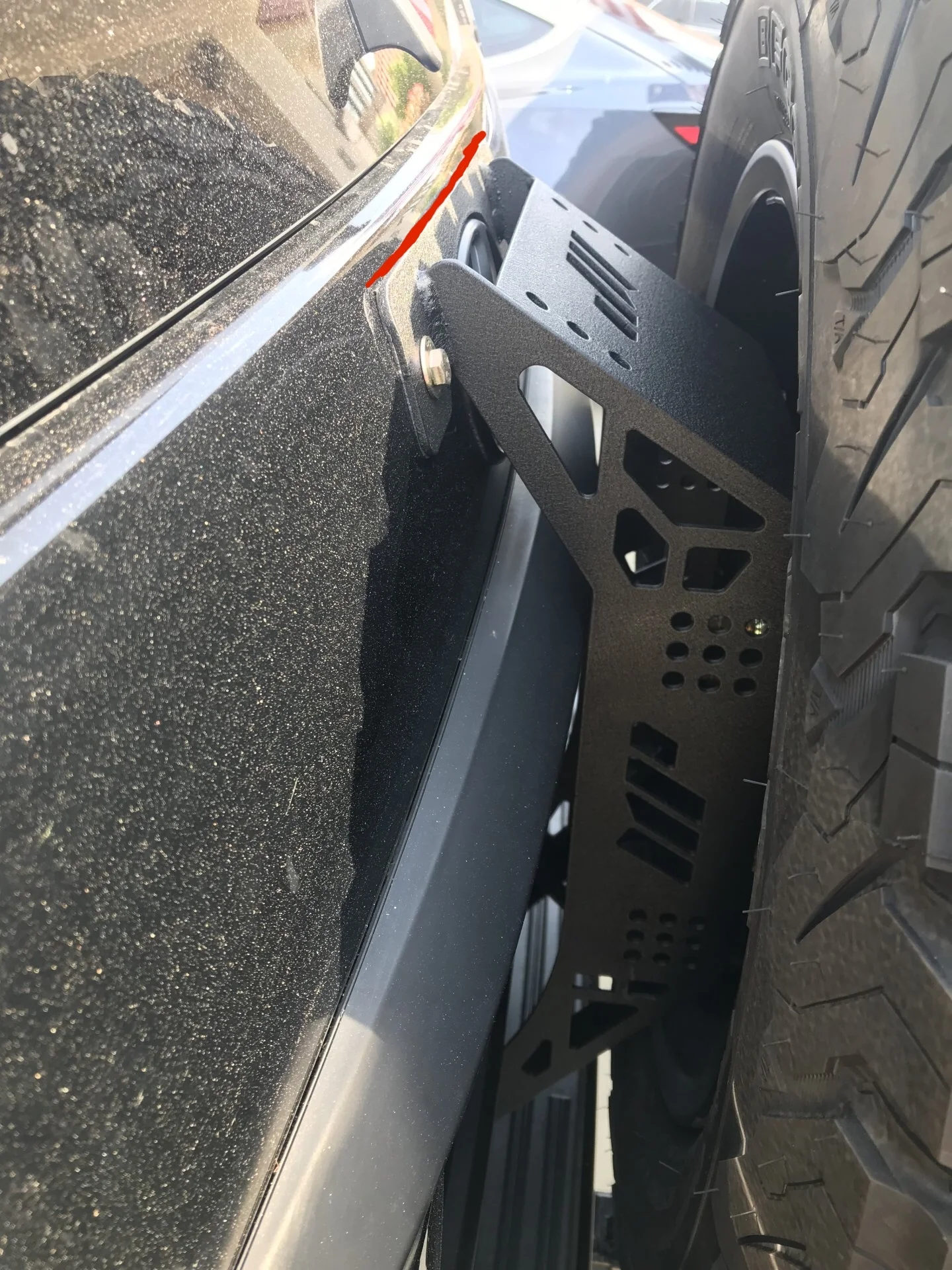

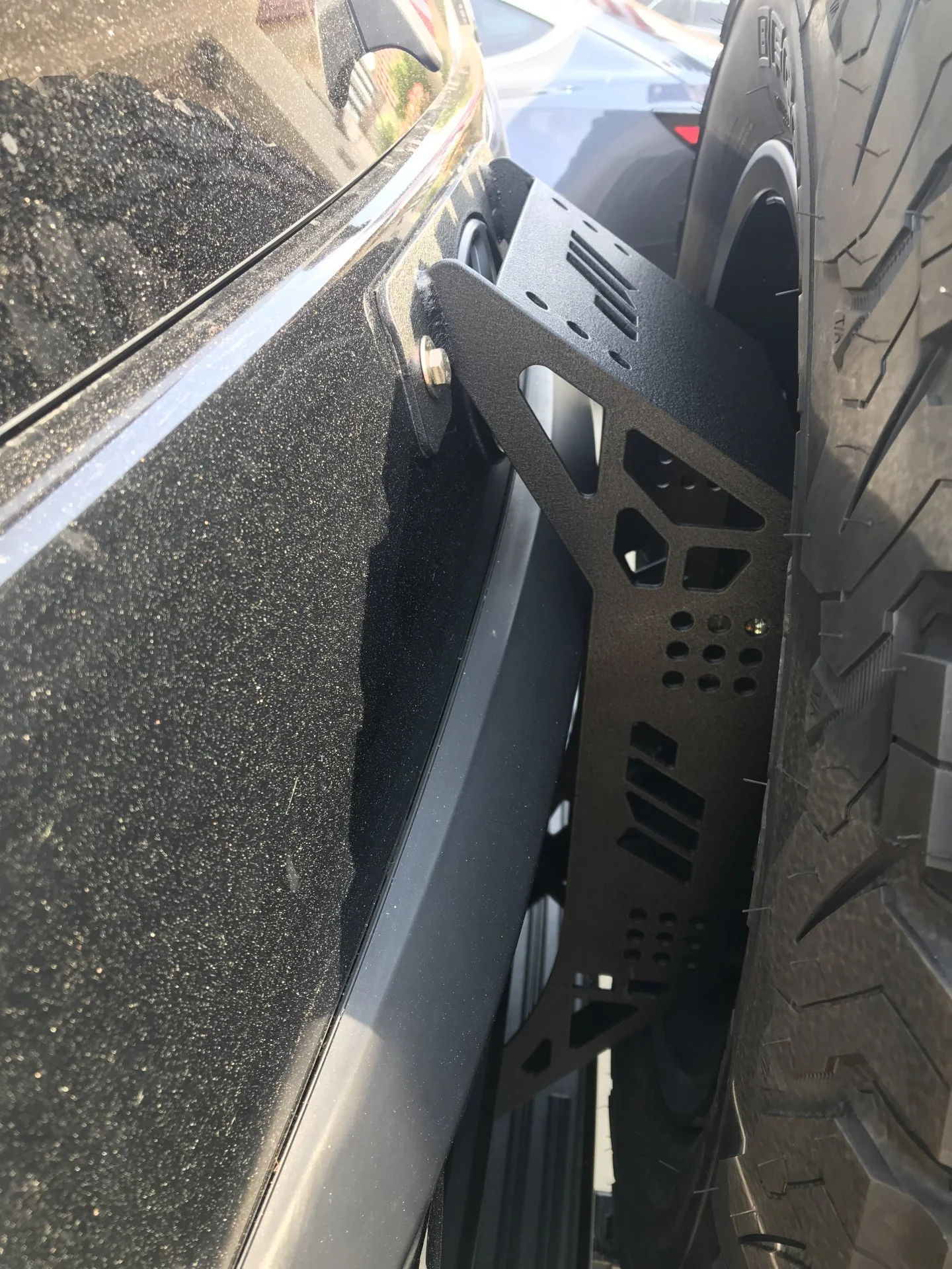

Keep an eye on the area in red. I recently saw a gx with this carrier and the carrier had torn through the sheet metal of the door. Not sure of the circumstances behind it, but it’s not an easy fix.

Keep an eye on the area in red. I recently saw a gx with this carrier and the carrier had torn through the sheet metal of the door. Not sure of the circumstances behind it, but it’s not an easy fix. View attachment 2728686
The killer would be extreme wash board roads. If you find yourself on a wash board road, go slow and try to avoid the heavy bouncing.

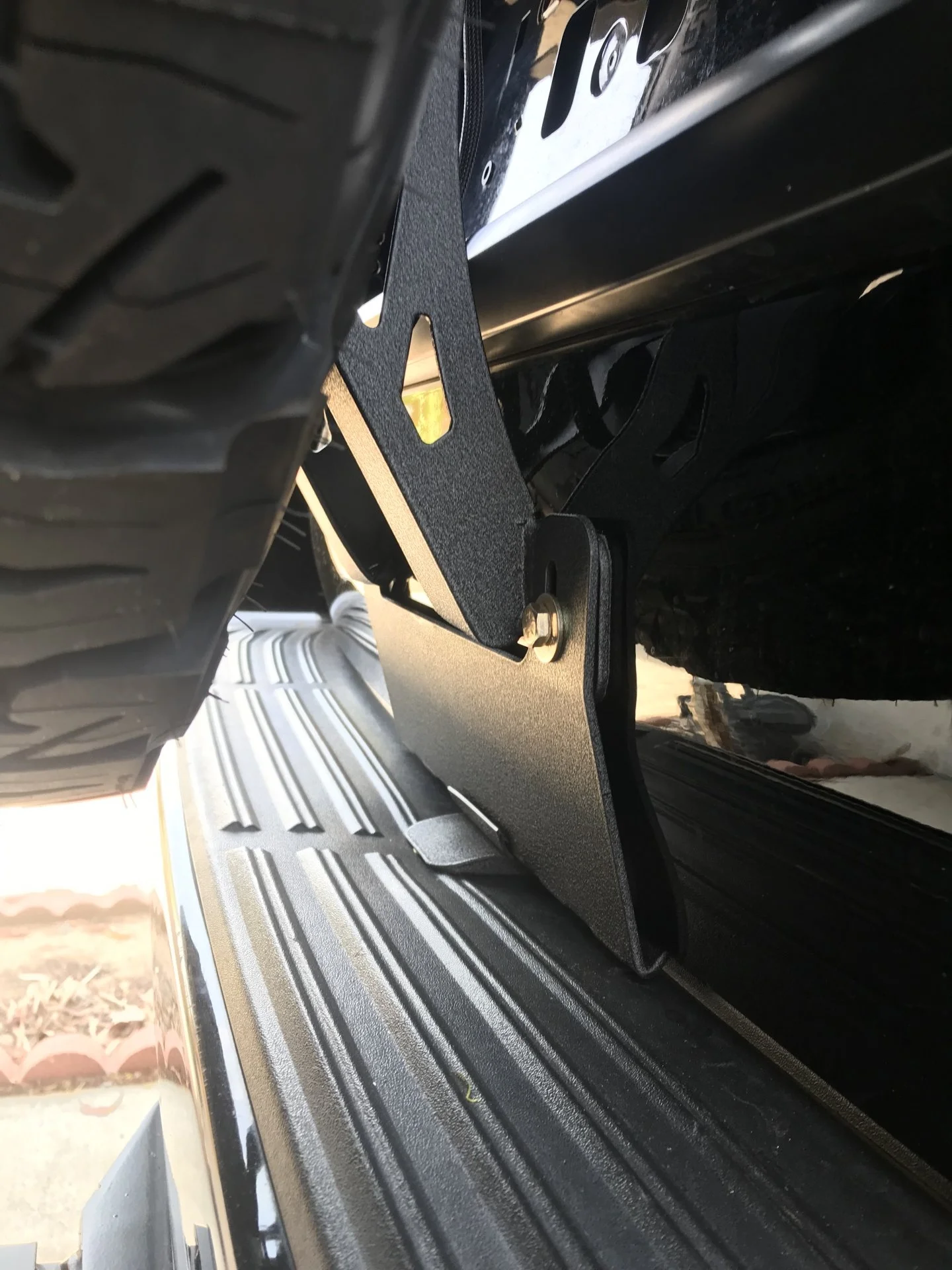

If you look at the picture above, this is what JW does. There is a little ramp that the carrier slides up onto.
Does the JW still tear the sheet metal after the little ramp was added? I thought they added it later?
I think that "ramp" does more to support the door and hinges than anything, though IIRC there is a bracket that wraps around the bottom edge of the door and ties to the bottom door skin attachment point so that might help some.

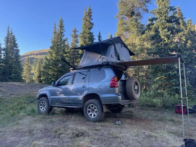

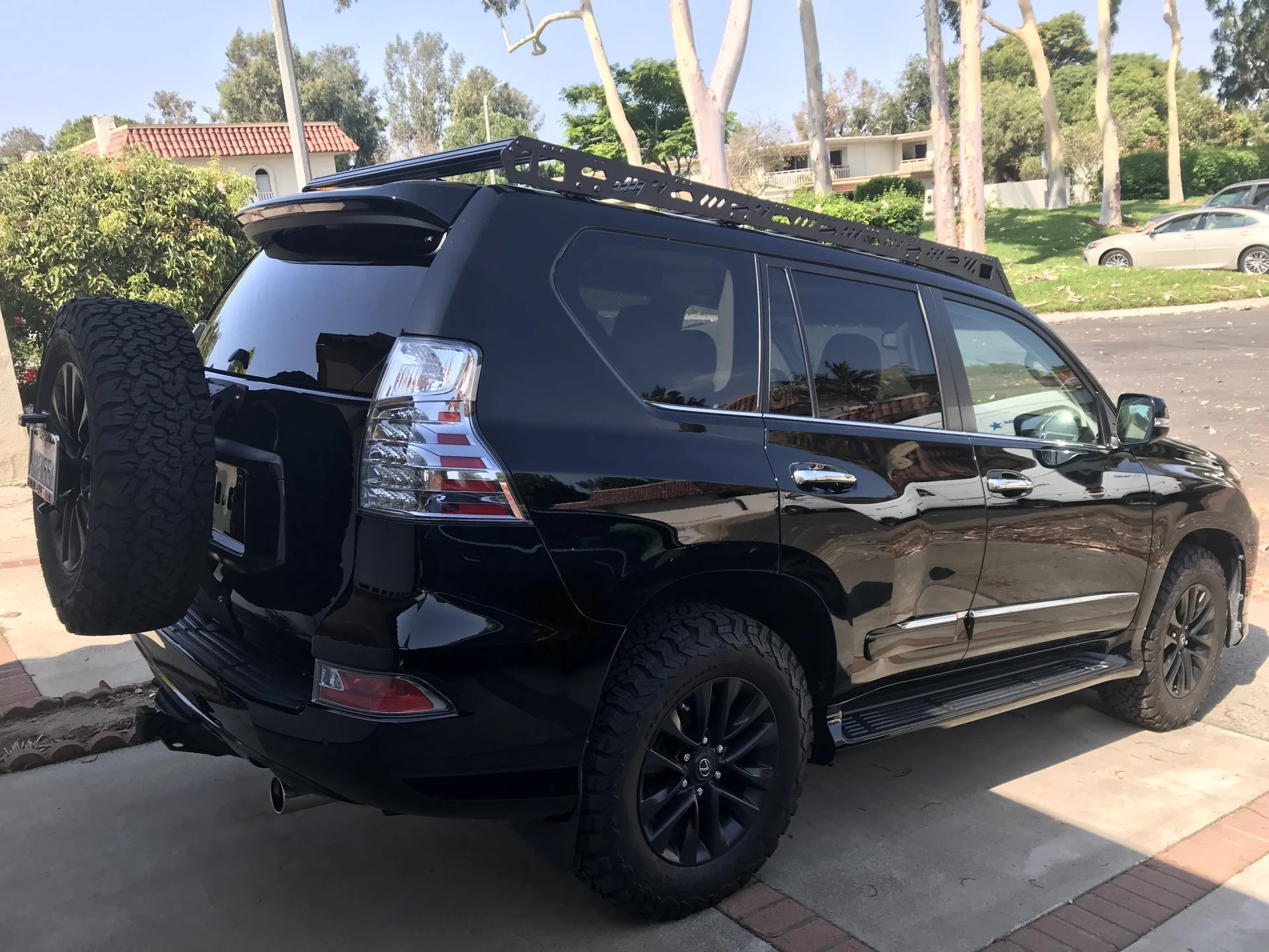

Recently installed JW carrier on my GX before a trip to Ouray in late July. Install is a bear. Getting the holes drilled, bolts threaded onto the nuts and tightened (triple checking everything, painting bare metal, completing the wiring & license plate mount) took over 10 hrs. Overall I am happy. Spare is accessible, does not obscure rear view, door shuts perfectly after shimming, zero bounce or squeaks even on high speed washboard, huggs nice and tight to the door. Plus it looks tuff. Completed the center camera mount and DIY license plate mount on the door post Ouray trip, takes extra work but completely worth it. Tire is 265/70R17 E rated on a steelie.

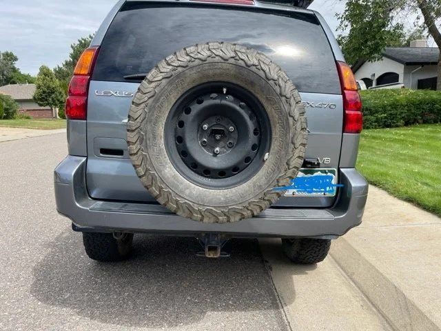

View attachment 3403741View attachment 3403743
Great pic's, but you know you're on a GX"460" forum and not the GX"470".
