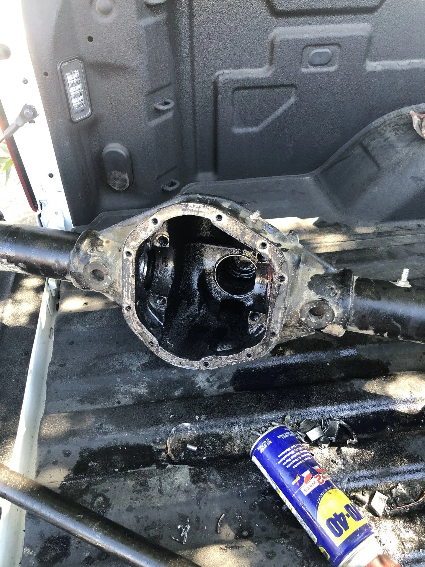

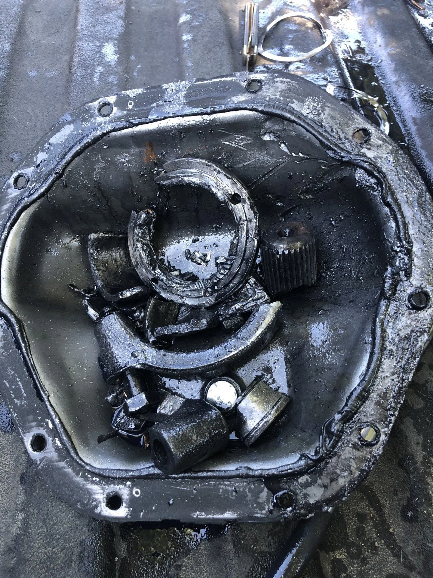

On another note my buddy got his JK back from the insurance adjuster yesterday. It looks like the Dana 44 ARB third member let go. Both of the shafts were broke and the third member was toast. After we finish the run he drove 25 miles back to the hotel on this third member with front wheel drive powering him

I think 35's are stock on those Rubicon Jeeps with Dana 44's- but I thought the common fail are the axle shafts not the diff.
I believe my jeep buddy with the broken axles could have limped the jeep out after he broke the first shaft. But after the break he continue to use a heavy foot. I suspect the differential survived the original break but the second shaft broke and the differential imploded not long after the original broken shaft.

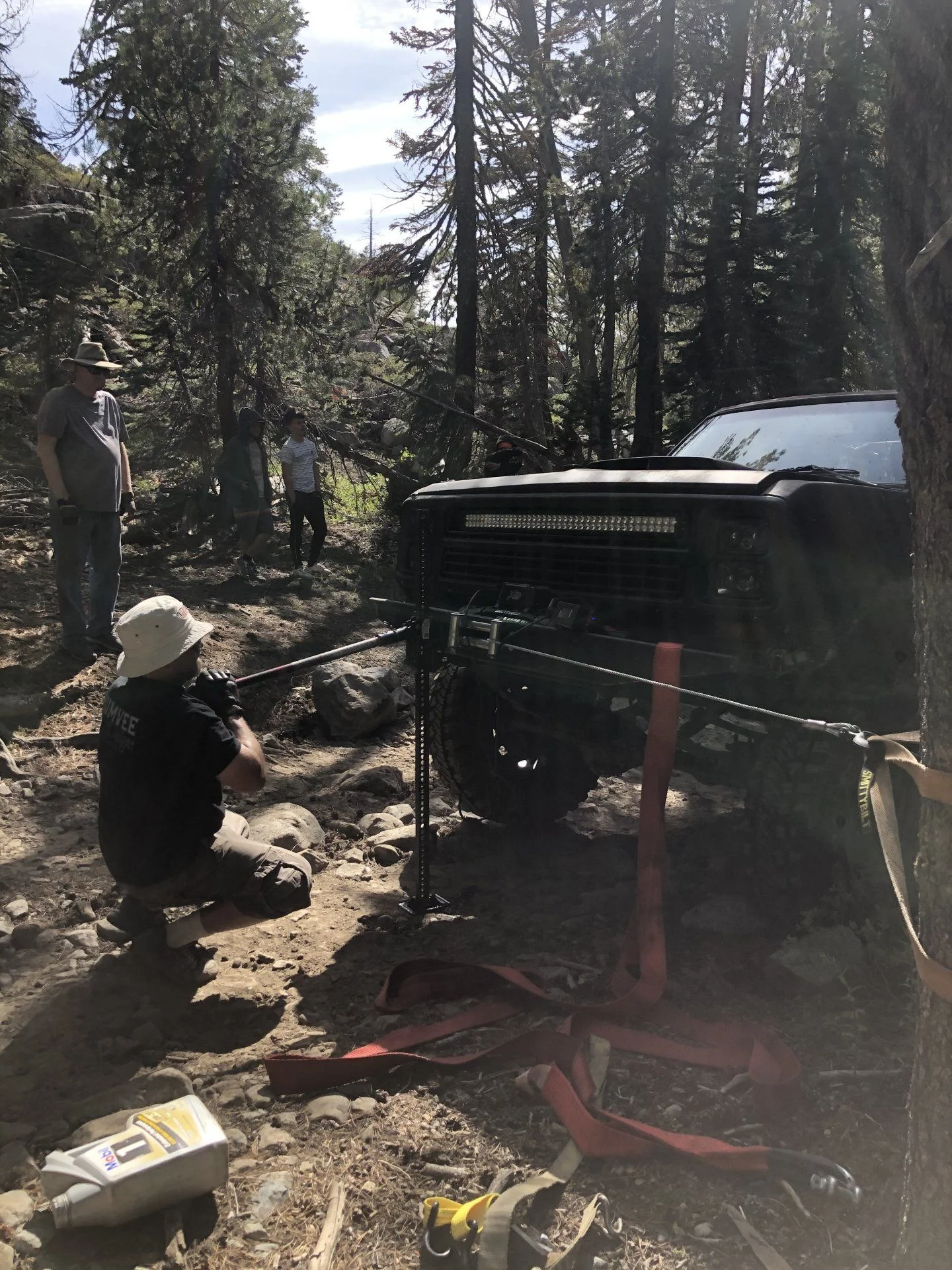

Threw up a picture of us changing the tire on the ram charger. Notice how we winched it to a tree. Nice little trick to help stabilize A high lift Jack
