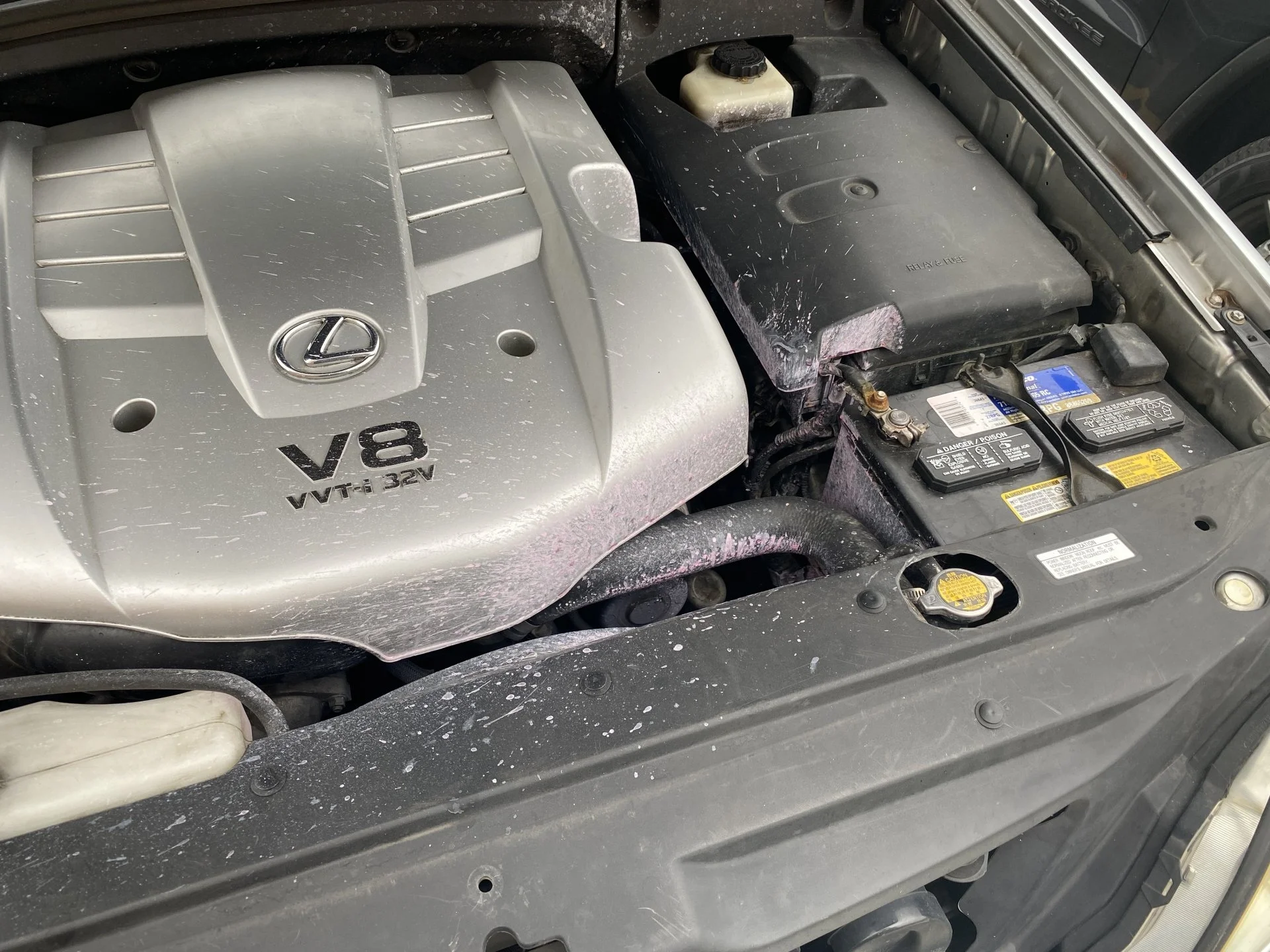

But now after almost exactly a thousand miles, we pulled into our hotel in St Charles, MO and shifted into park and… nothing happened. Turned the car off, won’t turn back on - no clicking, just check engine light and nothing. Popped the hood and there’s a bunch of opaque, light pink fluid (think Pepto Bismal) sprayed from down near the battery.
My guess is this is transmission fluid? And fingers crossed that it’s just a leak in a hose or something somewhere that can be fixed relatively quickly? Any thoughts or advice?
that's your coolant
check hoses and radiator
^ This
Toyota uses a long life fluid that when leaking / spraying turns pink and usually crusty a bit.
Looking at the location check the right plastic reservoir and hoses on that side. It’s likely the radiator plastic tank is cracked.
The radiator should be a easy swap either for yourself in the hotel parking lot (if you are mechanically inclined) or a shop. Bommarito Toyota in Hazlewood, MO (20 minutes from St. Charles) has a huge parts department and can probably get an OEM radiator quickly and relatively cheaply. Unfortunately I can't recommend a mechanic in the St. Louis area as I do my own wrenching.

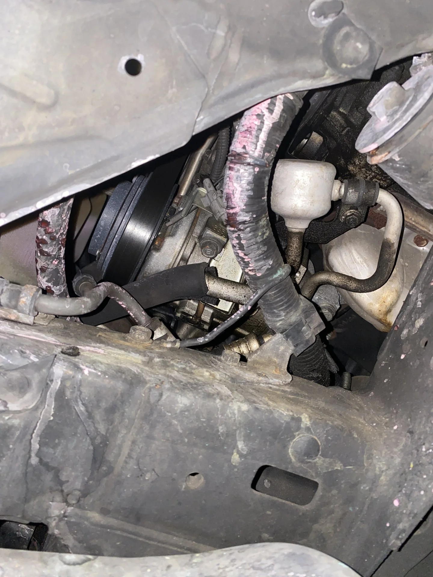

Thank you! Was down in there and does indeed look like it’s coming from one of the radiator hoses.

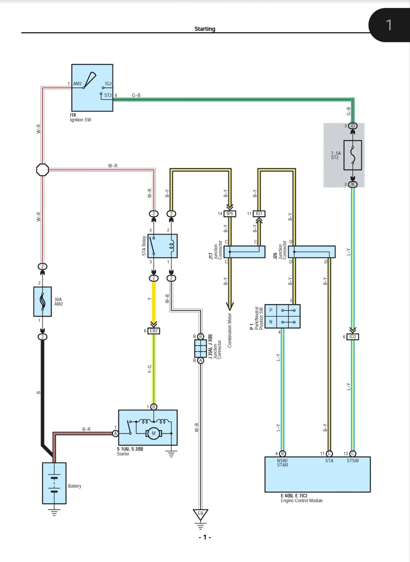

Attached is the wiring diagram for starting system. You could have bad brake switch or the fuse is blown for some reason. Or can be bad battery / bad connection.
I think rommelrommel is on it. It's most likely that you have a neutral safety switch inhibit because your linkage cable failed leaving the vehicle in D. You would naturally have all your warning lights on since they all come on as a test right before startup. My guess is you won't get a gear select light until the engine is running.
Focus on getting your tyranny in N or P manually from under the vehicle... I've not looked at it, but there should be some sort of bell crack with the selector cable attached. Try to turn it all the way up to the rear-most stop. That should be P. I bet it'll fire right up.... Then you can tackle that coolant leak! Lol
