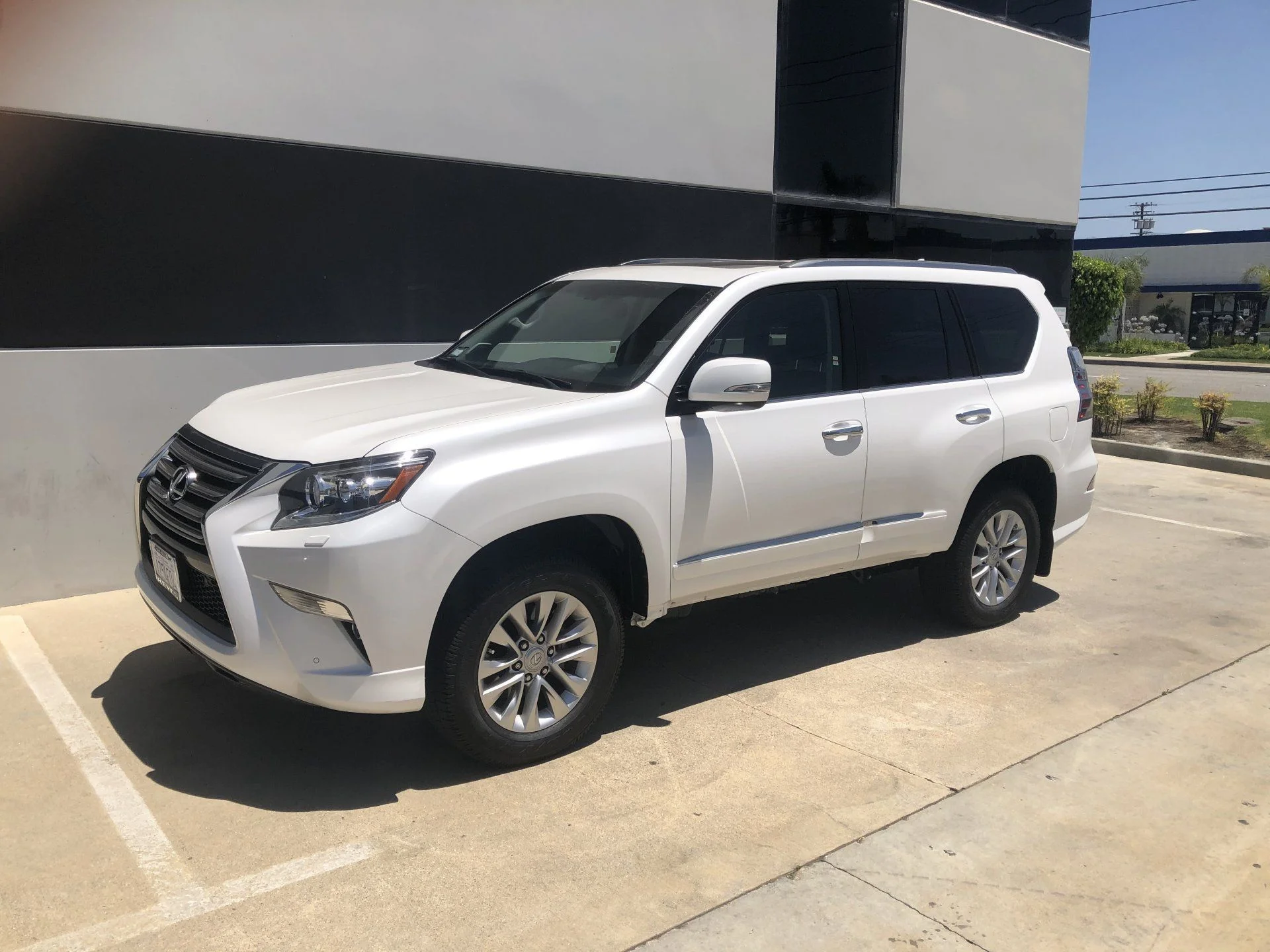

Just got a GX460 Premium certified pre-owned a couple weeks ago. As much as I wanted a gray or black one, the white seemed more practical (and it was in the best shape / mileage from the ones I looked at). Anyway, I'm on the fence about some stuff.

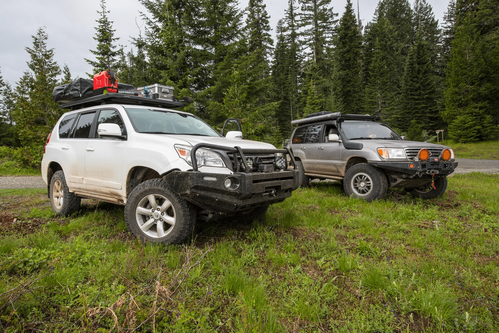

Ironman FCP's, SCS SR8 17x8.5's, and 285/70/17 Nitto Ridge Grappler's.
