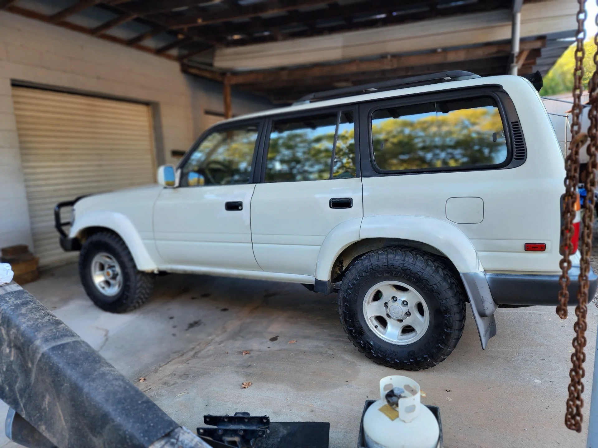

maiden voyage today....13 miles and a car wash. she is definitely a 50 yarder! drives tight, good power, no squeaks or suspension noises, shifts like butter, ice cold AC.....
negatives......still has noise from under the hood, brakes are stiff as they can be, like the booster is not working, and the sunroof leaks....alot. the sunshield on the sunroof holds exactly 2 gallons of water in case you were wondering...and sliding it back when full causes it to cascade on top of you like Niagara Falls.
any helpful tips on the brakes? engine noise actually got better after driving.
