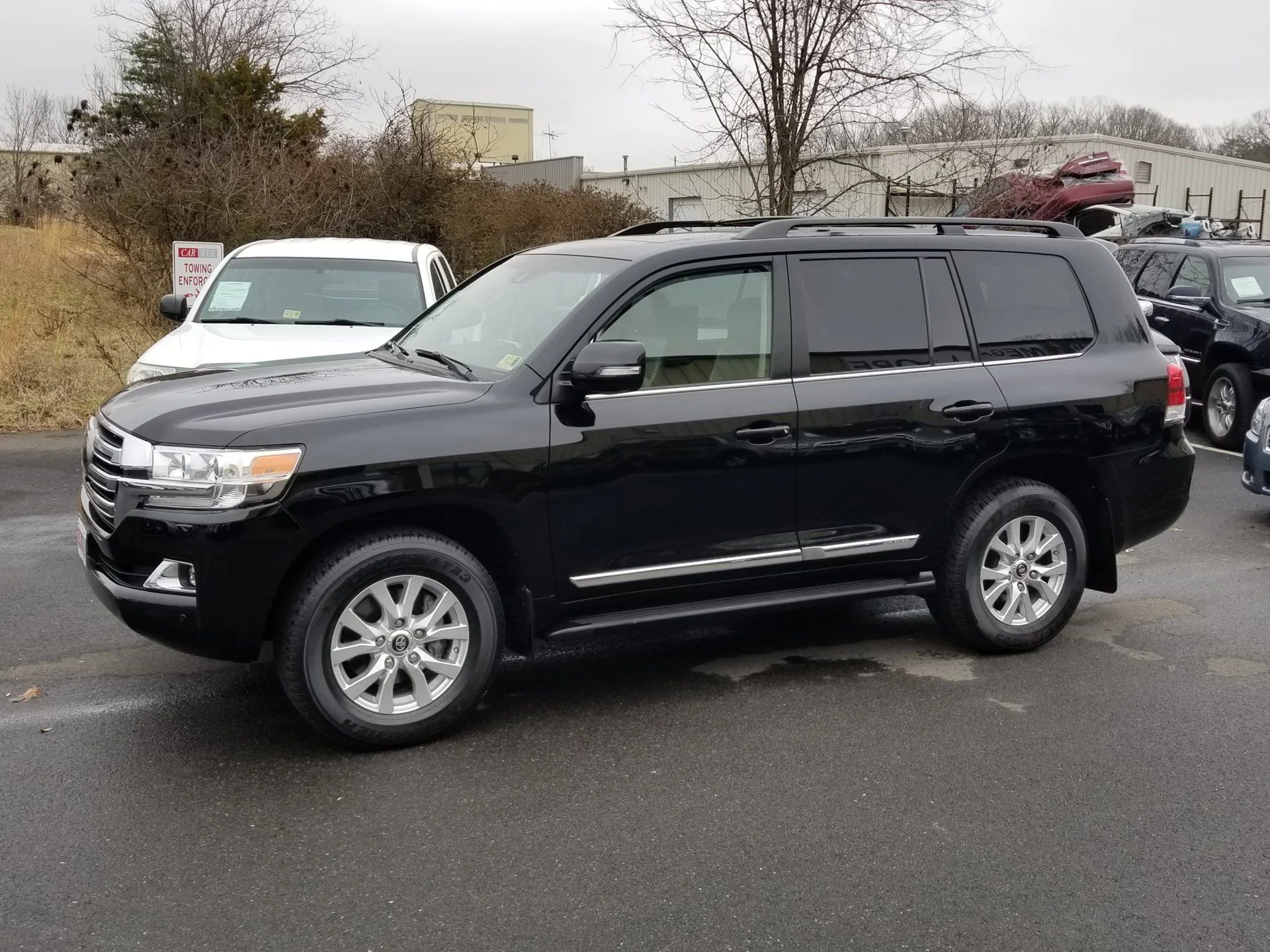

Hi everybody,
This past weekend I picked up a 2016 Black on Black Land Cruiser. I have been reading some posts here and trying to get as much info as possible. I have read through over 400 pages of the owners manual, entertainment system manual and quick reference guide in an attempt to learn about all of the features and settings this car has. This truck seems to have more buttons and settings than a James Bond vehicle! I had a few questions and was hoping maybe some of you all could help me out. I have searched and read through FAQ's, but after reading hundreds of posts it all seems to turn to mush.
1. Is there Anybody local to the Central Florida area who would be willing to meet with me and go over some common issues or concerns with These 200 series Land Cruisers? The manual and forums help a lot, but sometimes it is nice to just chat with a current owner and get caught up to speed on things to look out for. I can provide Pizza and Beer for your troubles!
2. I have looked through the maintenace schedule to come up with a timeline for how often I am changing things. Please correct me if I am wrong or have missed anything

Man congratulations. Such a great vehicle. Do all that stuff and keep meticulous records and you will be rewarded substantially when you sell it on here in the hopefully distant future :)
Congrats, nice truck. I got my 16 last fall, it’s been great. Definitely upgrade the tires. It’ll transform how it rides and handles (and looks) in a positive way. Do the wheels too, if it trips your trigger, but 18’s work just fine.
The current tires have some decent tread left, so I have some time to sort out the wheels. If I dont find some 17" wheels I will just get taller BFG K02's put on the stock 18's.
I figured the 16+ models would age the best. The plan is to either keep it for a really long time and it will be a cool old LC or put 100k miles on it and enjoy some good resale value. eventually I will do a slight lift, taller tires, offroad front buumper and cool roof rack and rear spare mount.
