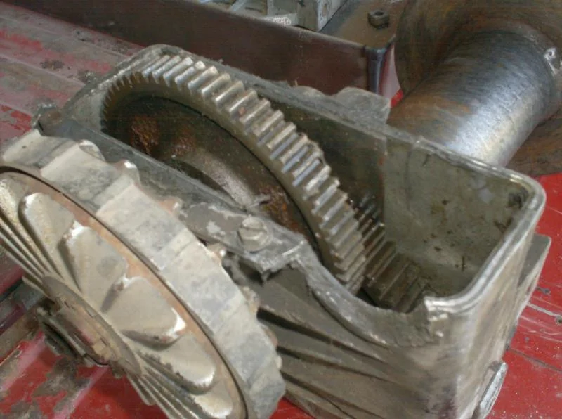

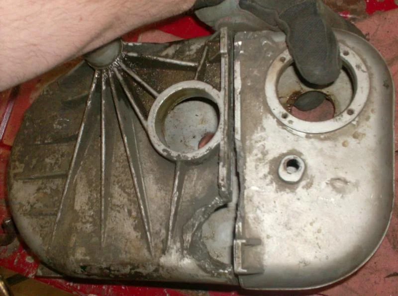

He says his "buddy" borrowed his blazer 10 years ago and wrapped the cable around the drive motor and pulled! - busted the housing

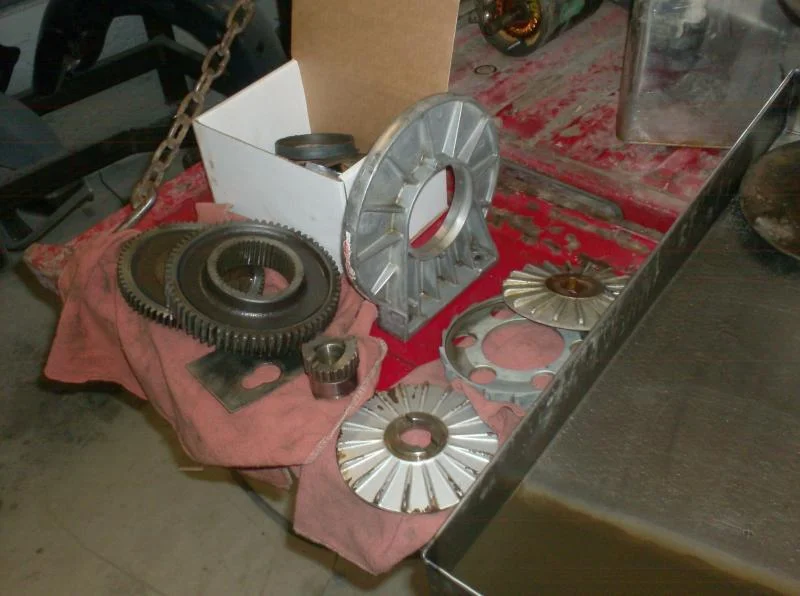

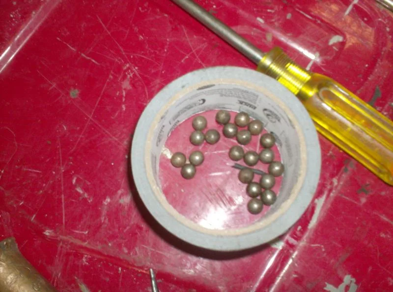

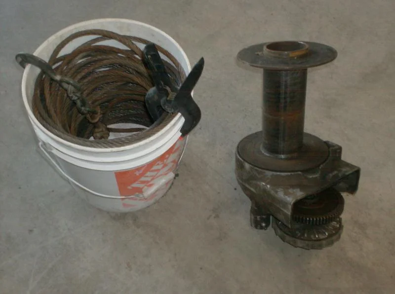

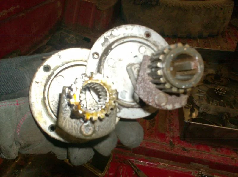

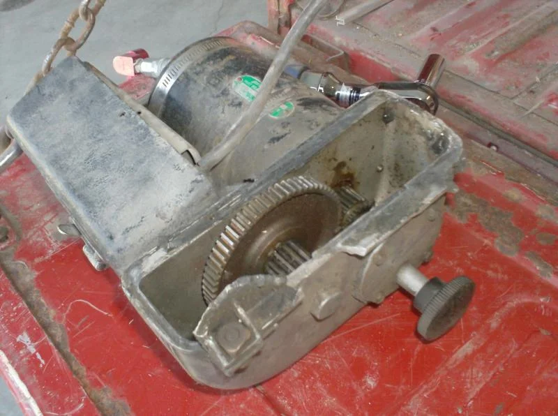

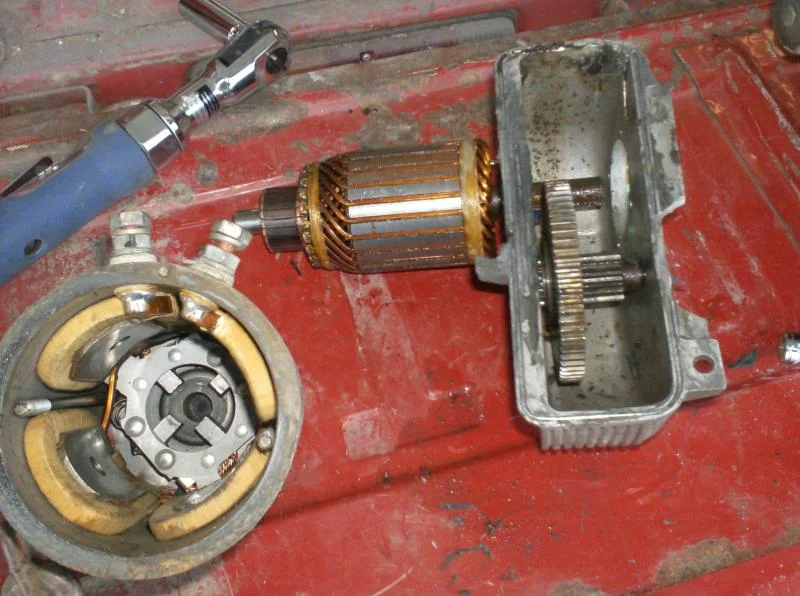

In prepping for this and the impending resto-mod of my FJ45 I bought myself a cheap sandblasting cabinet and made up a shallow wash tray at work for cleaning the parts. I plan on getting a parts washer but need to let the budget replenish some first.

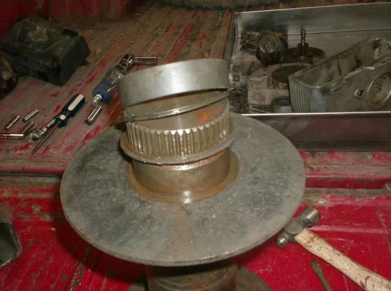

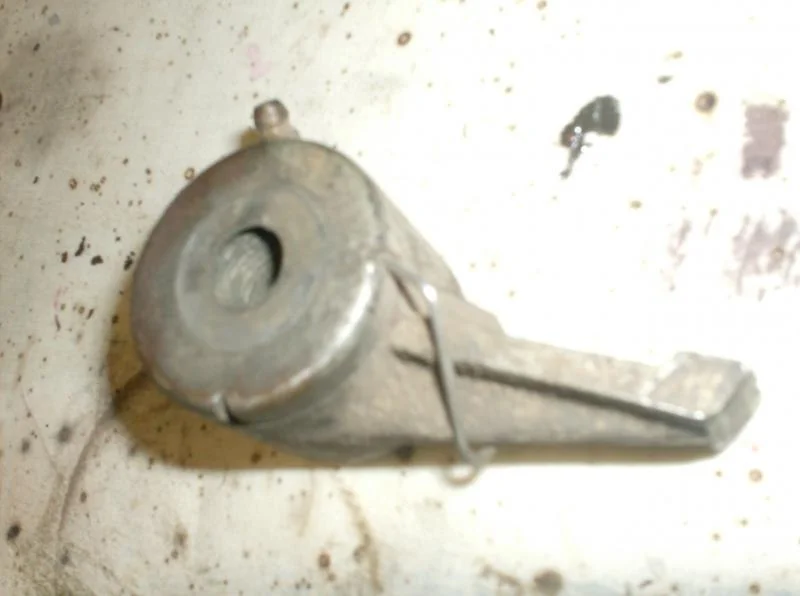

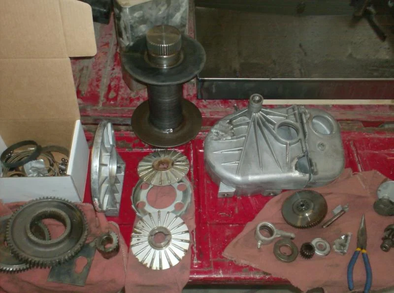

This is what I started with.

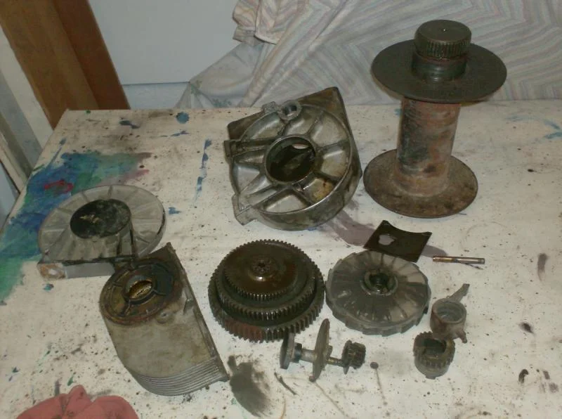

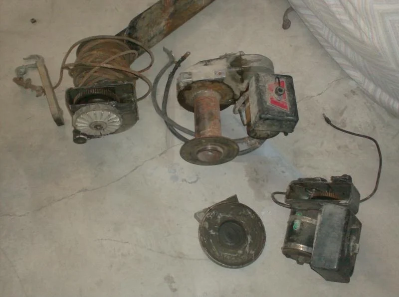

Pic one is the two 8274 winches - one in two pieces
Pic two is some of my toys

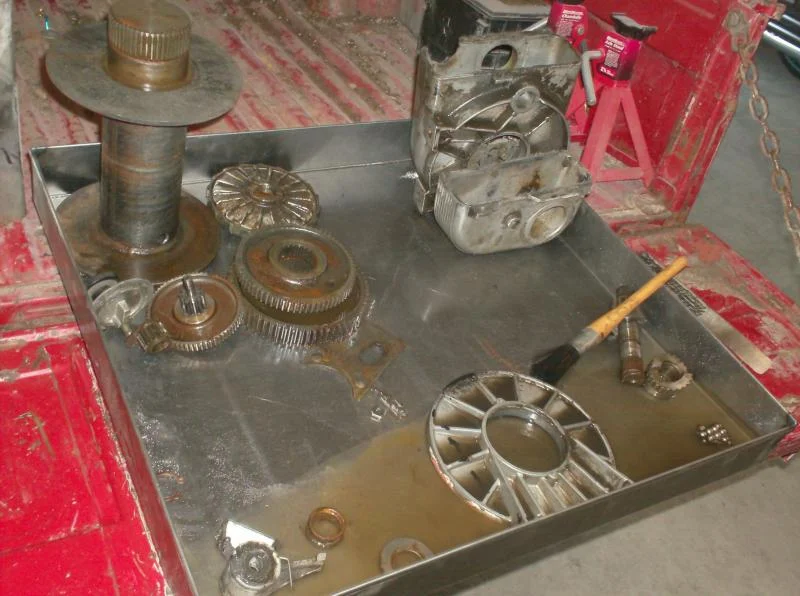

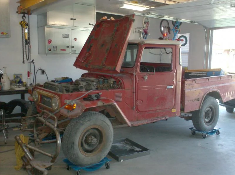

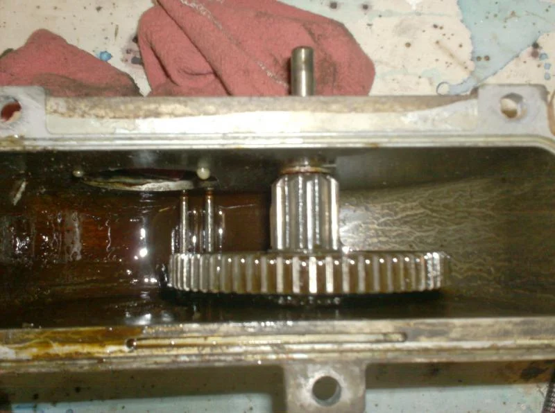

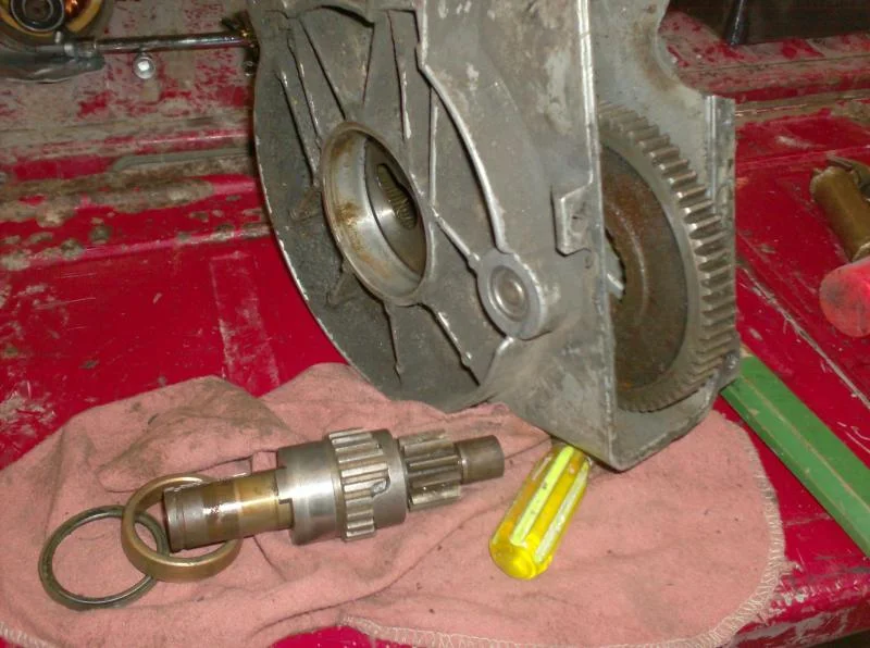

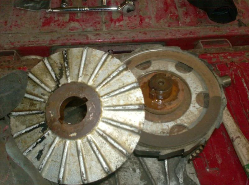

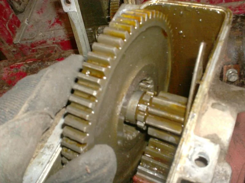

Pic three is the future home of the winch - my truck on roller skates
