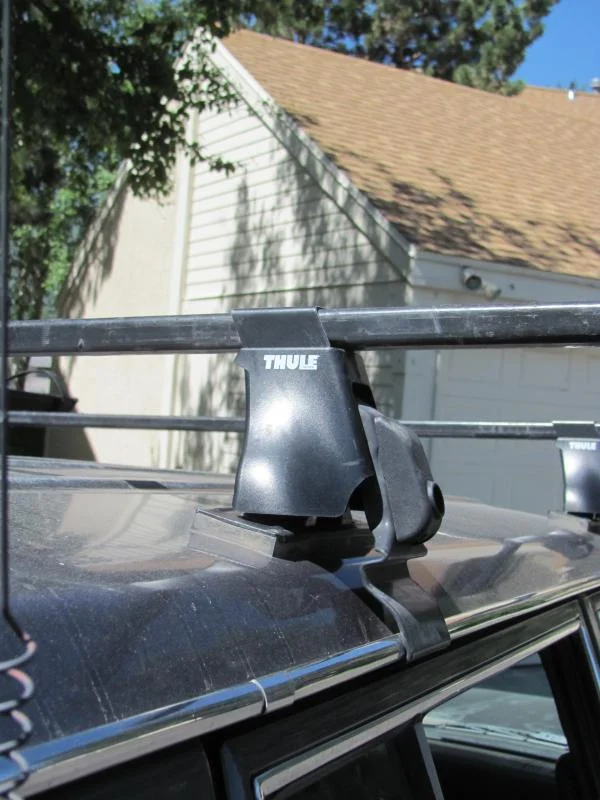

Fit Kit 2173 for a '99 to '10 Ford Powerstroke and/or Excursion fits a FJ60 and allows you to use Thule's Aero Feet.
Here are pics.

What kind of payload capacity this bars could hold?lets say you have 4 of the bars across the roof.just curious it could be cheaper than an ARB rack.:)

Pretty significant. I gave up on roof top tents but I ran one with this setup for a 4 day off road trip and it did fine, including at night with an additional 500lbs of human up there. So, 800lbs total?
