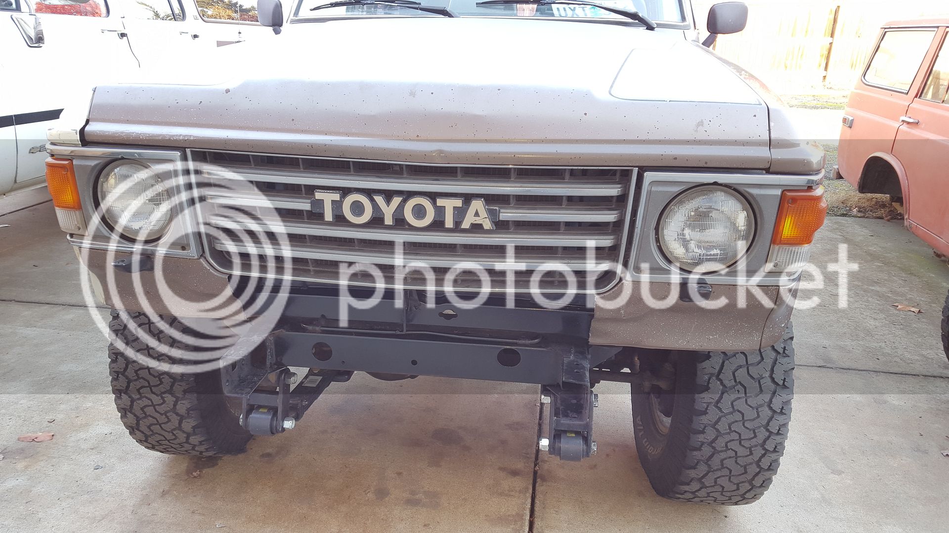

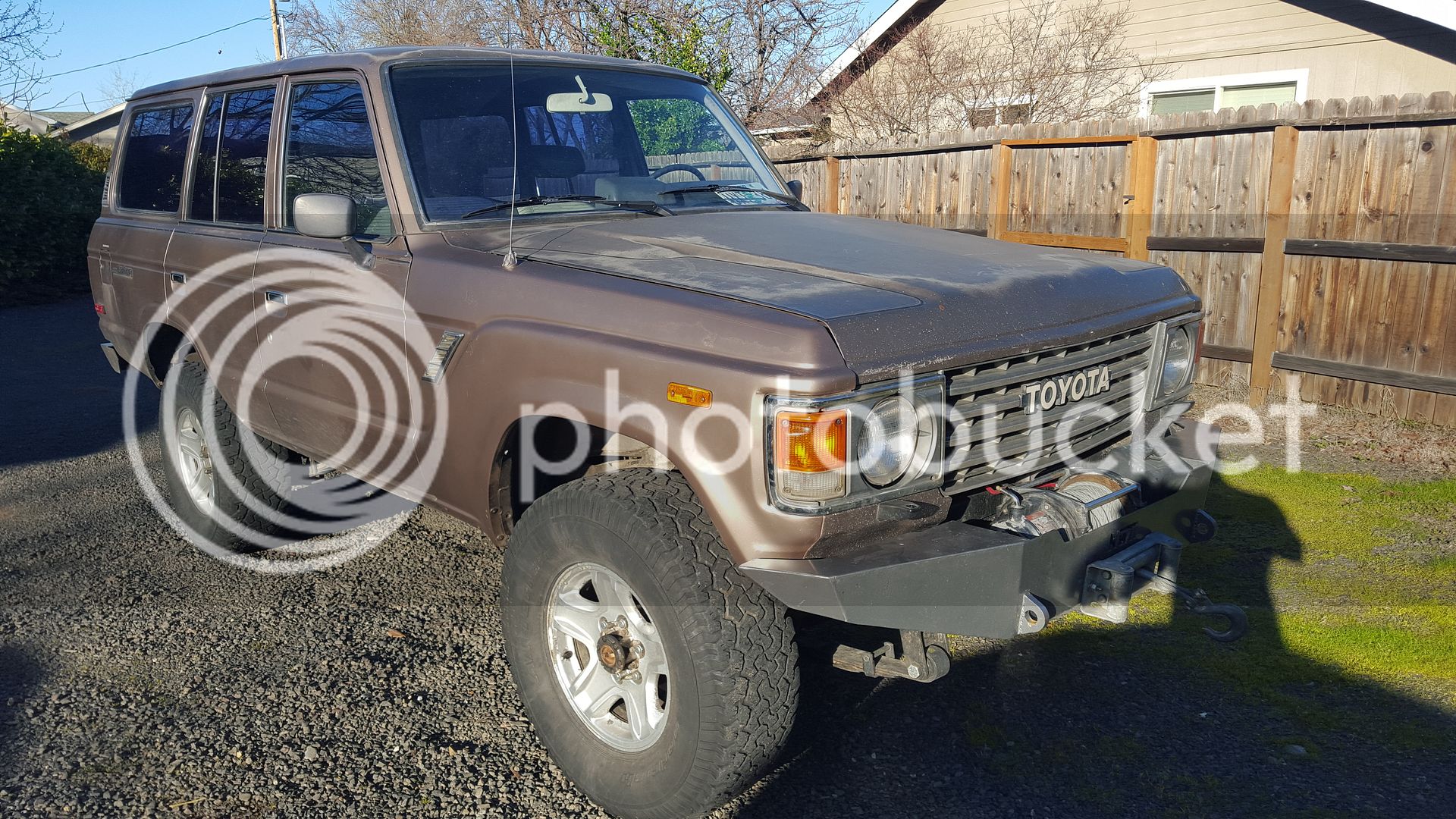

Got the new winch bumper done. Unfortunately with my 10k Warn I had to cut the valence.
Ordered some OEM paint matched spray paint to take care of that eyesore of a front fender.
I forgot to buy clear coat so I will need to source some but I think it is now the nicest body panel on the 60! It matches remarkably well for being a semi-metallic color. Super happy with how it turned out, especially for a spray can. It took the entire can to coat it without streaks.
