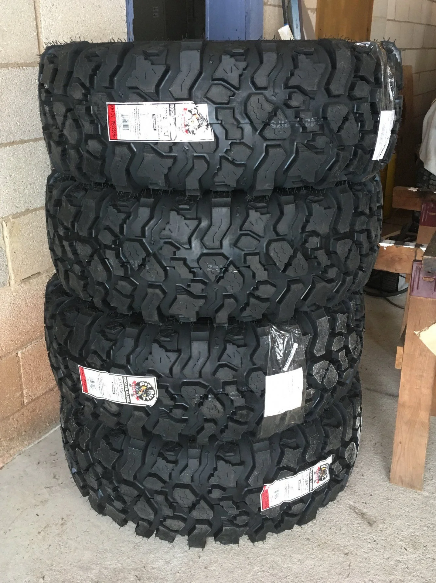

Quick update on this build, looks like I will be swapping a low mileage 5.29 geared elocker Tacoma into the back. A brand new set of Pitbull Radial Rockers in the 37" variety wrapped around a set of aluminum FJ Cruiser rims, will also be going on when they get delivered. Couldn't pass up the 1/2 off sale the other week.

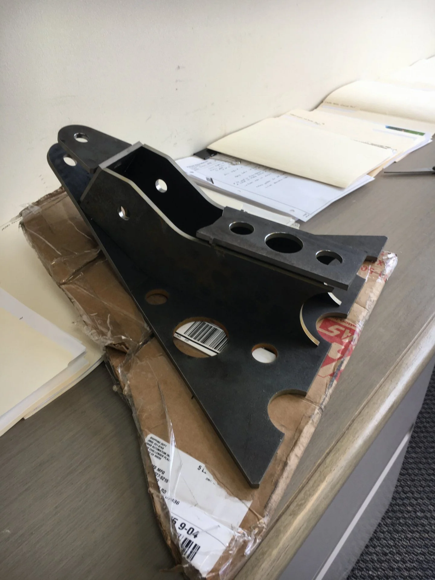

"Final" piece for the rear 3 link came in today. Combination upper link mount and panhard bracket.
