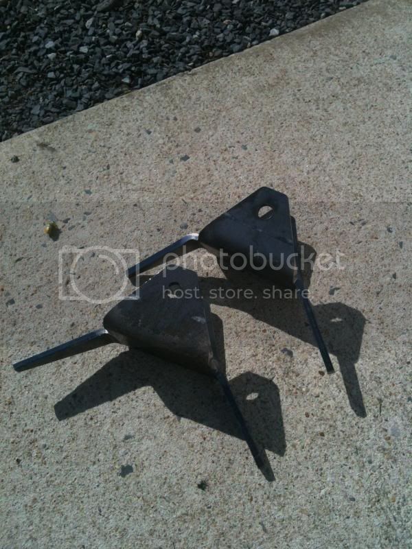

Had a few more parts come in such as the lower frame mounts for the lower links that I got from Barnes4wd along with some shock mount tabs. These are his 10 degree mounts, which should work nicely.

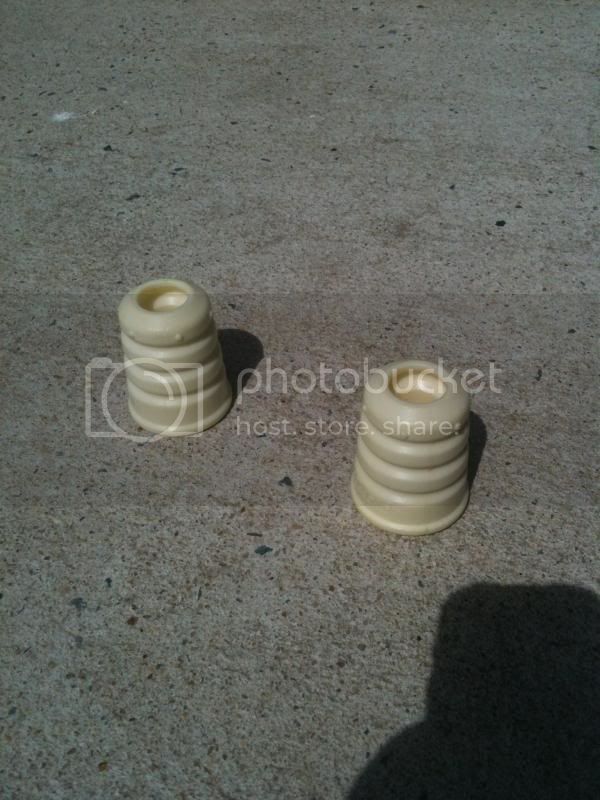

Here is a picture of the shaft mounted bumpstops I picked up at the GM dealer for a Chevy Malibu

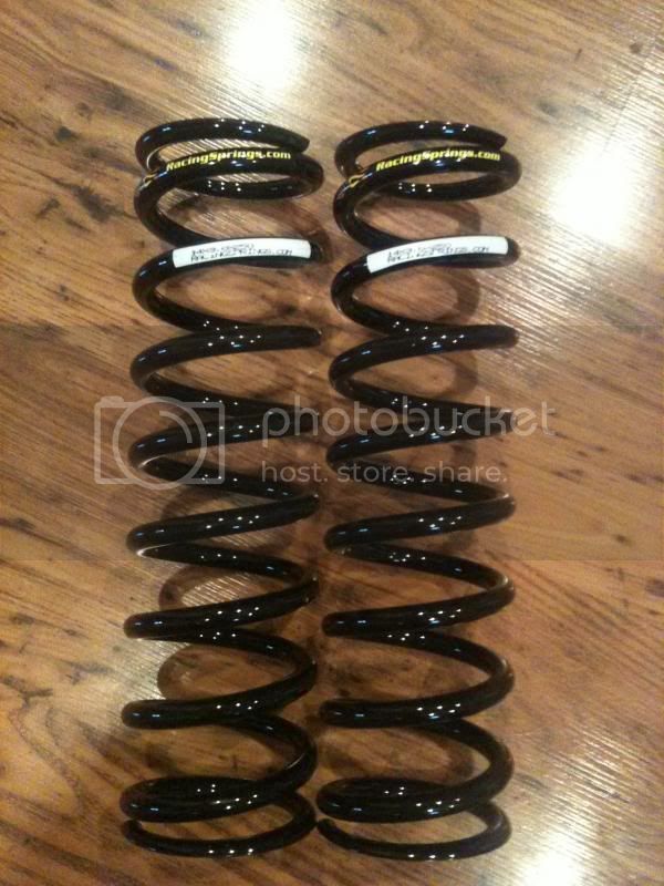

And finally a pair of 14" 250 pound lower springs from PAC Racing Springs that I found on Ebay for half price. They are brand new.

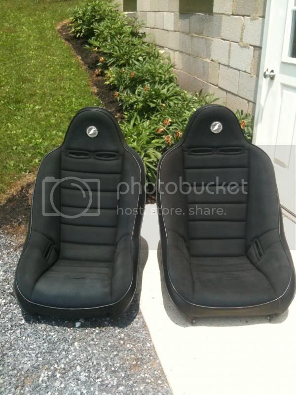

Ever since I installed the Corbeau Baja SS seats in the front of the 4 Runner, they felt too short, headrest at my neck and no chance of using the harness slot. They do however fit my daughter perfectly with a booster base. So I have been on the lookout for some new front seats and found a guy selling some slightly used Corbeau Baja Ultras for a song.
Going to hit them with some fabric paint from Duplicolor to make them black again and they will bolt right in and get me a headrest that works and be able to use the harness slots. The Baja SS's will be moved to the back and replace the folding bench seat so that my daughter can sit back there with a friend and be in a harness versus the lap belt that is there now.
Took a little time this afternoon and fixed up the Corbeau Ultra's. Turned out pretty decent. Next is to swap them out with the Baja SS's.

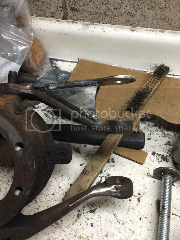

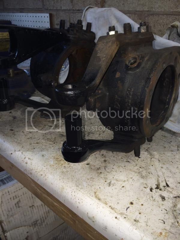

I have been doing a little bit to get the front axle ready for the SAS. When I first built the axle I was going to run leaf springs and regular hysteer running 3/4" heim joints, but with the 3 link, I wanted the steering much lower, so here is what I came up with.
I took two pair of stock steering arms, mounted one set on top like regular and flipped the other set side to side.
Obvioudly they don't line up, so I cut, bent, and welded them so that they would. I used a 5/8" bolt to align everything. Single sheer wouldn't have been good enough, so I started to make the top where the drag link connects double sheer.
I also wanted to put the draglink in double sheer, so I added some 5/8" I.D. chromoly tube and got this as the final setup.
Will install them next and get the tie rod cut to length.
