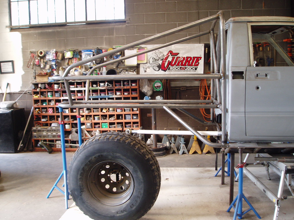

I had originally planned on an interior cage, not a huge fan of Exo cages. But odds are it will end up like the photo below so I went with the exo.
:lol: Good choice then.

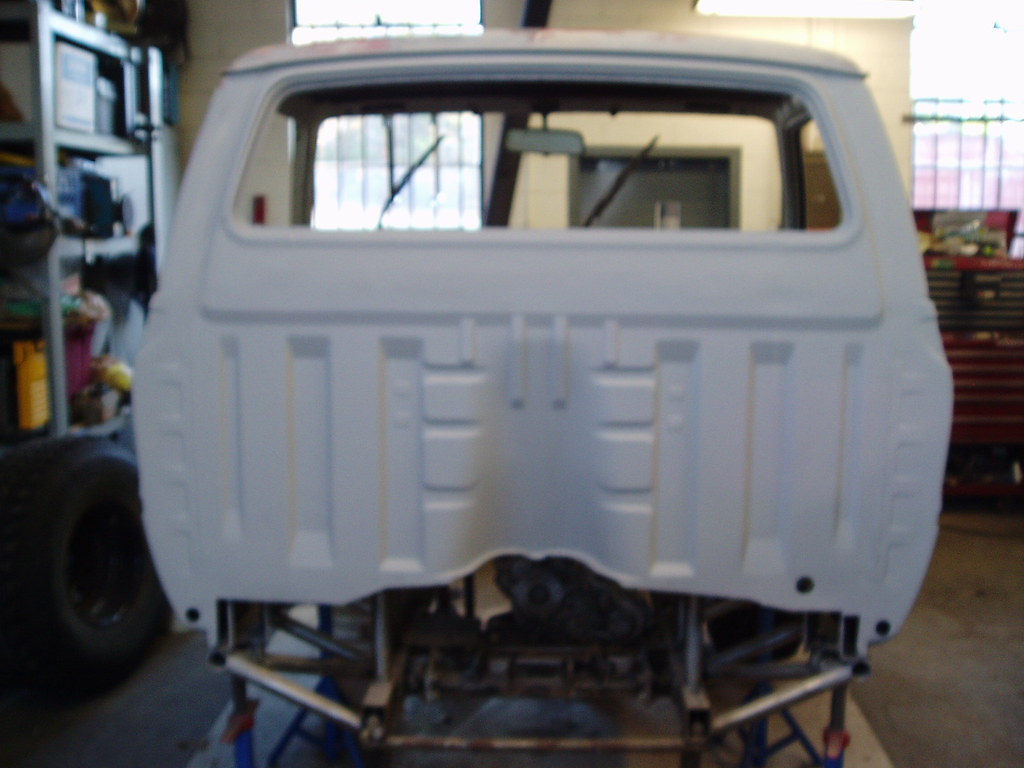

I've been working on getting the body work done on the cab so that I can paint it prior to starting the tube work for the back half and exo cage. I figure it will be far easier to paint it without all the tubes in the way.
Pulled out the rear window and the windshield. I had to cut out 6 places where cancer had eaten through the rear of the cab alone. All the patch pannels are welded in and the back of the cab is primed out. Lots of work for just a clean body :)

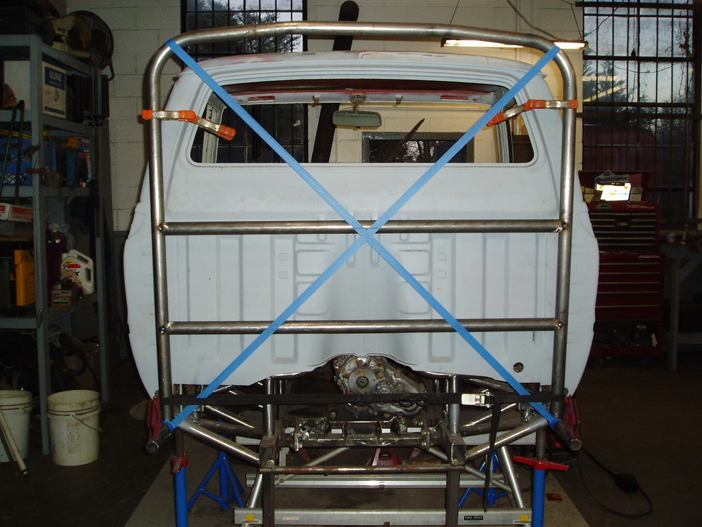

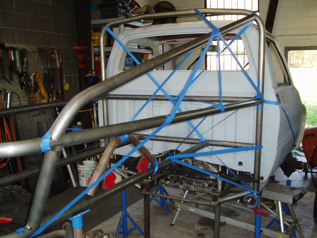

I got a little done today on the truggy. The main hoop is fit and two main cross members as well. I use the blue tape to get a visual on where the cross members are going. ALso made up two taller adjustable stands that will support the rear most part of the back half while being constructed.

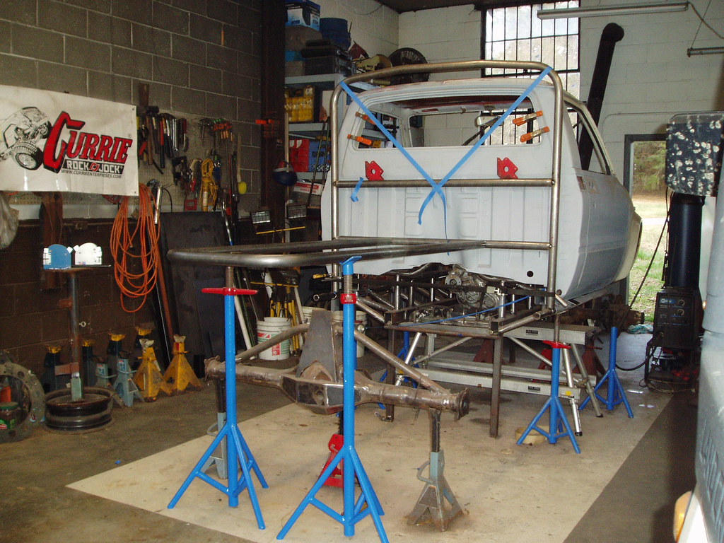

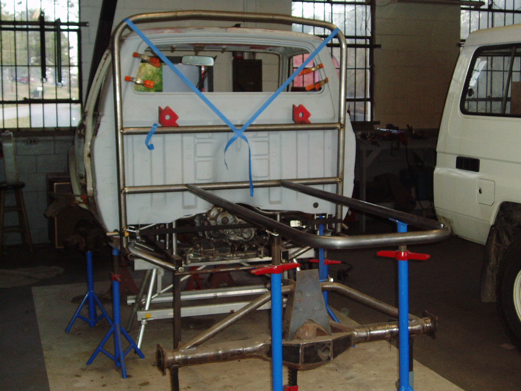

I managed to get a little time today and got the main HOZ hoop bent and in. Not much but a bit. You can see the new stands in the photos, they allow for precise adjustment.

The stands are pretty easy to make. They are made with screw jacks for scaffolding and the tube from scaffold sections. Check your local pawn shops and craigslist, lots of scaffold for sale these days. You can buy new scew jacks for $12.00 a piece. Handy to have for sure and far more finite in adjustment than jack stands.
Either way you can never have enough jack stands and adjustable stands.

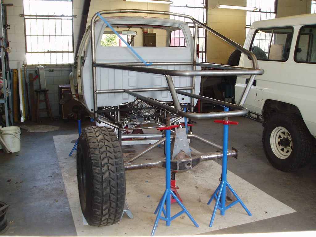

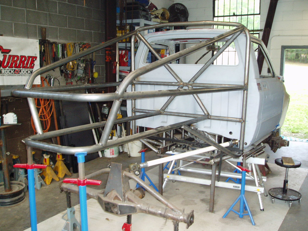

I got to work on the Truggy again this afternoon. The upper hoop is tacked in with the two rear vert tubes. Also got one upper tube in. Starting to feel like a truck again. I gan get a feel for where and how I can hang the rear fenders.
I used a random piece of tube in the shop to use as a shock hoop. The final shock hoop will be taller and the front leg will land on that lower node toward the cab. It will be a mix of 1.75" and 1.50" tube

Thanks Steve. My wife has no issues with builds, I do make a living at it though, makes a difference I am sure.
