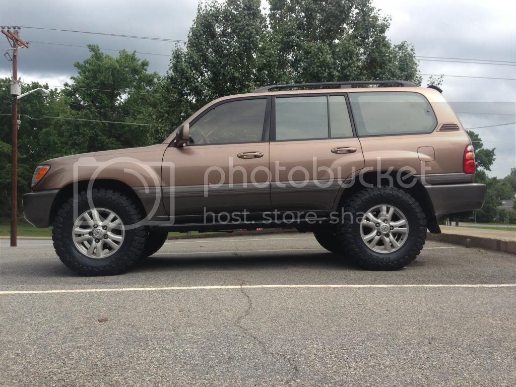

Got Toyo Open Country M/T's mounted up today. 285/75/R18 ~35x11.50
Going to have to knock out the pinch weld mod tonight real quick but other than that at first glance definitely streetable with my current setup. Will be doing a 1"BL this week or next along with 4.88's and lockers.
They feel sized similarly to the Super Swampers on my LX for those of you who remember some of the older threads... ;)

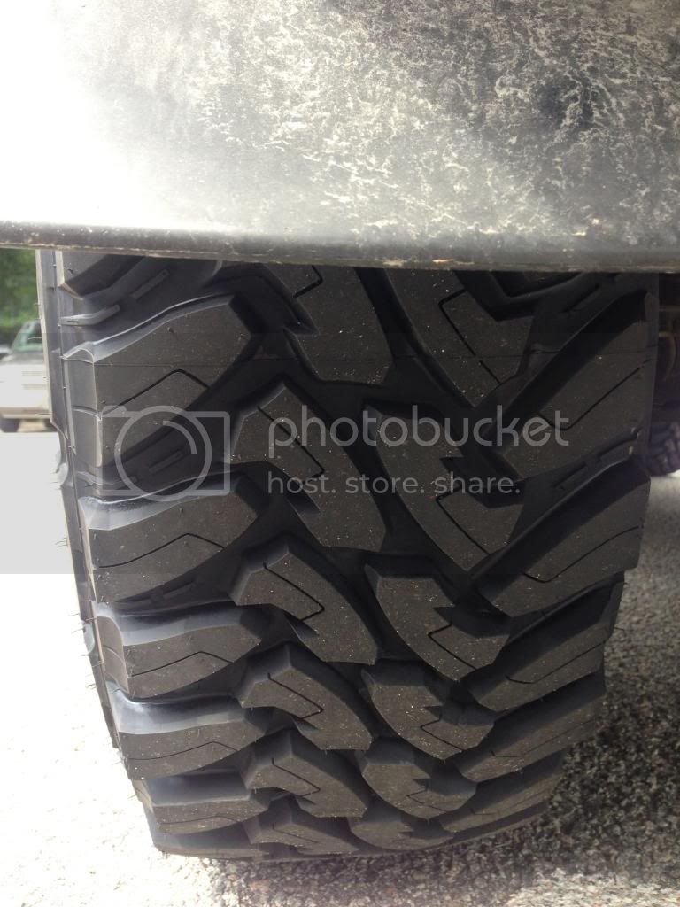

Anyhow search didn't show much on the Toyo OC M/T's like the MTR's in 35 so I thought I would post up a couple sans BL etc before the truck gets a bit more transformed... UCA looks to be a non issue from what I can tell but gotta go do a little flexing I suppose to get a feel for everything. Anyhow, a few pics:

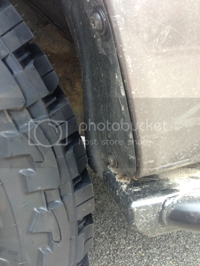

Trimmed back the fender liner. Didn't bang on the pinch weld yet. Going to wait and see where the 1" body lift puts things. I will say this the pinch weld on a 100 is STOUT compared to the thin metal on my Taco I did!

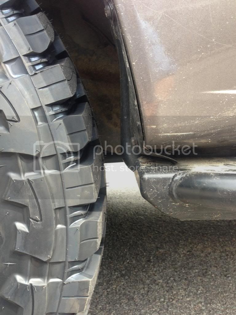

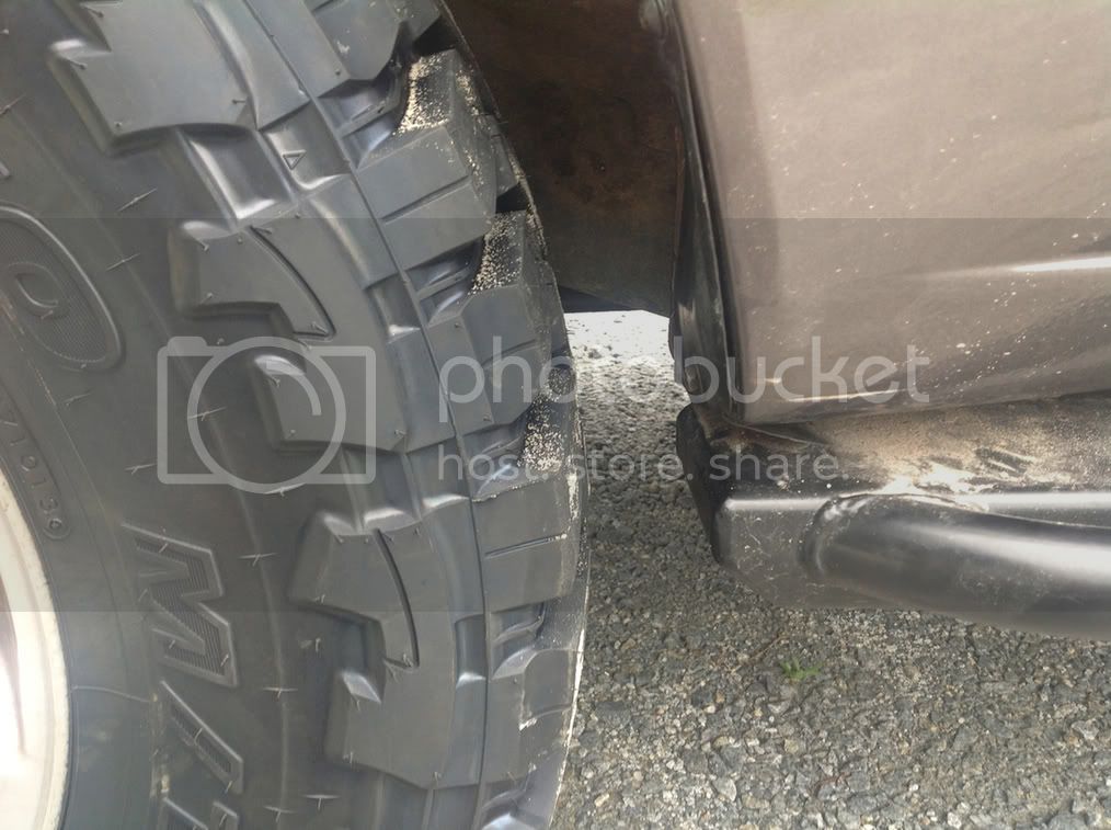

Trimmed the "bulge" in the liner, pinch weld lines up with MT sliders pretty nicely:
