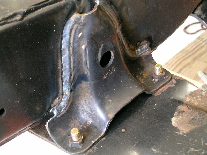

"How do I nut the front hangers when the frame is boxed?"
Just weld them... you are going to do it anyway...

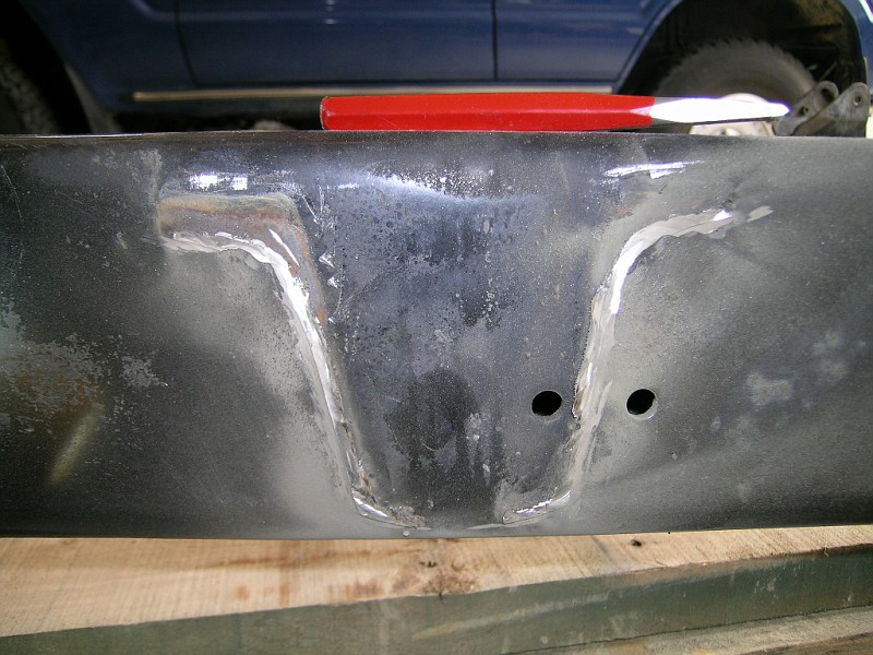

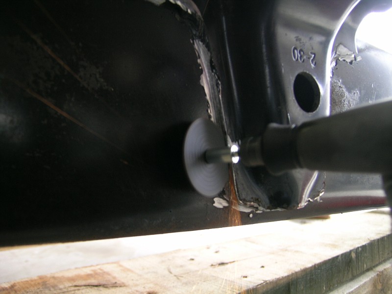

Well finally finished up that pesky job I was on last friday and got laid off. Then got the new Trails and discussed with the wife and kid how we are going to Moab and that unreal Canyonlands National Park when the 60 is done. Weather warmed up so I hit the garage for the first real work time in a while.

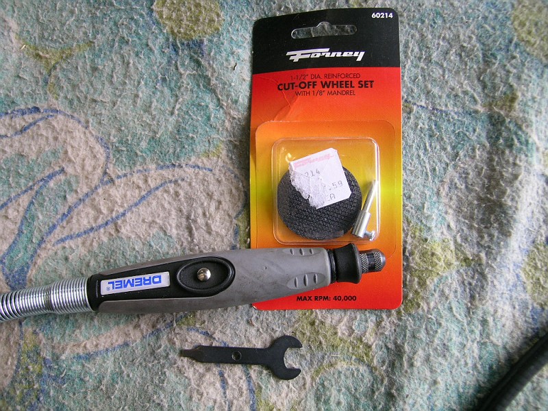

Wound up using my Dremel tool with some great little reinforced cut-off disks from Forney. All went exactly as I hoped it would.:hillbilly:

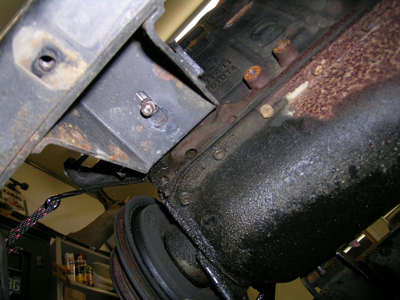

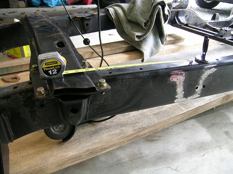

Have to move the trans crossmember forward about 15" or so.

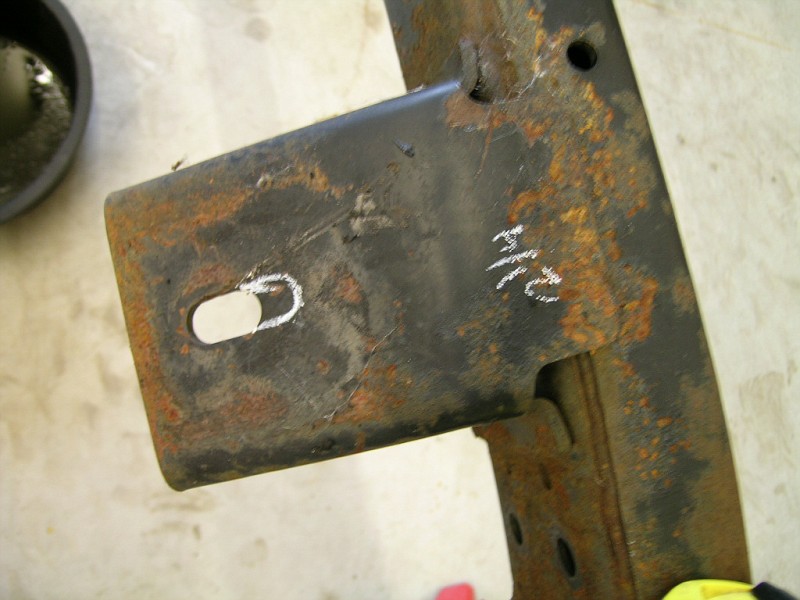

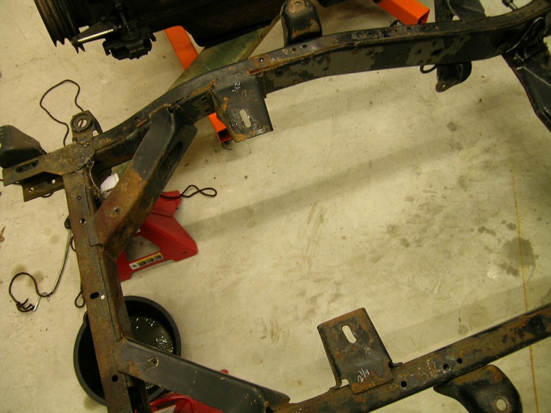

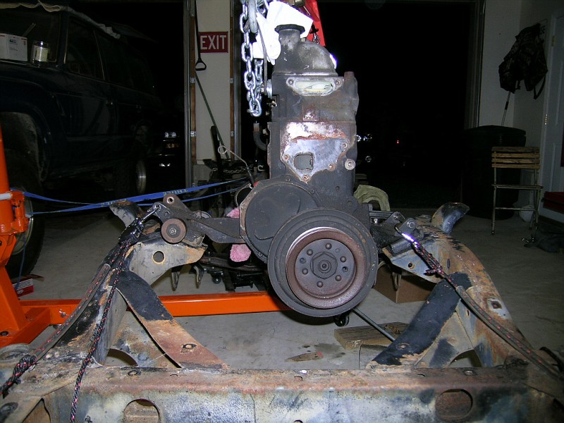

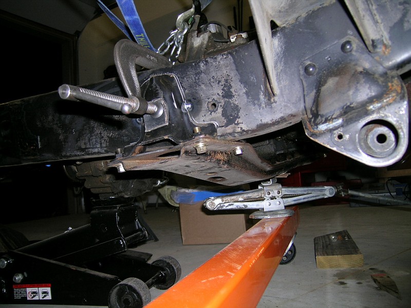

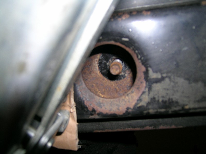

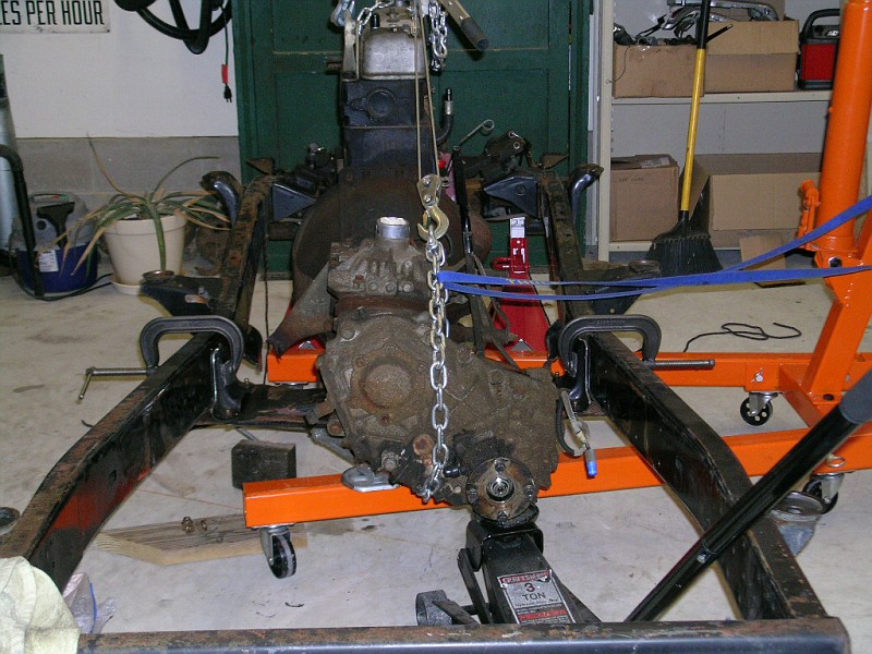

Had to elongate the frame engine mount slots on the FJ62 frame to receive the 2F out of the 60. Anyone forsee a problem with the longness of the holes?
I don't want to have to fill material if I don't have to. I don't imagine the engine would slide to either side once the rubber makes contact and is bolted down.
This will be the last double check before i weld the tranny mount in position as well.
Anyone have any observations of problems please speak up!
Good to see more progress:cheers:
I don't see any problem with the longer holes. They were slotted to begin with. If you're at all concerned though, the weld required to shorten that up is a pretty simple one.

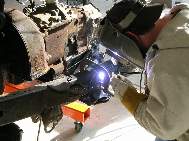

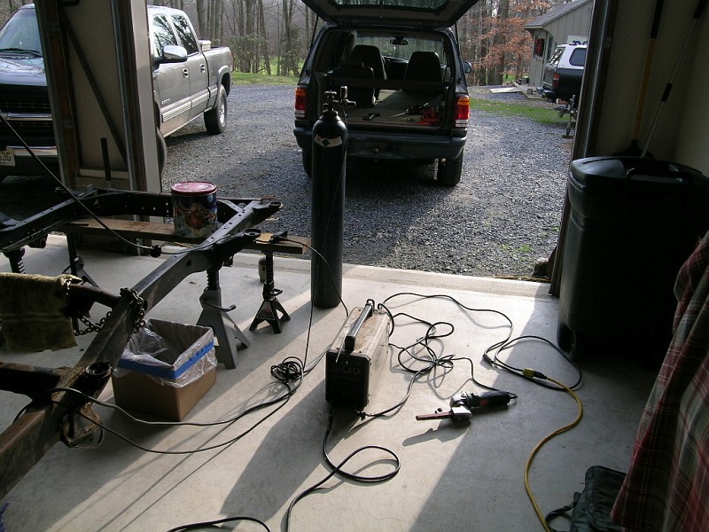

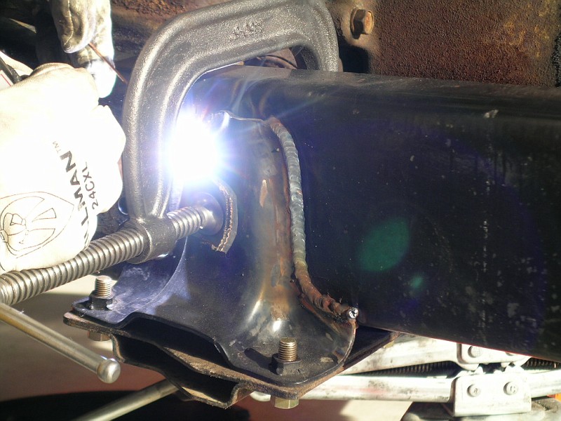

Well after checking and double checking I made the call today to my buddy Jeff who came over within the hour with his small but powerful TIG setup and welded the tranny crossmember home.
What grade are those bolts you used to attach the tranny crossmember?(and where did you get them) I used grade 8 bolts on mine but they are already showing surface rust and I couldn't find anything other than the regular black grade 8s :frown: , or is this rust not a reason for concern since it's just superficial?
Great project btw, can't wait to see it finished!
Those welds are amazing.

Not sure what grade bolts they are. They came in a box I picked up of metric plated bolts. They fit and weren't rusty so I used them temporarily. I will probably just call Cruiser Dan and get the right bolts.
