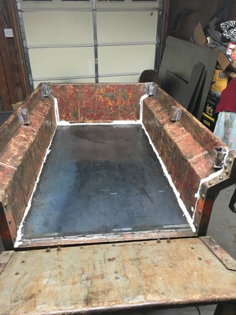

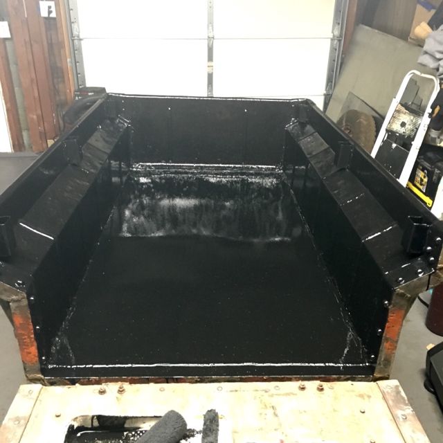

First I had some rot in the floor and was just planning on replacing the rear portion but as I got into it more I realized the whole thing was pretty shot.I used a sheet of 16 gauge steel for the new floor. Welded in, Sealed and the POR-15'd

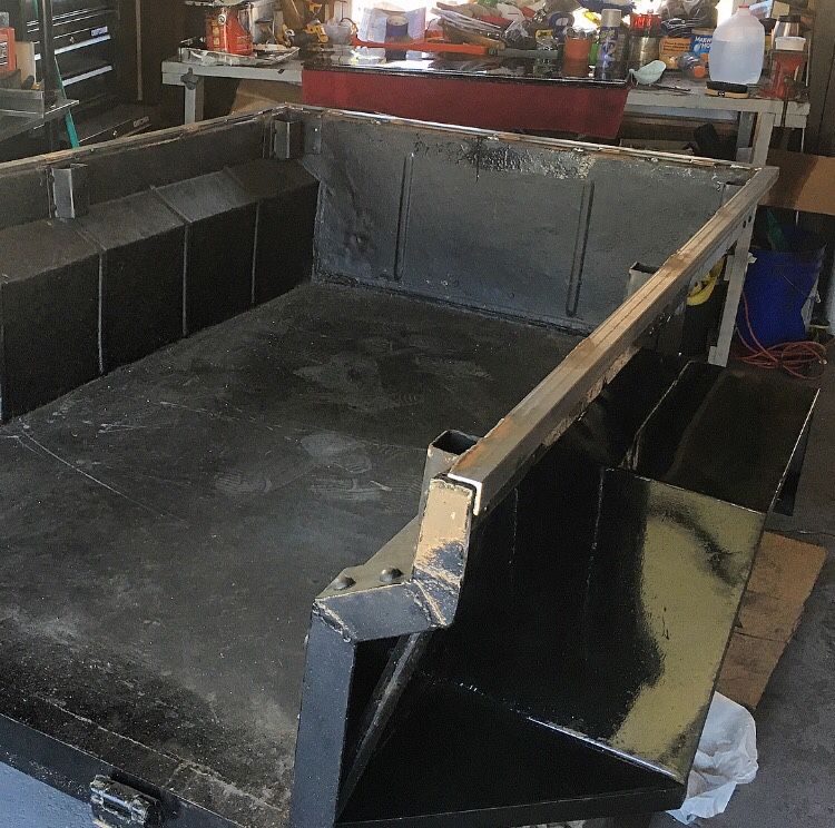

Then I moved on to Fabbing up some new fenders. I wasn't a fan of the round style fenders and always liked the M416 style fenders so I started in that direction. But I wanted them to extend to each end of the tub for possible use in the future of mounting stuff to them, Propane,roto pax etc.
One of the things I that I always liked about the Bantam's over the M416 is the fact that they have a tailgate. Great for easy loading/unloading gear and the tubs more accessible if you have a lid on top (which was my plan) But unfortunately the Original tailgate was in pretty rough shape ( 70+ years isn't to shabby) So that was next.

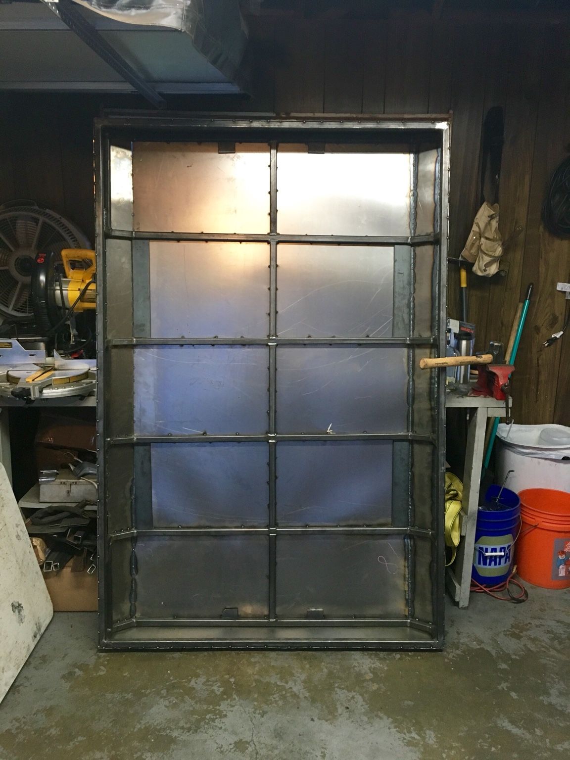

Next I wanted to build a nice lid so everything could be closed up nice and I could add a rack for a RTT. After looking at it for a bit the round edges of the tub weren't going to be the best for a new lid to sit flush on so I added some angle iron to make a nice flat surface and it also ended up giving it a nice clean look.
On to the Lid!

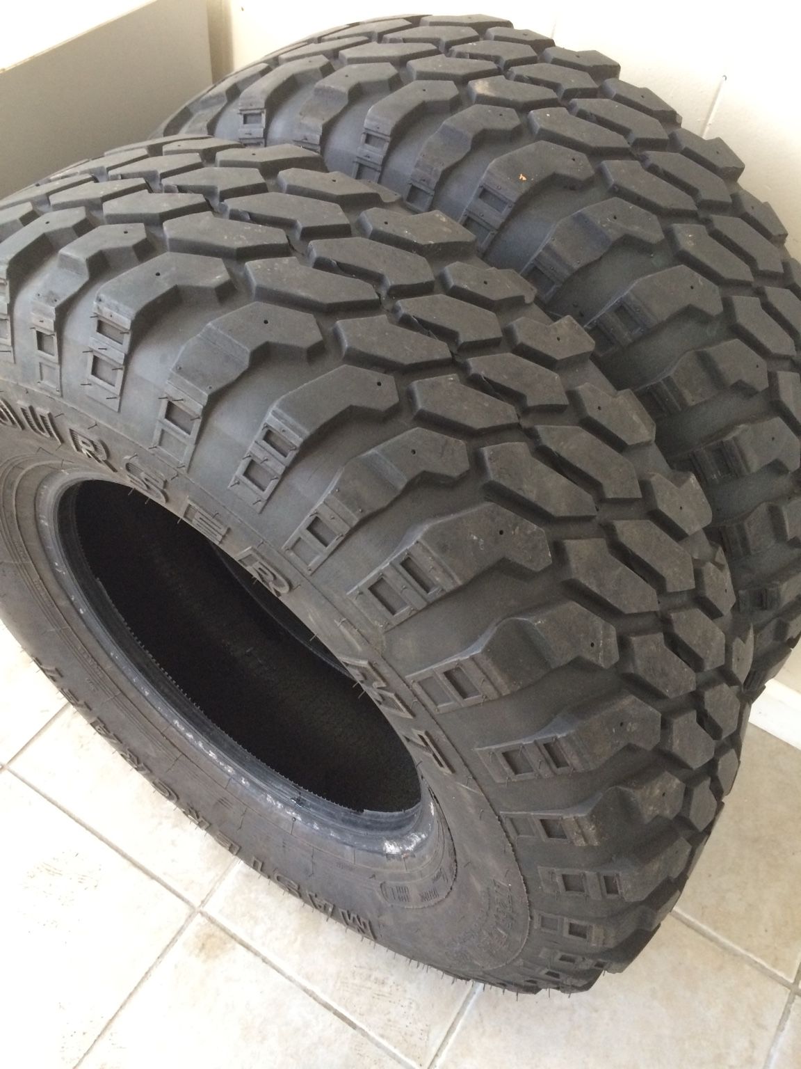

Also scored these off craigslist for $50

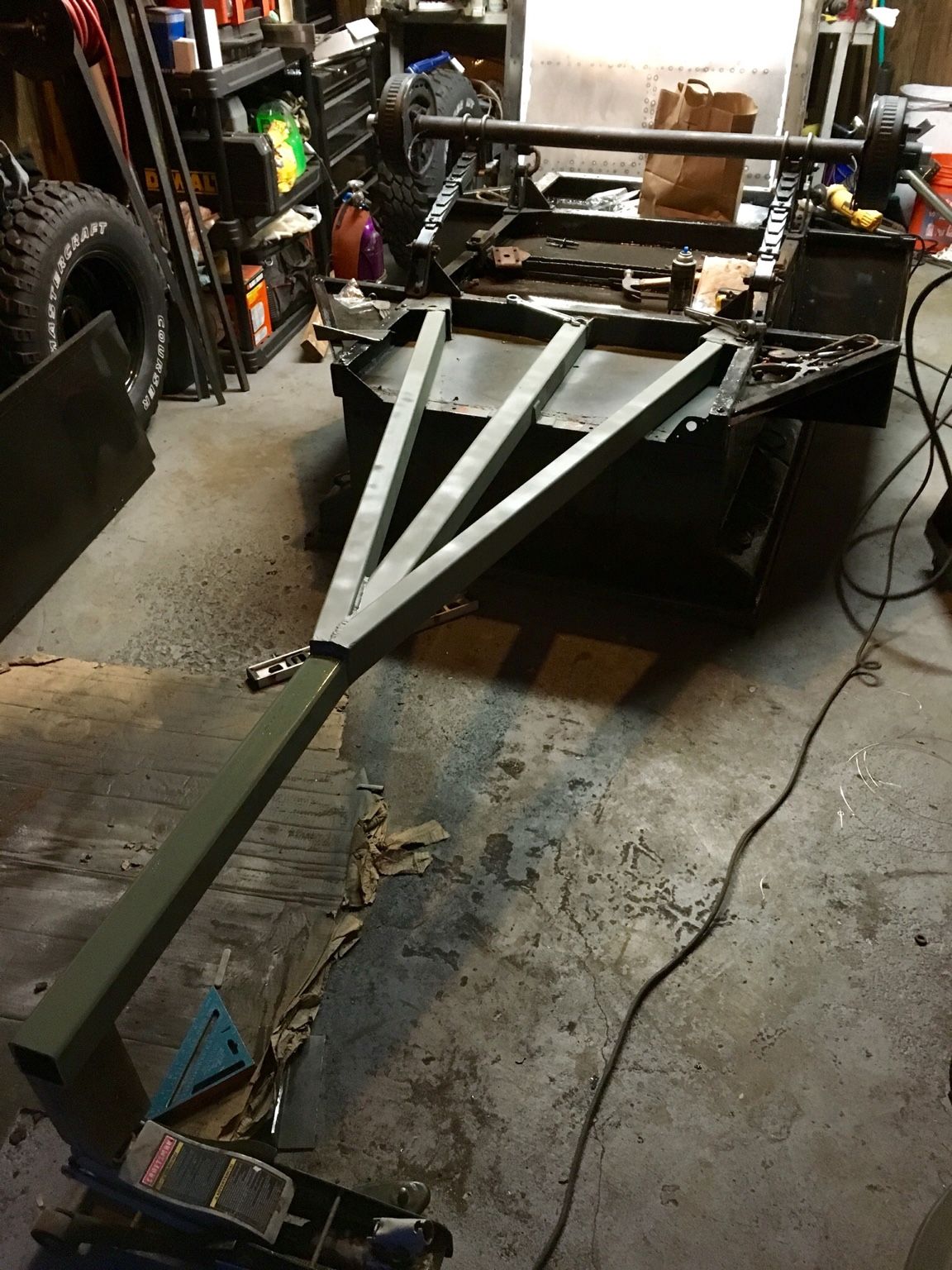

Next I wanted to re do and extend the tongue. My original plan was to match it to the same wheel base as my 4runner but I fudged something up and it ended up being a bit to long. In the end I shortened it and now it's a matched length.

All primed up.

Good job on the trailer. Question on the tongue length, how did you figure it? I'm doing the same right now and looking for some input. Are you happy with the length?
I second this question. I just finished up the tongue on mine a week ago and have about 37'' from the front of the trailer to the center of the lunette. This doesn't factor in the distance from center of lunette to receiver.
Thanks. So on the tongue length I went off a buddies set up that he was running. He has a 08 FJ cruiser and a older British military style trailer similar to these style trailers but all aluminum (pretty cool) Anyways his tongue length is set so that his tire length from trailer wheel to rear wheel on his FJ is the same length as his FJ wheelbase. According to him this would give you the best results when towing. I'm sure others on here can give you a better more in depth answer but so far its worked great for me. Yes I've been happy with the length and its towed great. I need to add a spare tire ( probably to the tongue ) and a tongue as well if I can figure out how to fit both.
Nice build. I want to build a similar lid for my M101. What gauge sheet metal and what size tubing ( 1" X 1/8" ? ) did you use?
Thanks, Jim
I've got an old book on trailer building " Trailers... How to design and build by M.M. Smith " now it takes a mech. engineer to do the calculations and I think it's written more for larger type trailers, but basically it comes down to load and what type material for the tongue is used. Square tubing is great for this and our loads aren't much.
My concerns were for driving on some trails making sharp turns where the longer tongue would be at a disadvantage, but if needed to turn around tight (jackknife) it you don't want the vehicle hitting the trailer body either. I backed my 55 up to the tongue at a 90 degree and took a measurement, for me it's @ 51 inches from the trailer body to center of lunette and call it good.
Happy to hear yours is working good.
For what its worth I made the tongue of the trailer long enough to clear the rear door while it was open on the FJ while the trailer is still attached. This also made it long enough to be able to jack knife the trailer 90 degrees for those tight turn arounds or setting up camp. The only downfall to this is that I had to run 44 inch safety chains.
Thanks, Jim
Thanks, Yeah a popular style lid for these kinds of trailers. I have gas struts on the inside to help with the weight when opening it and latches on the out side so I can lock it if I want.
Geez I can't remember exactly thickness and tubing but I want to say the sheets were probably 18-20 gauge and for the tube that sounds about right 1" for sure and you'd be good with 1/8" thickness especially once every things burned in.
Yes I believe the rule of thumb is you need a good balanced weight but you can't be to light in the front or trailer can respond poorly and get squirrelly.(on road)
For off road yes I agree you really need to find the sweet spot for what works best for you and your application id say both the type of off roading or tail riding your doing and the way you have your trailer set up, gear, weight etc.
