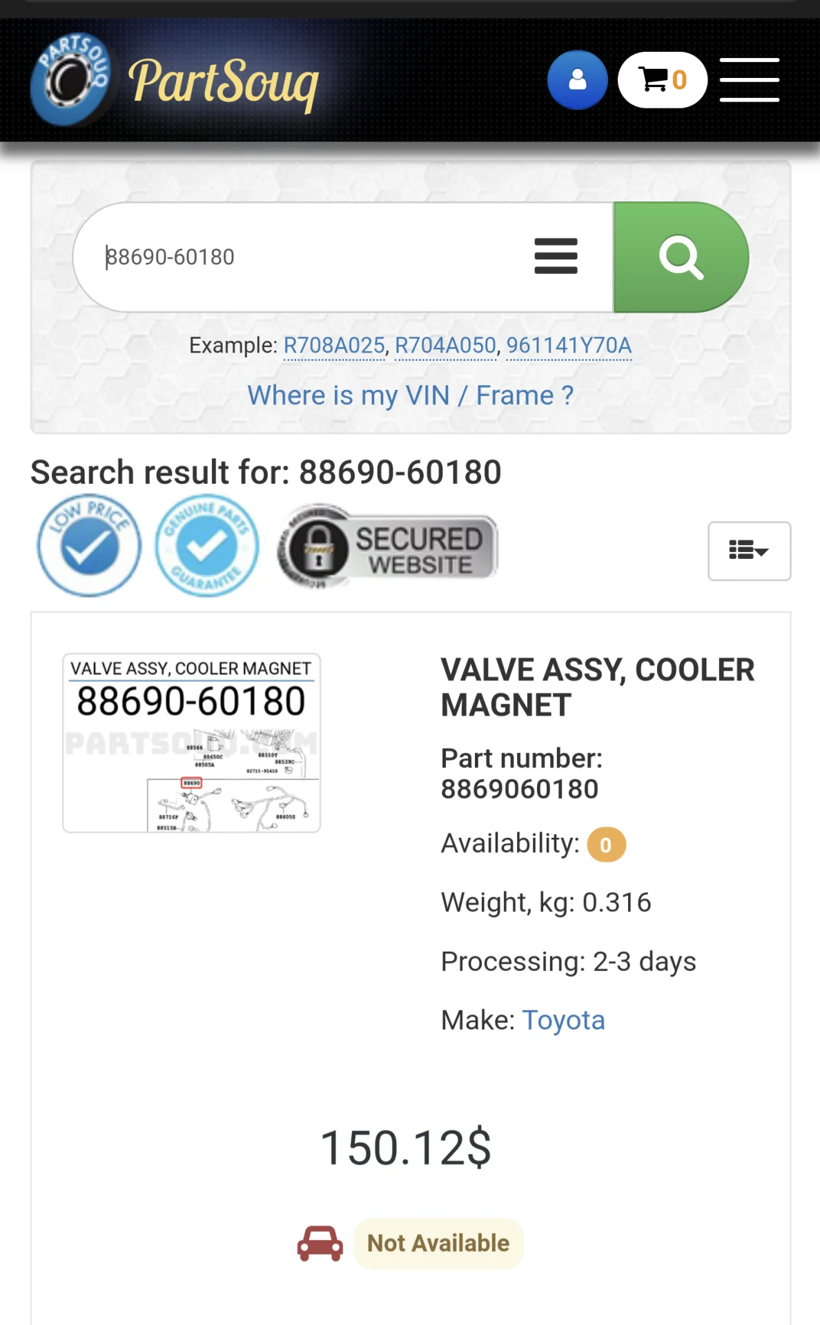

What about taking your VIN and looking it up on part-souq.com? You might be able to find the correct PN that way.
A lot of the time even on partsouq they only list partial numbers, but when you click the partial PN it will give you the whole PN.
Due to it being a Japanese vehicle, i dont have a Vin, and i can’t get partsouq to work off of my frame number.

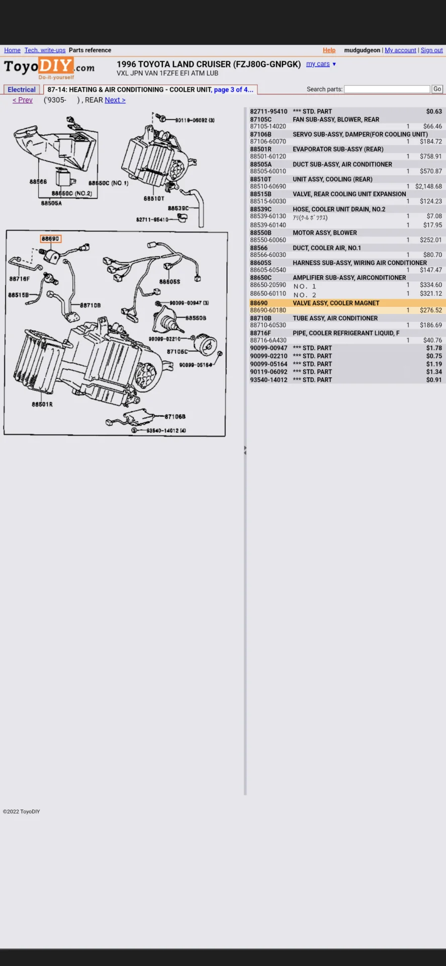

May be a superseded part?
Cross reference on Toyodiy doesn't show that part number used in any other model
Yeah, thats the same part number i just came to the other day. Now to track it down. Either that, or buy the front one and splice the old connection onto it.
Considering it seems to be identical to the one in the front other than the connection, shouldnt be anything crazy.
