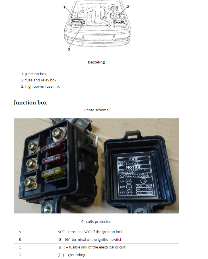

I am currently trying to troubleshoot random engine stalls and I think I have narrowed it down to the electrical system. I am trying to figure out the purpose of the "Junction Box" and how that relates to the "fusible link" wiring as I am sure the wiring diagram I have is not quite exact (there is no junction box in my manual). Does anyone know what this does? and how it relates to the FL? This page exactly reflects the arrangement of my 80 but my repair manual does not seem to have the same components:
View attachment 3568254View attachment 3568258
That image you have of the "junction box" is a JDM auxiliary fuse box in the engine bay for adding accessories. Shouldn't cause stalling, but I defer to an electrical guru.
The fusible link should be essentially the first pigtail/bunch of wires coming off the positive battery terminal. There might be a "junction box" that joins the separate fusible links (slow burn wire) to the main wire coming off the battery.
