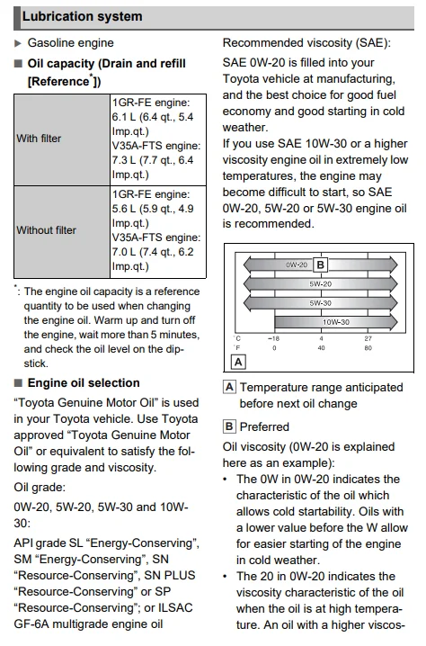

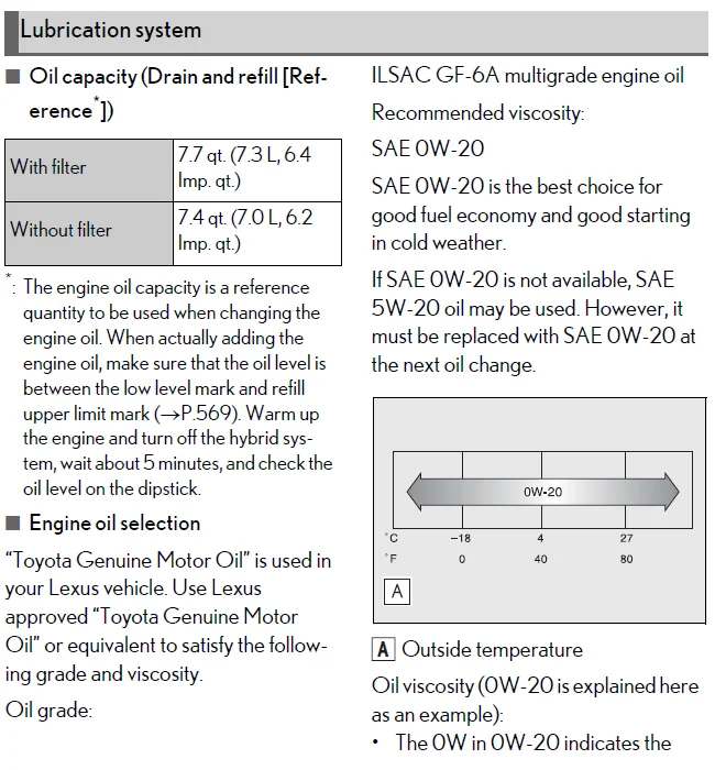

Perhaps let's use this as an opportunity to discuss oil weights. GCC LC300s have a wide range of allowable oil weights, including 5w-30 which we may recognize from the 100 series:
GCC:
And in Australia (LX600 Petrol):
The USA owner's manual is more limited in "allowable oil weights:"
Well 5-30 or 5-20 it will be, thanks for the information!! And I just used my free complementary service at lexus so no loss on my part. Maybe drop it at 3,000 and just do the oil.

Its crazy they don’t give us an option here. MPG regs I guess, need that .X of an mpg to meet CAFE standards.
Good news is 0-20 is allowed in those other markets so I am probably fine for now as I don’t have any issues, yet.
