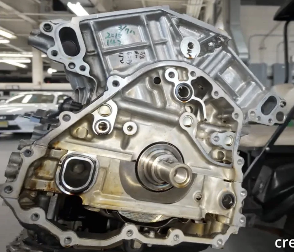

Here's what appears to be a new short block in front of an LX600:

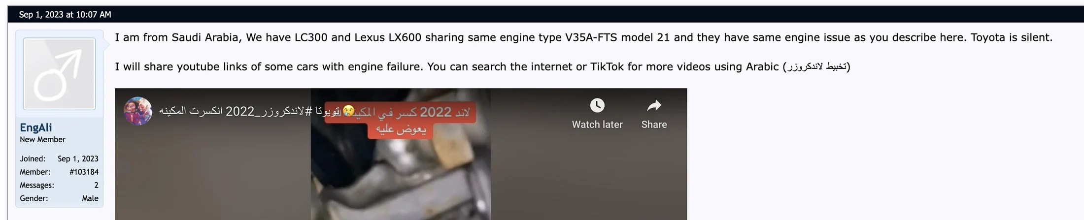

I would take most of Arab LC300 repair videos with huge grain of salt.
- All toyota deals in the GCC region offer a 3 years engine/ transmission warranty. Hence, you wouldn't typically see engines being taken apart someone's backyard or an amateur garage unless the OEM has rejected the warranty claim due to user error. You may argue that car dealers are greedy (which is true) but here we are talking about a Factory OEM warranty for a new car.
- LCs are probably the most popular SUV in the region (if not the most popular car). Hence, LC300 introduction was huge and it attracted massive attention. Hence, when broken LC300 started it show up, it quickly went viral on social media. Garage owners saw this as a massive "billboard" opportunity which is fine, but unfortunately alot of them were purely marketing driven and misled people in many different ways (e.g what is tbe root cause/ why this was rejected by OEM) which to be honest is an important context.
-the first video (engine disassembly) is a genuine and reliable source. The guy recording it is an authorised Toyota specialist working at a toyota dealership in Saudi Arabia. This guy has been a great asset as he document step by step OEM official guidelines ( which you see in some of his videos). In the first video, he doesn't really say the root cause, it's more like a reflection video of how the engine is put together. He then post a follow up video regarding the root cause and guess what.. a toyota Yaris oil filter was installed which caused the engine to jack up!. It appears that a lot of toyota oil filters have a compatible thread with V35A and hence when do an oil change at a rocky service shop, this is what you get. He then argue that even though they look the same, the oil flow in these units are technically different.

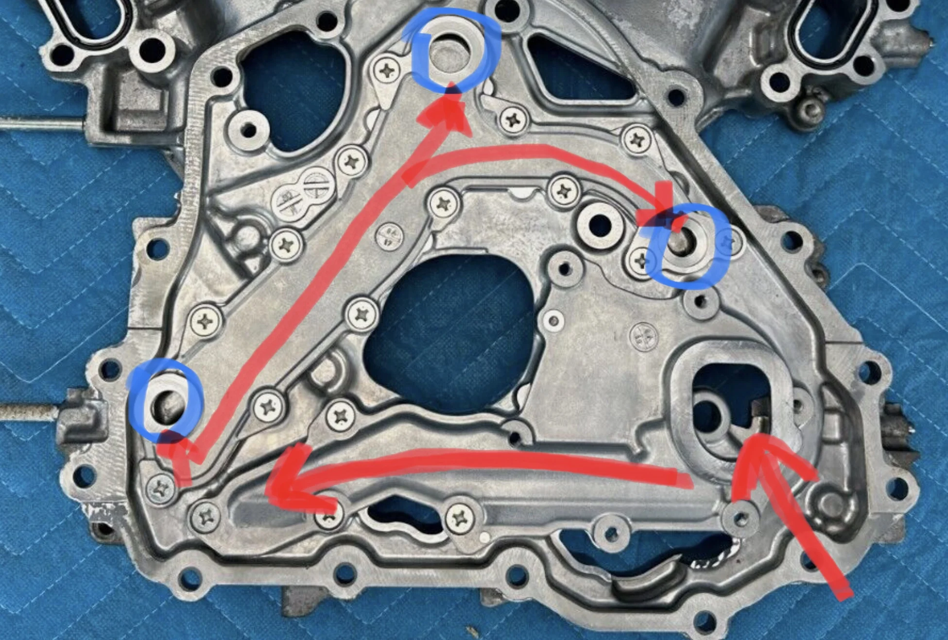

This is a hypothesis based on high performance engine oil feed systems and the oil related main and rod bearing failures seen on another Toyota engine, the FA series (GR86/BRZ). A high performance engine with a properly designed oil system should always feed the main and rod bearings first. This is called priority main oiling. The mains and rods see the most load and produce the most heat, thus, they need more pressure and flow volume than any other part of the engine, they take priority. Interruptions in flow here, even briefly, and the results can be devastating, wiping out a bearing(s) gradually, or quickly if the drop off is long enough.
The FA engine in the GR86 is seeing similar failures to the V35A. As far as I have read, these failures have been determined to be partially caused by a non-priority oiling system. The FA engine feeds the left cylinder head first, then the main oil gallery. So, when the car sees high performance/high g-forces, the sloshing oil in the pan can interrupt oil pickup, and oil feed to the pump is briefly reduced. The left head, being first in line, takes its share of oil, and with flow dropping off, the main gallery, second in line, does’t receive what is required. Boom.
The V35A-FTS is quite similar to the FA in that it has a non priority oil feed. Looking at this V35A timing cover from behind, the oil path and feed order is easily seen. Starting at the lower right, oil feeds into the oil pump. It then travels across the lower cover where it feeds out to, and then back in from the oil filter. The blue circles show the galleries being fed. First in line is the gallery for the left bank oil cooling jets, and possibly the turbocharger (I need to study the system more). Then, second, up top, is the main gallery, which feeds the crank/rods and the up to the heads. Last, a third gallery for right side jets and turbo.
Does the V35A have an issue here? Maybe those oil jets crack open at just the wrong wrong time? The above is just a guess.
