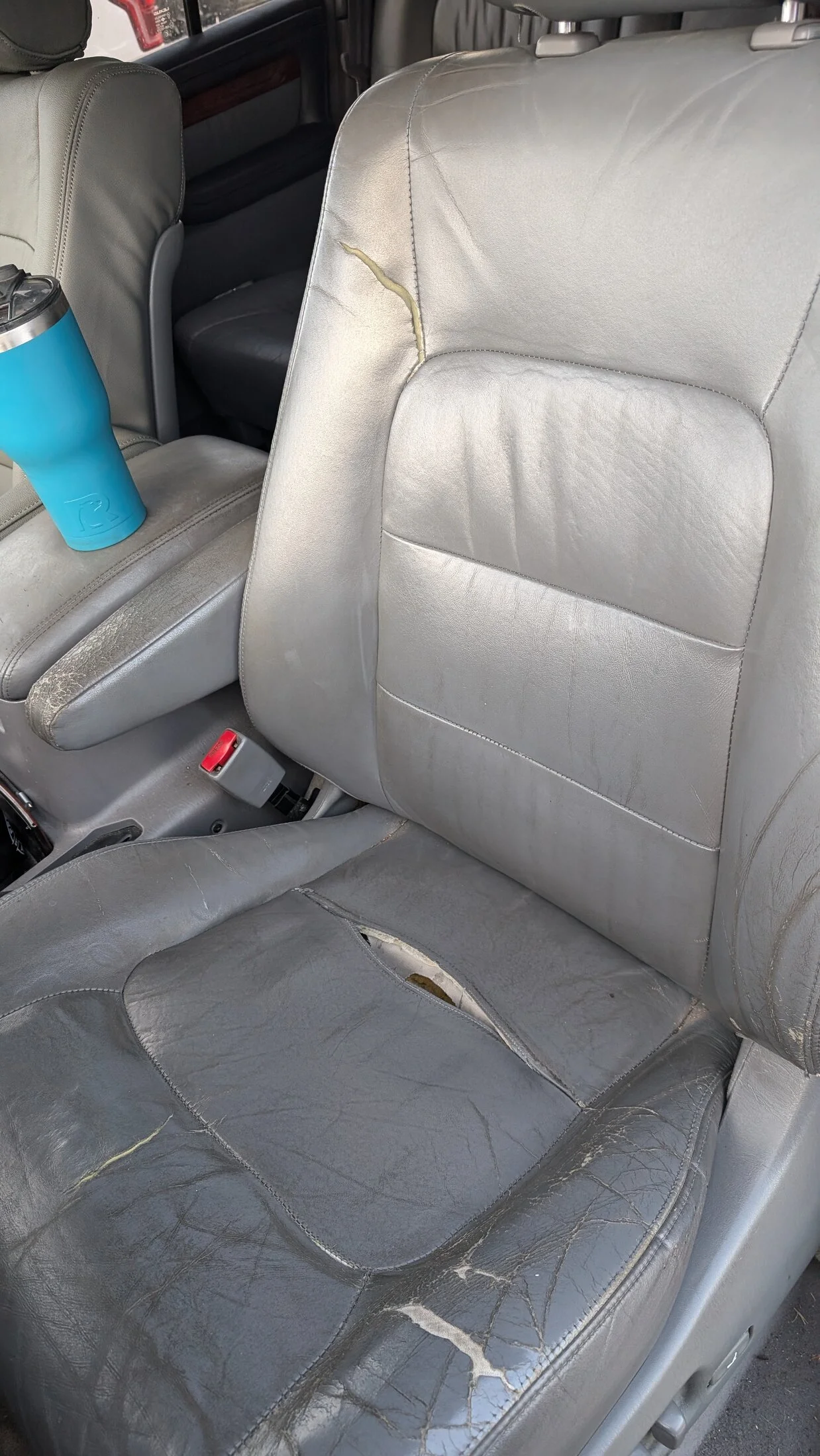

I'm also in the process of recovering my front seats with LSeat covers. Passenger side is done, planning to tackle the driver's side over the Independence Day weekend.
Driver's side before recover, and passenger side after a week or so installed (cover shrunk a bit with heat greatly improving the fit since installed)
