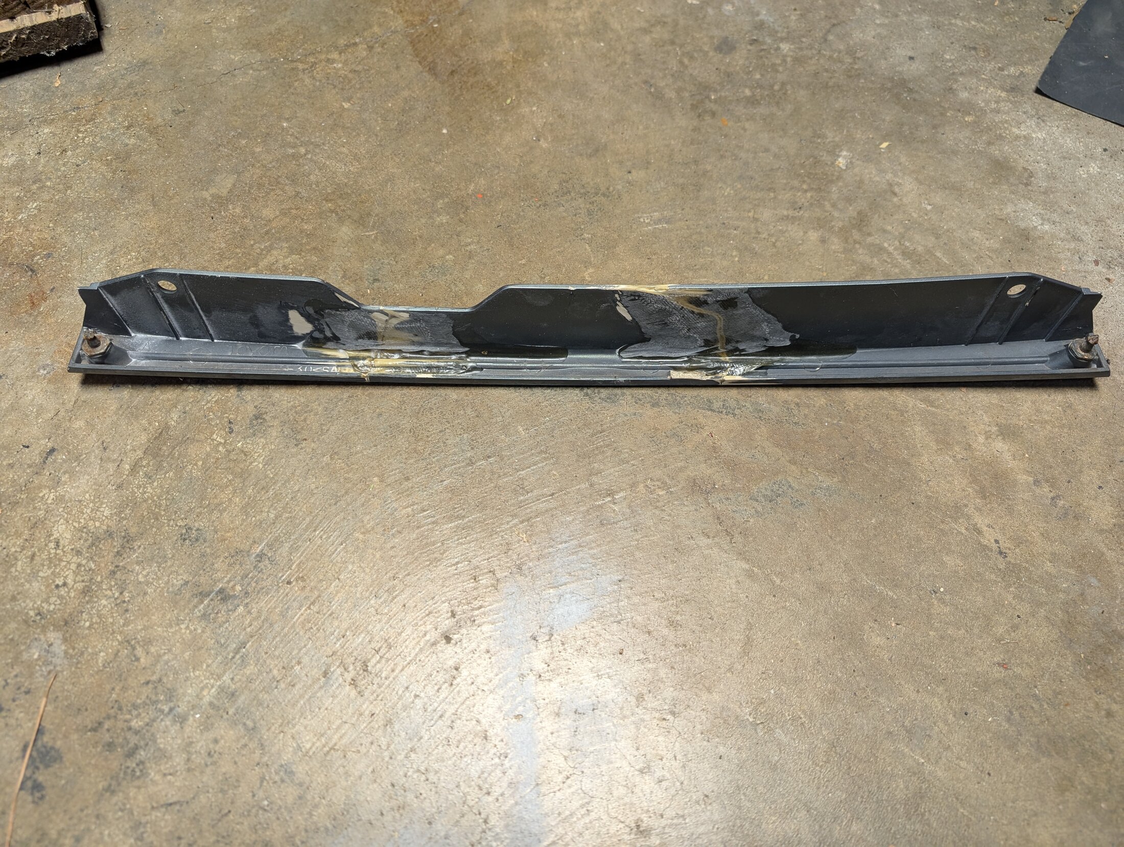

I've been working on getting the trim piece that sits under the grille repaired (broken into 3 pieces), I'll try and get some pics of that tonight. Also finally got in the UCA76 color code paint for the bumpers (finally), so hopefully I'll be able to get those painted pretty soon.
