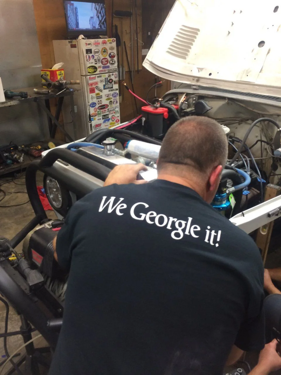

We put a ton of hours in on the rig this weekend. Not sure we took a single pic. Too busy working or drinking beer!

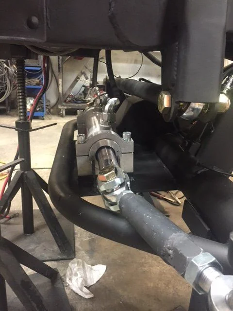

full hydro ram installed and plumbed

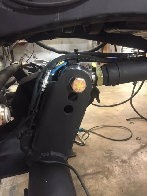

brake, axle vent, and arb lines routed from axle to the front upper link

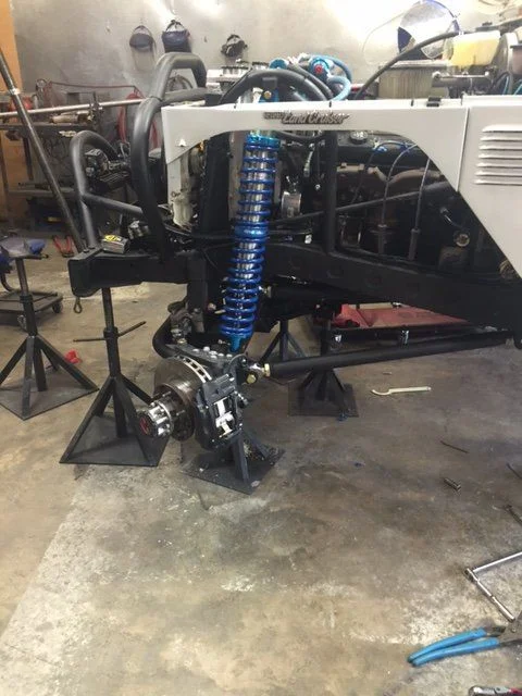

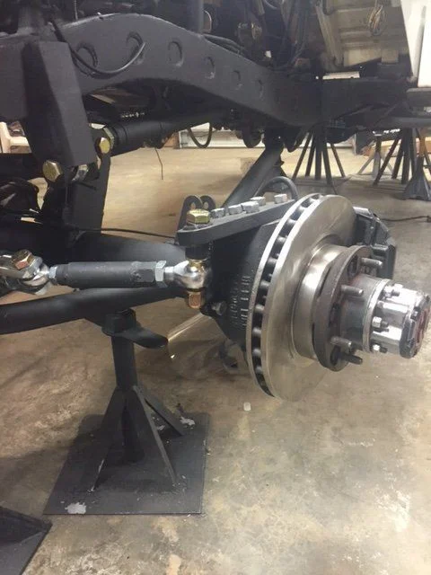

knuckles built and connected to ram

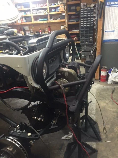

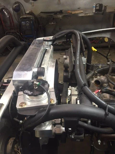

winch and hoop reinstalled. power steering cooler right behind the bid. top of shock hoops with mounts for shock reservoirs
crossmember between shock hoops with reservoir mounts. that is a power steering line running across the crossmember. New 4 core radiator and fan shroud. Power steering reservoir.

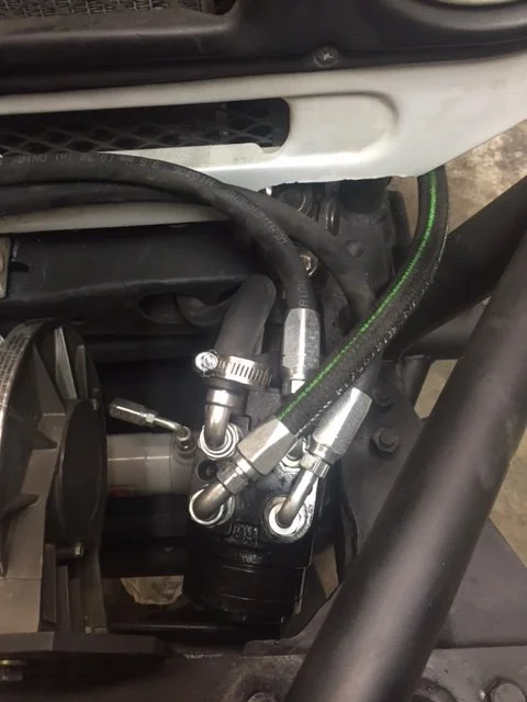

plumbing at the steering orbital

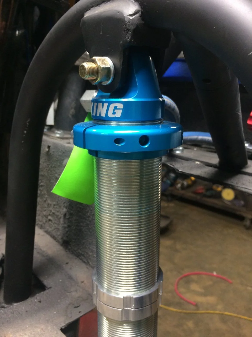

rear shock reservoir mount and shock hoop and mount

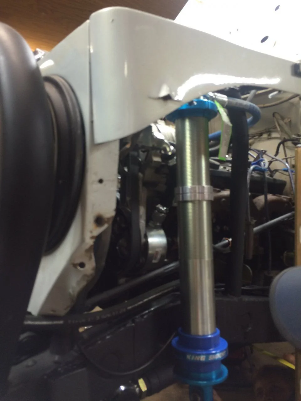

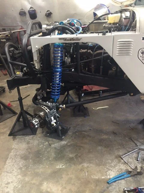

new springs installed 200/250 in the front and 150/200 in the rear. sitting real close to ride height; however, they will need to adjusted more once the truck is fully back together. shock reservoirs are mounted

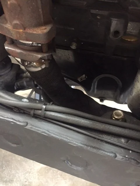

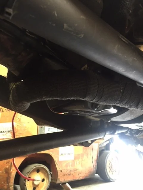

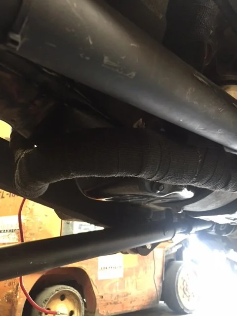

here are a few pics of the exhaust and front drive shaft
Tomorrow I'll be finishing up the rear exhaust and working on finishing up any loose ends. Hopefully Monday we will be able to fire her up!
