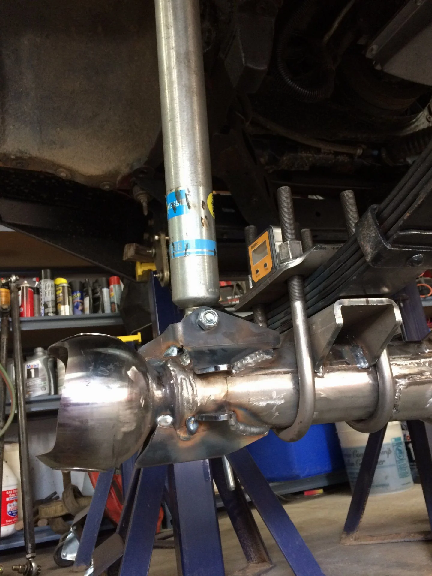

Here is some pictures of the Trac bar. I need to go grab some more steel to add some brace's in between. Ruffstuff kit by the way, BEEFY!

If you mentioned it, I apologize, but what if anything did you do for housing warpage? I want to do a cut & turn and other mods some day, but worry about the heat. I admire your jump in and get at it attitude.
Yea i am hoping we didn't warp anything. That's a question for somebody else, like Georg @orangefj45 or Andy @Cruiserdrew they would know.

Welding the perches and extra braces to the housing won't warp it as long as it's done right.
