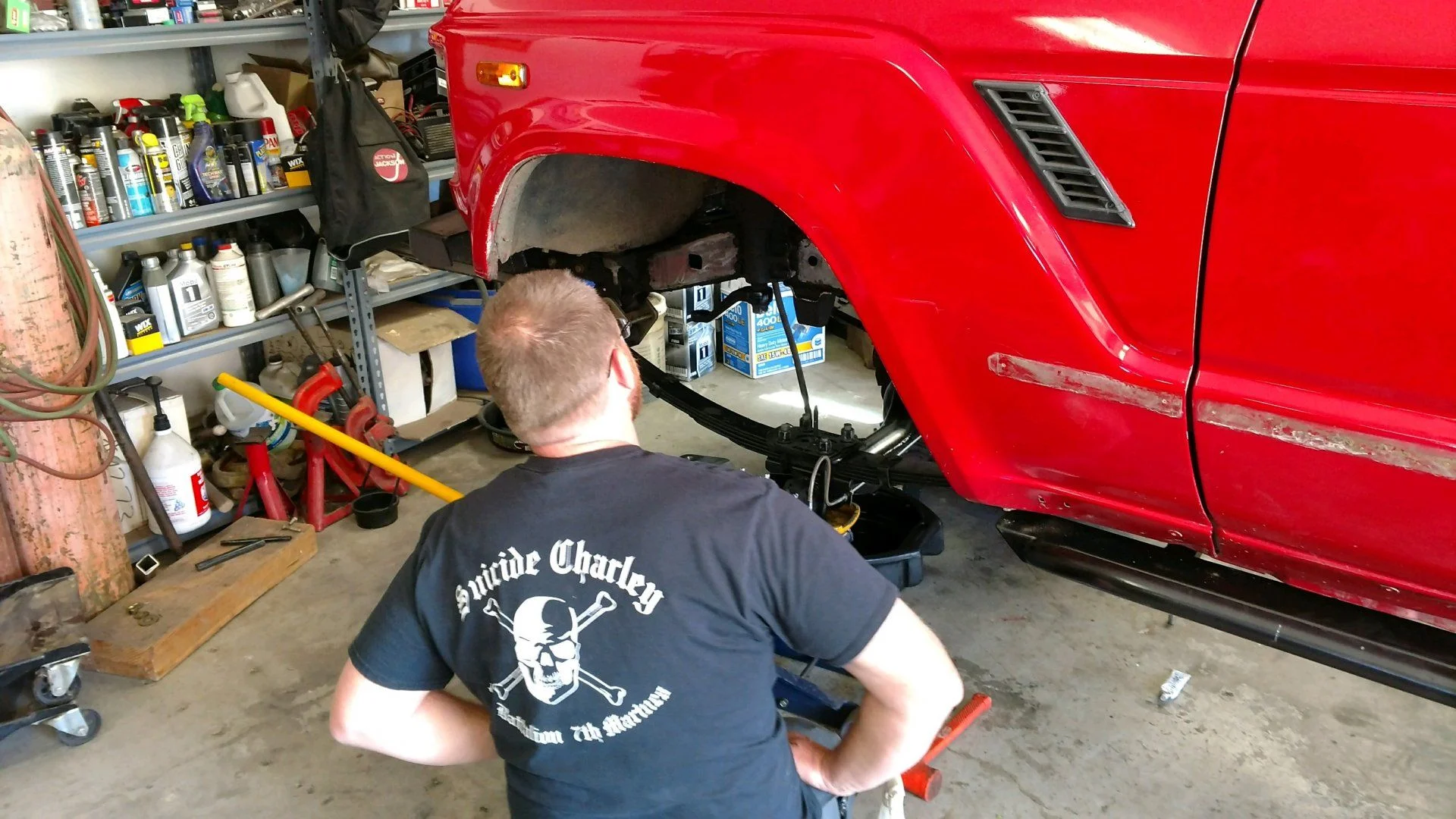

This are going to get serious this weekend. Last night I stopped by and Bob was getting the sliders on, checking for clearance for the fuel lines, We started mocking up and getting the on board air compressor mounted. Moved a few things and found a good spot.

Some updates on No Turning Back. Saturday the whole Family got involved. Im sure Bob can give you all more details on the stuff hes using for sound proofing and mat. With the compressor installed we started mocking up the placement for the air block which will run the lockers, shut off switch, tank and air gauge inside. Marlin drag link tie rod and steering arm installed. interior came out Fantastic. Today he was installing the seats and I was working on the e brake. The rig is getting close its all the little things now that are so time consuming LOL
We got a lot done this weekend, installed the Trail Tailor vinyl kit. Got the seats installed. Air system 80% done. Figured out the parking brake. Rattle caned the front fender, it looks pretty good. Lol
