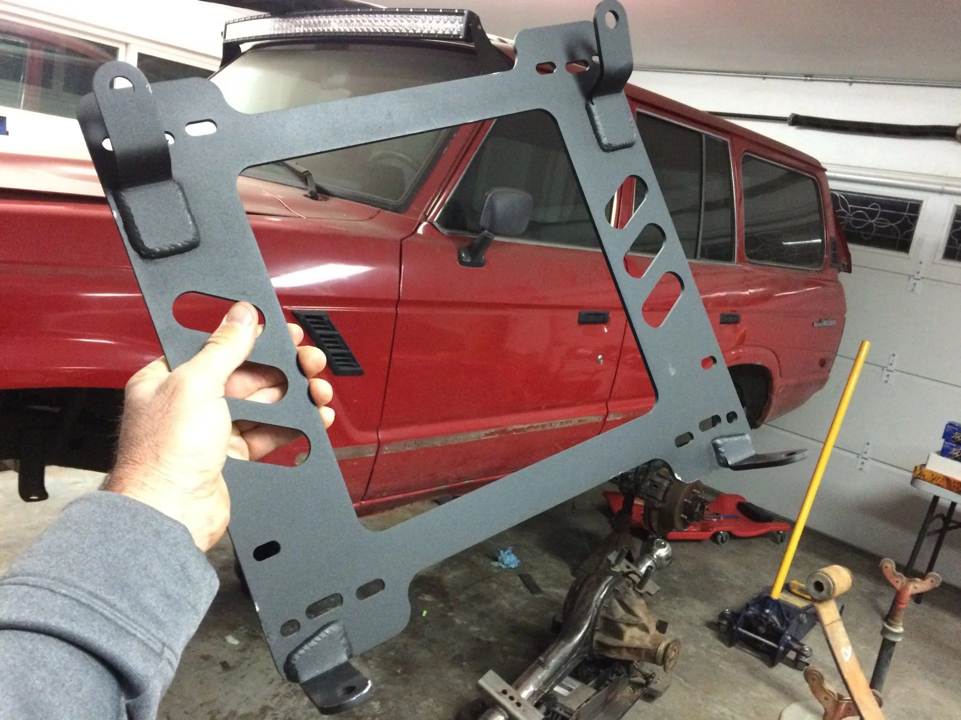

Our parts table.

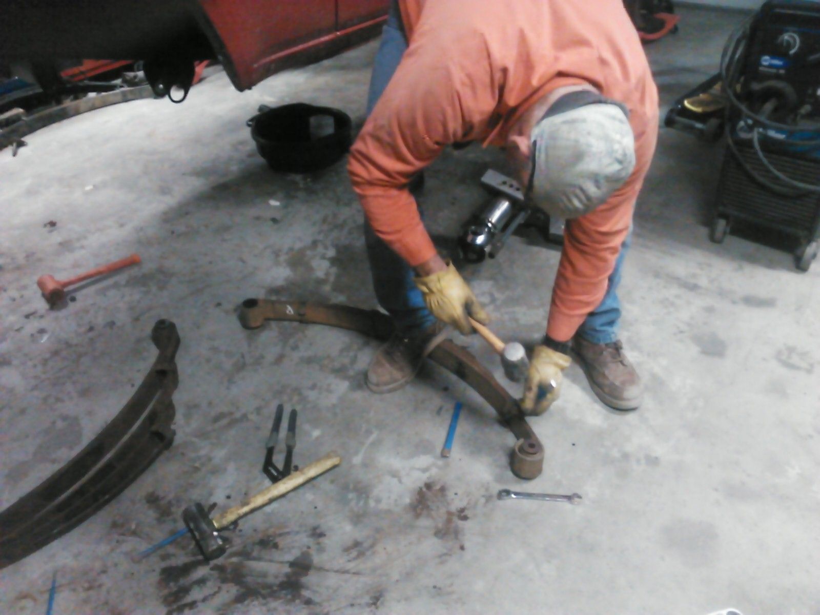

How did you get the old ones out? It's not easy with the Chevy springs!
Lots of good stuff in that picture!
We pressed out the rubber and beat out the metal sleeve with a punch. Yea tons of fun! Lol
